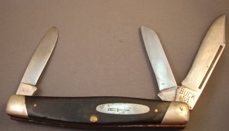

I got this one today and have not had a chance to clean it yet. It is not like my other 301 in that it has a flat rivet rather than a domed rivet and it has small scale pins. It's a little short in the main blade and has gained a bit of a recurve but nice for it's age.

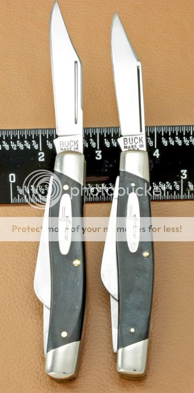

Last Schrade made 301 on left, One of the first two Cami. made 301s on right( 1971 to 1974). 26 years ago. You have to see the reverse of the tang to look for model number stamp or no model number stamp to know versions and variations.

Again the knife that started this thread, has had its blade replaced or the factory had the new blades ready and they finished up a production run using the older scale bodies. The pivot pins look clean so if it was a replacement it was done well (likely Buck).
I will guess...........50/50 either or.....can't tell if its a factory mix or later replacement. Call it what you want to and no one can say different.
300Bucks
Knowing Buck's tendency to "use up" as much parts as they can, that was my first thought when I saw that picture. The overall wear on the knife seems to be fairly even on all three blades, but if a blade replacement was done early in it's life, that would account for that also.
From a 301 collector's standpoint, that's an interesting knife!!!

I was joking about being almost 5 years older from the original thread. DM is correct. All models - 301, 303, 309 and 305 are made in Idaho, USA. Currently, all other 300 models (other than those listed), especially those found in discount stores, are imported. The knife pictured was actually a Camillus contract Buck, with a replaced blade.
