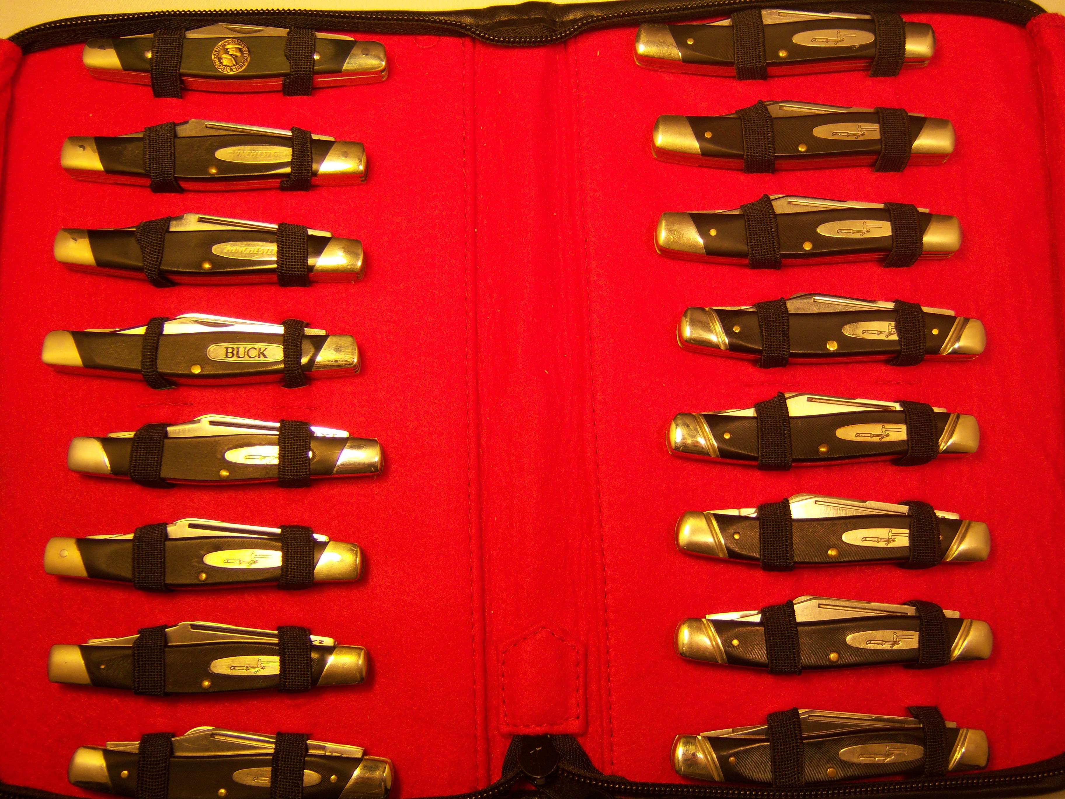

The left side and the first on the bottom of this case are all Schrade contract knives. From there they are Camillus contracted on up until you get to the newer knives at the top. So in '66 when it all started they were Black with the knife, hammer, bolt shield.

Jack, Thanks for the nice photos. Notice the top knife utilizes 2 spacer/lock bar. Whereas, the Buck model has 3, one for each blade. Thus, the sheepsfoot blade is not canted to fit the well. DM
