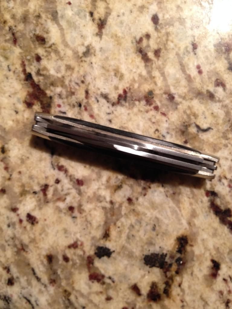

I did get a buck 303 with 420HC. However, this one had liners that were BENT! and I strongly believe that the main blade wasn't heat treated properly. This is based on the fact that I can make my other pocket knives shaving sharp but this main blade is smooshy while the sheepsfoot blade is a lot better. I obviously first thought it was me.. not buck.. but after 3 hours trying to sharpen the thing it just won't take a good edge.

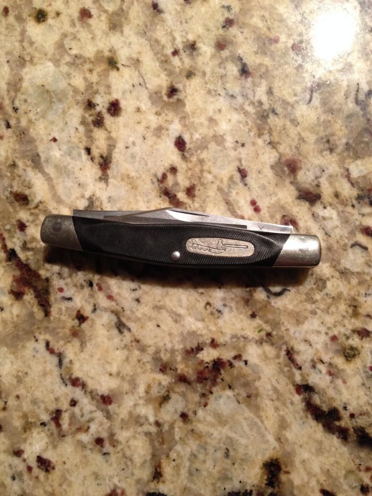

Here are a few pictures of the dud I got from Buck as a result of an exchange after I found out that my 373 wasn't made of the 420HC that the package said it was.. and the sole reason why I bought that one at that store and not a 303 through an online retailer (the 303's are not easy to find where I live).
Here is bad picture of how the liners are wider before the pins at the two extremes. They strangely open up about 1mm before coming back together to hold the pins so the one piece liner on each side is bent on both ends. This is the strangest thing I have seen in a pocket knife.. and I suspect it is to blame for the lack of snap on this 303.

I'll try to get better pictures but in the one above you can clearly see how the upper liner (the lower one does it too) has a curve to it.

Thanks Jeff, I wanted to see a open blade photo to see if had been "pinched"......300

Open all the blades up flat out, look down at the open blade well and see if one or both liners curves inward. I have gotten several used 300s that exhibited this, I surmised they were stepped on while at least one of the blades was open to allow the free space so the liner could bend inward. In your photo I can only see the top liner. But who really knows ? only the 'stepee'....Could be something whacky on assembly, but who cares now, your getting a first rate, Jeff inspected replacement..... 300
