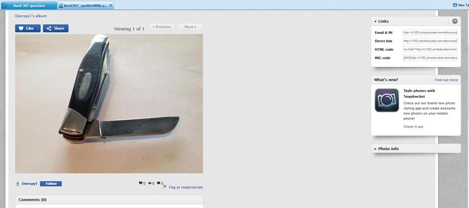

I can't seam to make the picture thing work need better instructions on how to past picture.
When you get to this point (see below), notice the "links" at the upper right of the page. Click on the code to the right of "Img Code" and it should show (in yellow) "copied". Go to your post and "paste".
Good find. My guess is that it may have been a tool or a gauge used in the blade dept. and got gathered up unoticed and put in the box with the other blades on their way to the next operation, finally making it all the way to you. Cool!

Finally got Phil Gibbs, of AGRussell Knives, formerly of Camillus Knives a photo of this 307. He says: "It is a glob of lead!
After the blades are almost finished, the ones that need to be "set" (bent so as to nest with the Spey blade in the closed position in this case) had their tangs dipped in molten lead to anneal them so they could be bent without breaking.
It is unusual that a droplet of lead to stick to the blade like that, but it did happen."
Inquiring minds want to know. Step two is, I bet it gets the ole give it a pry off try.
