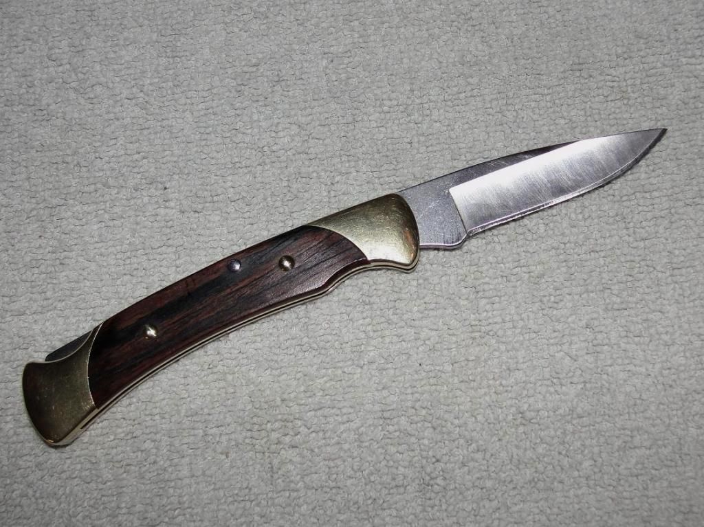

Out of all my few few dozen knives (among several Randall's, Buck's, and Kershaw's),....the most used knife is my diminutive Buck 55 that I've carried daily with me for about 10 years. It opens many boxes on a weekly basis that come in the mail, and I use it to cut the packaging tape when I ship something. I even use it occasionally at Wendy's when they run out of plastic knives for my baked potato. ( I keep my baby clean and ready to go at all times :-)
But truth be told I've never much liked the clip point blade shape, and much prefer the drop point blade of the Squire. However, the 55 is a better built unit in my opinion, so I went with practically and got the blade shape I dislike with the build quality I like (the 55 also has what looks like rosewood or cocobolo scales rather than marcarta). Sort of like marriage,....you compromise a bit and it;s all supposed to work out fine. ( Right!!! :-)
Anyway, recently I acquired a few Randall Model #26 "Pathfinder" knives, as I've always loved the very sleek 4" drop point blade and useful, practical 4" fixed blade length. After looking them over once in hand, I finally decided that if Buck didn't make "just" want I wanted,.....I would work it up as close as possible from what they do offer!

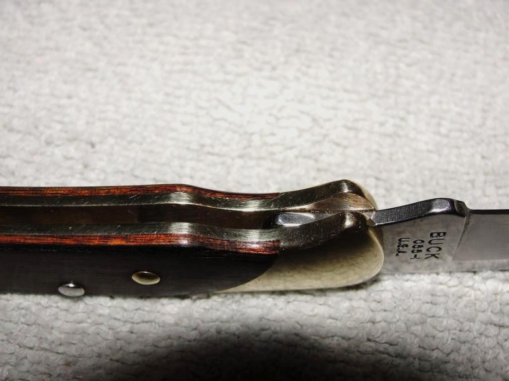

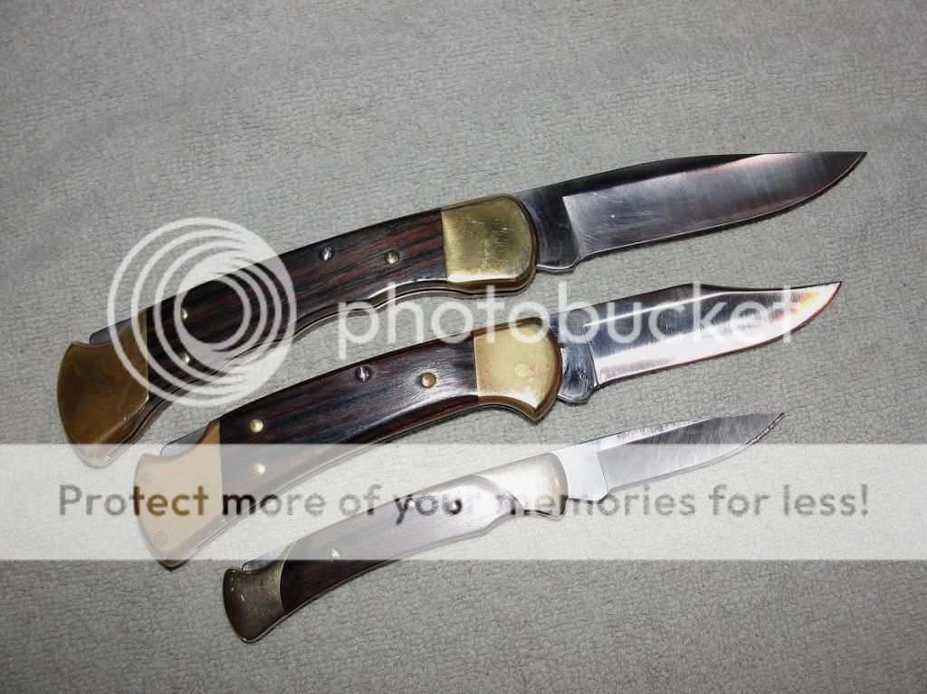

So that's how about a week ago I decided to try to get rid of that unsightly "bump" and false edge (to "me" anyway :-) on my Buck 55, and initially that's ALL I had in mind. But the blade change worked out so well to appease my tastes, that I decided to add a single finger groove to have a bit more safety and control. It also brought the lower frame shape a bit closer to the bigger Buck 112 and 110 models, which do have a sort of finger guard built in.
So that also pleased me very much, and I noticed right away the more secure and comfortable "feel" if the knife with the single index finger guard added. There is plenty of "meat" there to do the job and use the knife for it's intended uses,..."light duty cutting". (the most we all do anyway! lol)

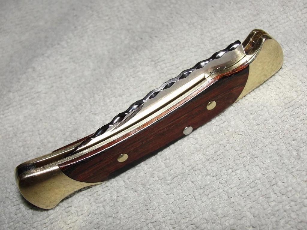

So OK,....I thing I'm done for awhile but nope, I was contemplating adding a short area of thumb notches,....but ended up doing the full top of that now sleek drop point blade in a sort of vine pattern "filework".

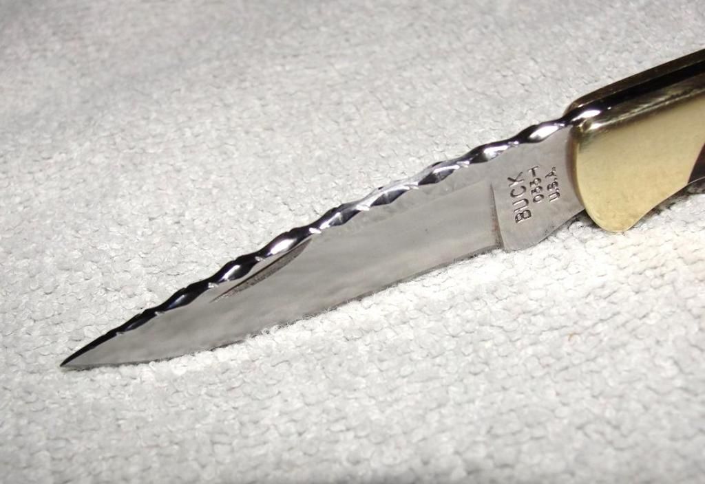

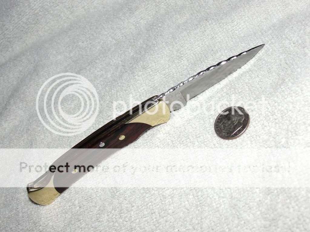

.....and YES, it was my very first attempt at a spine vine. (can't call it file work as they wouldn't touch it!)
To be honest, on my particular example my high grade jeweler's files wouldn't touch this stuff! The spine was harder than "s***!" (pardon my French :-) So in spite of having been OUT of Jewelry repair/diamond setting for over 10 years (I did it for 30 years), I grit my teeth and went at it with a regular stone separating disc, a VERY fine stone separating disc for the fine accents, a medium grip rubber wheel to prep for polishing, and a 1" muslin polishing wheel using "Fabuluster" jeweler's polish. All were hand held using my Foredom flexable shaft machine and working SLOWLY!!!
A fine point set of steel dividers allowed me to lightly mark off the spacing. I had to lightly fine sand brush the spine just to SEE the marks! lol I arrived at the spacing by marking off the edge of a US Nickel and doing a small trial run on the nickel, until it looked about right to be on such a fine blade as is on the Buck 55.
I used 2 small strips of black electrical tape over the blades sharp edge to protect my fingers, and very carefully placed my starting points between each section of the vine. I never got anywhere near worrying about heat being an issue with the grinding, but did dip the knife into a bowl of water frequently to keep the grit from working into the pivots. (and at times the knife would have to be opened and closed so this was important in my mind)
Next I enlarged and rounded the cuts as best possible, at a really S L O W speed the closer I got from repeated checking. All of this with a standard 1" stone cut off disc. A medium grit Cratex rubber wheel smoothed and rounded to shape, and only then did I move to a very fine stone cut off wheel to add the "thorns" to the vine. Last steps was a good polishing into the larger rounded out areas, and a final light brushing along the top to highlight the polished areas.
Don't forget to do a thorough cleanup to get all the grit out. I used fine brushes and a plastic bowl with dish detergent in it, followed by a good rinse and a trip out to the garage to blow out all the water with about 80 pounds of air pressure from my compressor. Last step was to work some light oil into the pivots, work the opening-closing cycles a few times to get the oil where it needs to be, and them wipe out all the excess you can with folded over paper towel pieces. The excess oil will just attract dust and grit if you don't get rid of as much as you can.

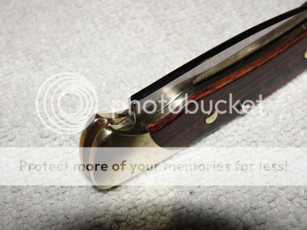

Index Finger Guard Recess Cut, but before "Filework" done: (er,...."Grinding work" :-)

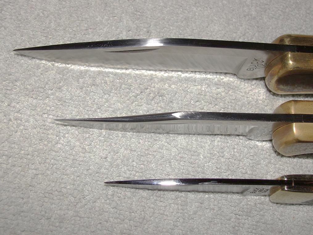

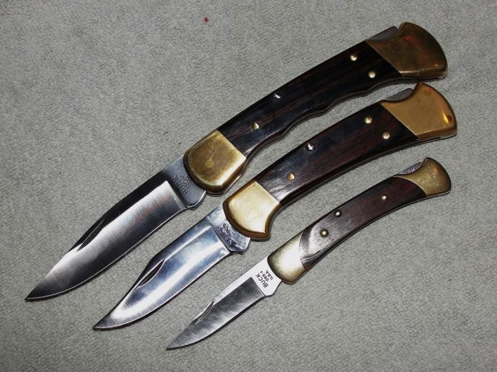

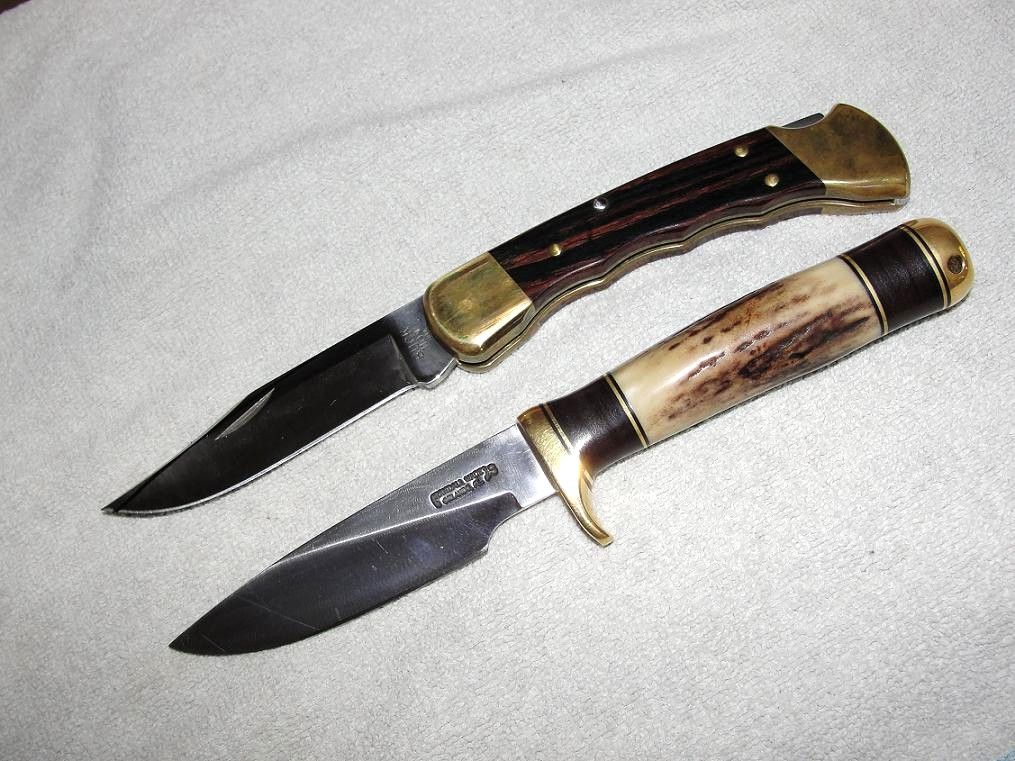

In the next 3 pictures all three sizes of this style shown together.
The Buck 110 with just the same blade shape change on top, Middle is unaltered Buck 112, Bottom is Buck 55 before the "filework".
The Buck 55 in this photo (bottom of 3 knives) has had the blade spine re-profiled, but the index finger groove and spine vine had not been done yet.
By the way, this is the look I was going after, .... on my Randall Model 26 Pathfinder 4" fixed blade below against the then unmodified Buck 110. I think I got as close as possible with minimal tip length loss on the Buck 110, and very little on the Buck 55.

.....or more accurately in this case,..."stone cut-off disc work" :-)
And yeah, I was really surprised how much better the finger groove made this small knife feel in hand. The knife gets buried up inside most hands anyway, and just this simple feature really helps to sort of lock the knife to your hand. I see no reason Buck doesn't offer just that feature on this model, as there is PLENTY of "meat" left in the brass liners to support the blade designed for light duty anyway.
.......and it was the easiest change I made to this one. Using a 1/2 inch cylinder sander that's rubber cored and takes various grits sandpaper. It expends a bit to hold the tube sandpaper on. (available at Sears and elsewhere) I used 60 grit at LIGHT pressure to SLOWLY rough out the shape. (to avoid chipping the wood edges) Then 120 grit disc to final shape, and finished with a medium Cratex abrasive wheel and polished with 1" muslin wheel and "Fabuluster" compound.
The Finger groove took all of 10 minutes to get done! :-) The blade re-profiling about an hour using mostly the 60 grit/120 grit 1/2 inch drum sander, and finished with finer grits to crocus cloth by hand. I polished the edge with "Fabuluster", .....just a great all around jeweler's polishing compound that works great on steel also.
......the really tiny grinding of the vine into the spine took about TWO HOURS, as one slip of the cutting disc and the "flow" of the vine was lost. Working with a really painful right shoulder didn't help. I've had "Calcific Rotator Cuff Tendonitis" there for 4 years, and why I haven't worked during that time. Worth the pain on this one though. :-) These 58 year old eyes have been away from such closeup work a long time, but it felt good to get this done and up to my personal standards. (folks still MISS my jewelry work and ask when I'll be back! lol)

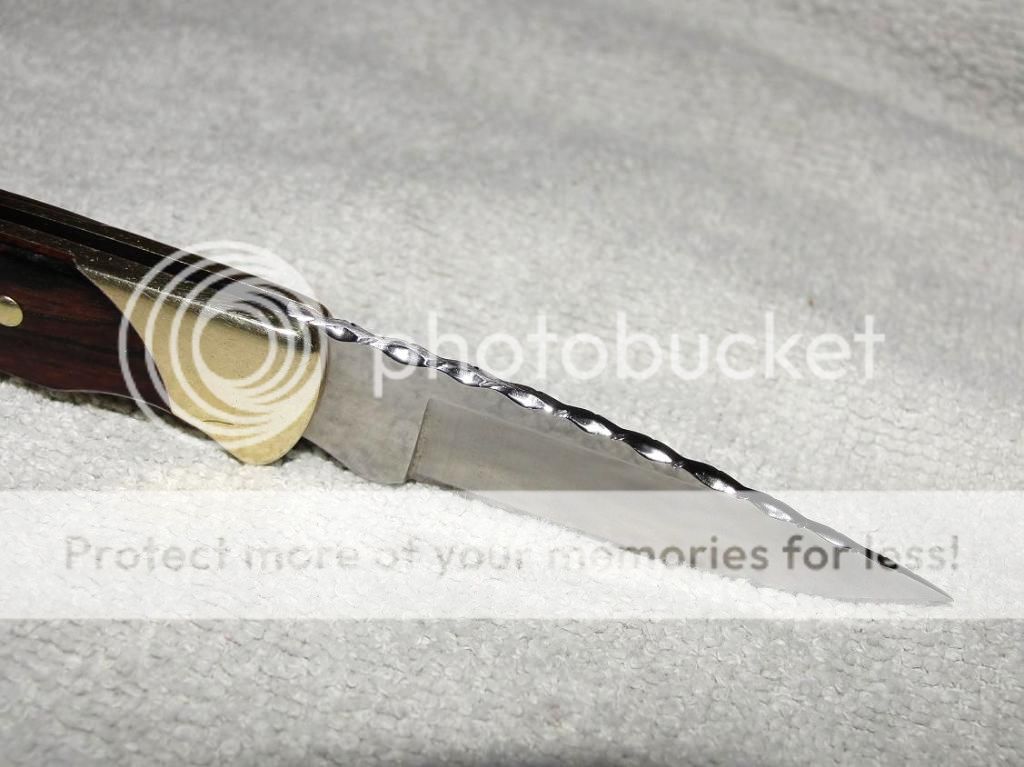

Better shot of the "flow" of the vines, which came out very even looking:

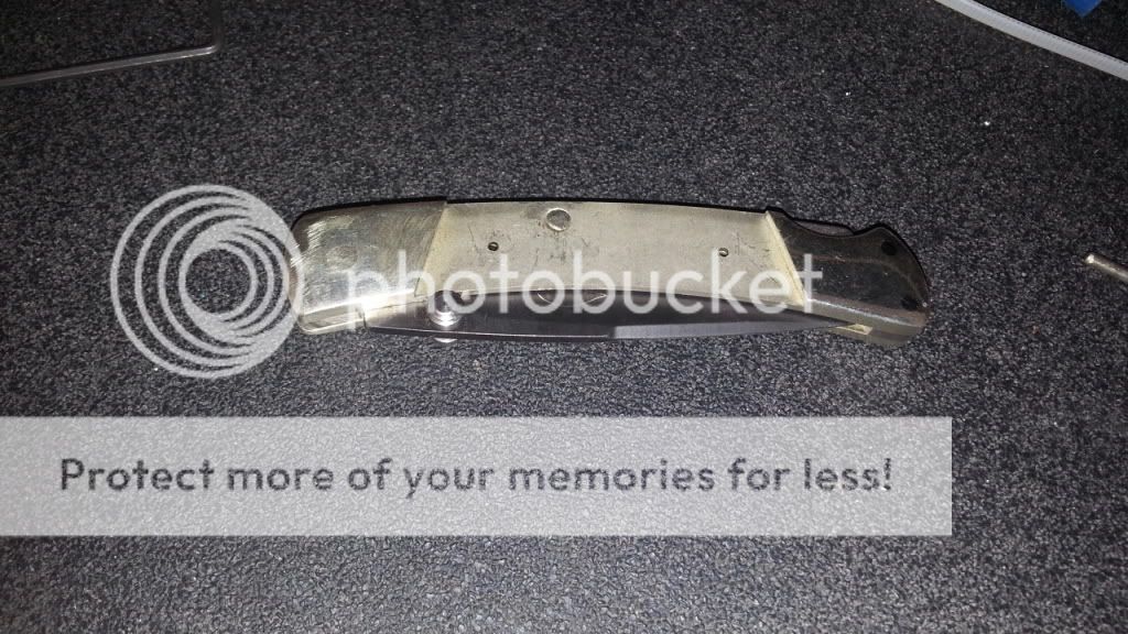

Has anyone noticed a lock up, excess play, or centering problems in the Buck 112's when you do the recommended blade swap outs? Just curious???
Just test fit the blade with a new pivot pin before peening the pin.
If it doesn't fit perfectly, swap the lockbar too :)
