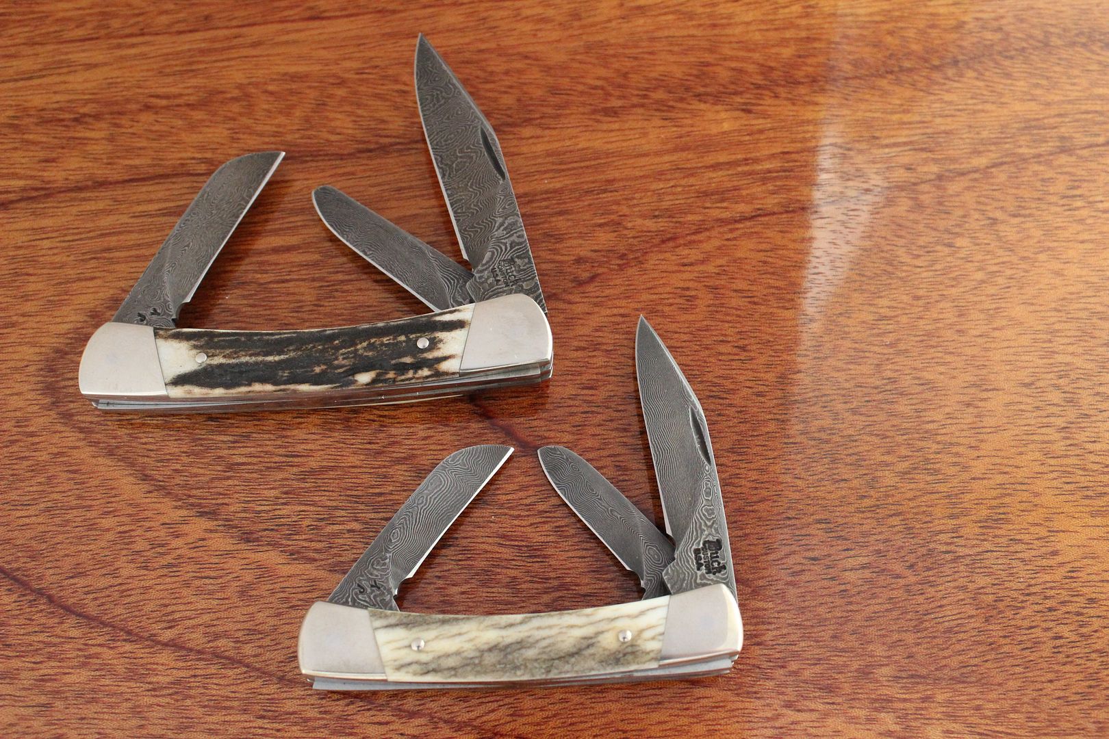

Here is a set of 700 series knives from the old custom shop (note the handle pins). These two are special.
Now these are the only 700 series with factory stag with pins I have seen. The OP's knife looks aftermarket to me. as noted by others that incert is not factory.
