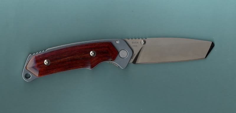

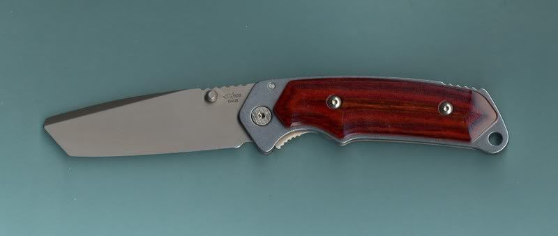

Yes it can be done. I got this from one of our forum members years ago. Brother Jim did not like the Bravo blade. However, he did like the Bravo handle. He took the blade out of 850/277 and switched them. He kept the 277 blade in the plastic handle and I got the 850 blade in the 277 handle.
See the back knife I think there was a little fitting required.
