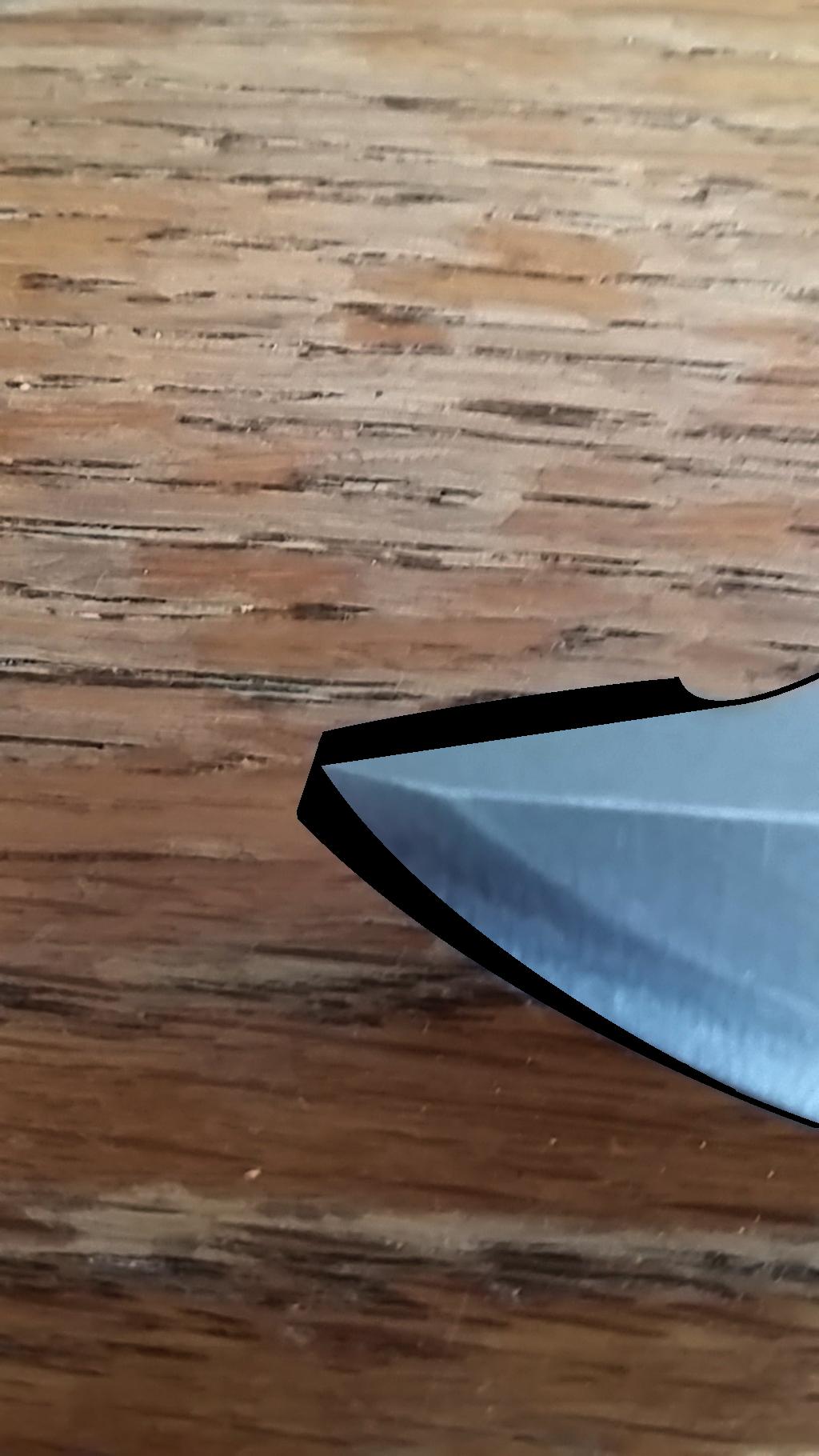

This is the tip. Sorry for quality my phone has been terrible taking pictures lately
My .02, if you can, I would work both sides (spine and edge) to keep the tip point on the midline. On the spine side you could probably go from that first... serration? straight to the midline. On the edge side, start on the belly maybe 1/3 of the way back, and work it as a curve to the midline where the new tip will be. (Wish I had a way to draw on a picture). Anyway, like I said before, mark it with a Sharpie to give you an idea.

It's hard to tell the scale from that picture, but I agree that it might need shaping from both sides. Here's one way you could go. The black areas are what you would grind away to form the new point and blade curve.

I have a feeling you made it seem way to easy lol. Would using a bga or a stone be the best bet?
I would use the back side of the BGA where the platen is. You can run it slow enough that excess metal removal and heat buildup shouldn't be an issue (cool as needed)... and it's easier to see what you're doing.
Like I said before, I think it's easiest to do the majority of the work 90° to the belt. On the spine side that's pretty easy. On the edge side, as you get close to the shape you want, you can switch and sharpen in a new bevel and edge. Remember to start back and work towards the tip (on both sides).
If you want a bit of practice, snap the tip off a cheap kitchen knife... I think you'll find it is easier than it sounds.
