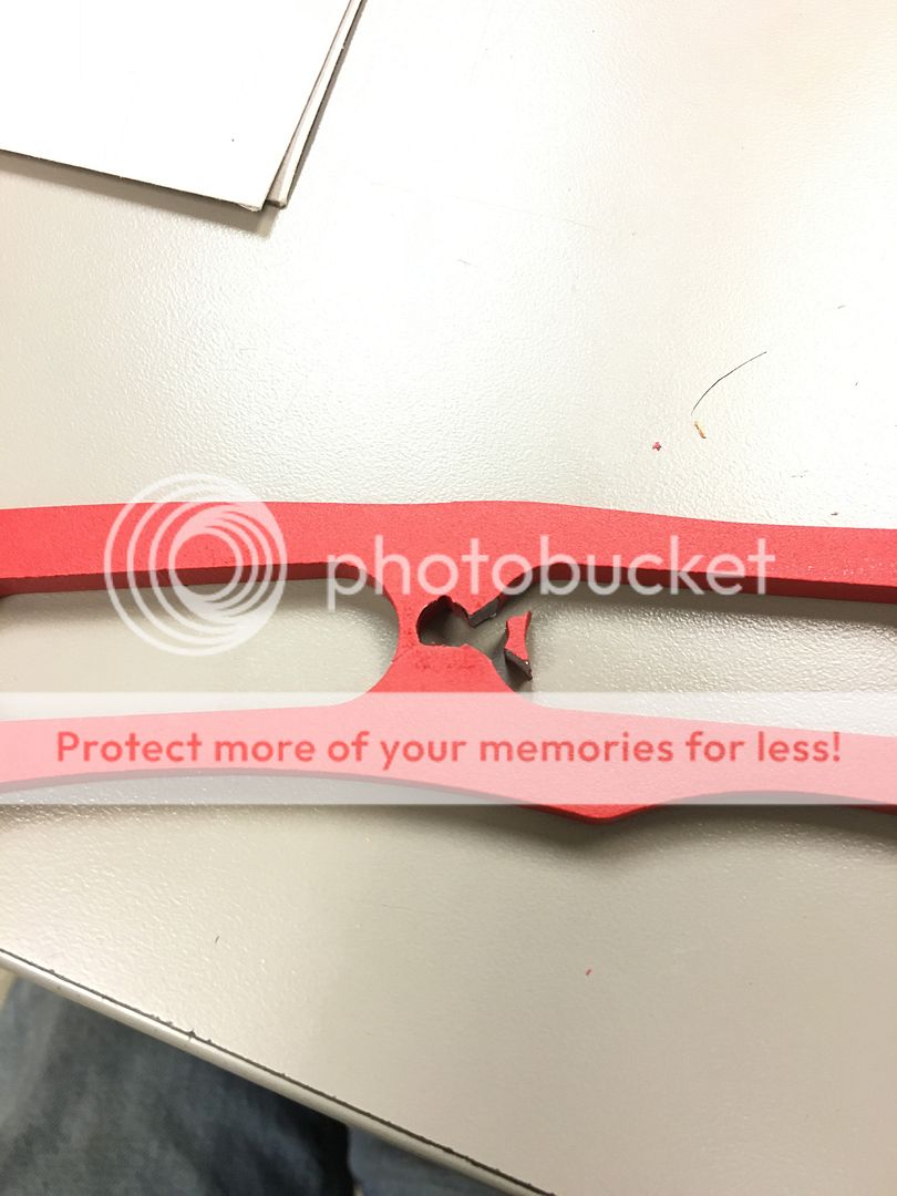

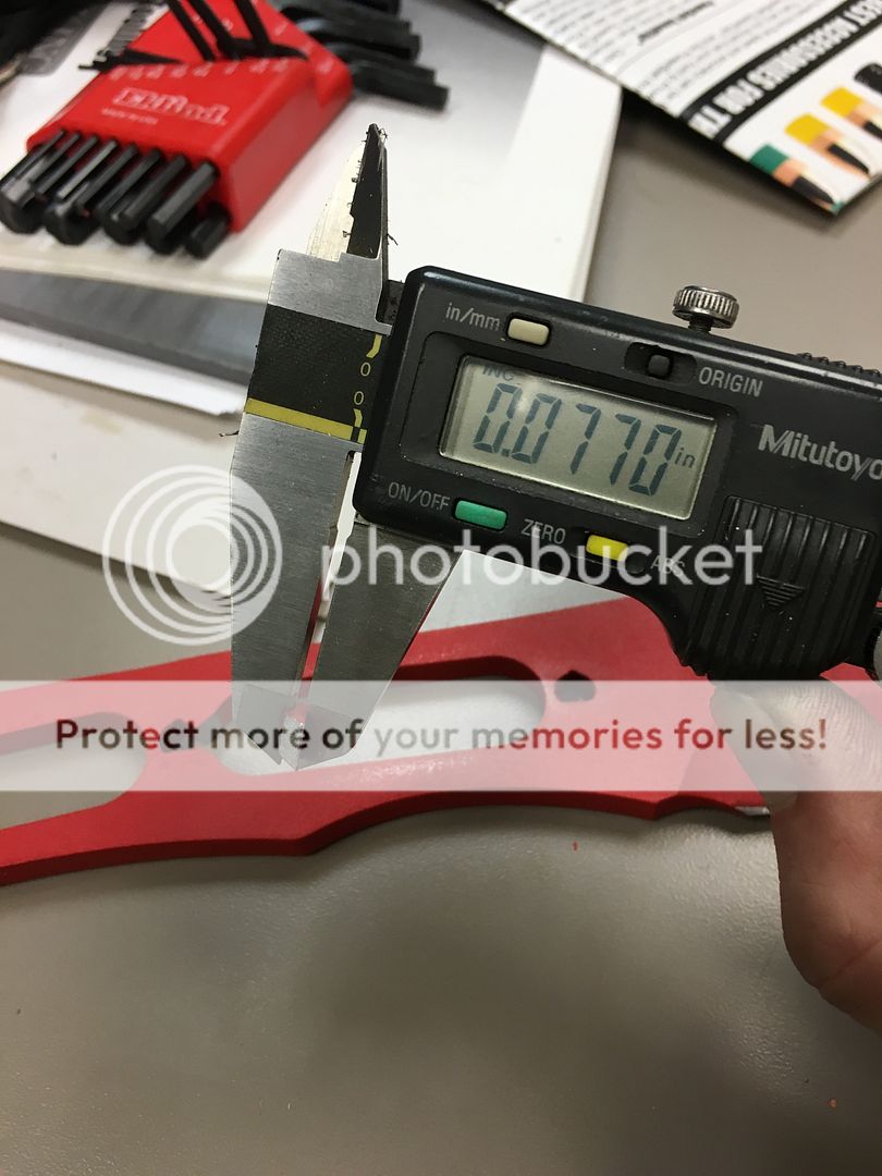

I was loving my froe until I removed the scales (because one cracked) and realized that the tang has broken at the center bolt hole. I've certainly put it to hard use but I don't think I've abused it. I haven't used it for anything that I hadn't already done with my BK 9 (without causing failure). I'm not here to bash, because I love the way this beast performed. Just wish they hadn't removed so much material in the tang cut outs.
I've been in touch with customer service and they have been great so far.

I'm not bashing either but that 0.077 web could be doubled or tripled without noticeably increasing the weight of the knife.

Do folks from Buck show up here often? I'm new to the Buck world but spend a good bit of time in the Becker subforum. A couple of people from Kabar and Ethan himself are very active on that forum, pretty neat to see. I sent these pictures to the CS rep I've been talking to. I also asked to be put in touch with someone from their design/engineering department. Still waiting to hear back.
My thoughts exactly. Even if it was a noticeable weight increase I would prefer that to compromising the strength of a knife designed for hard use.
Sometimes Buck employees post here. It does look like they need to leave more metal around the pins of that model. DM
