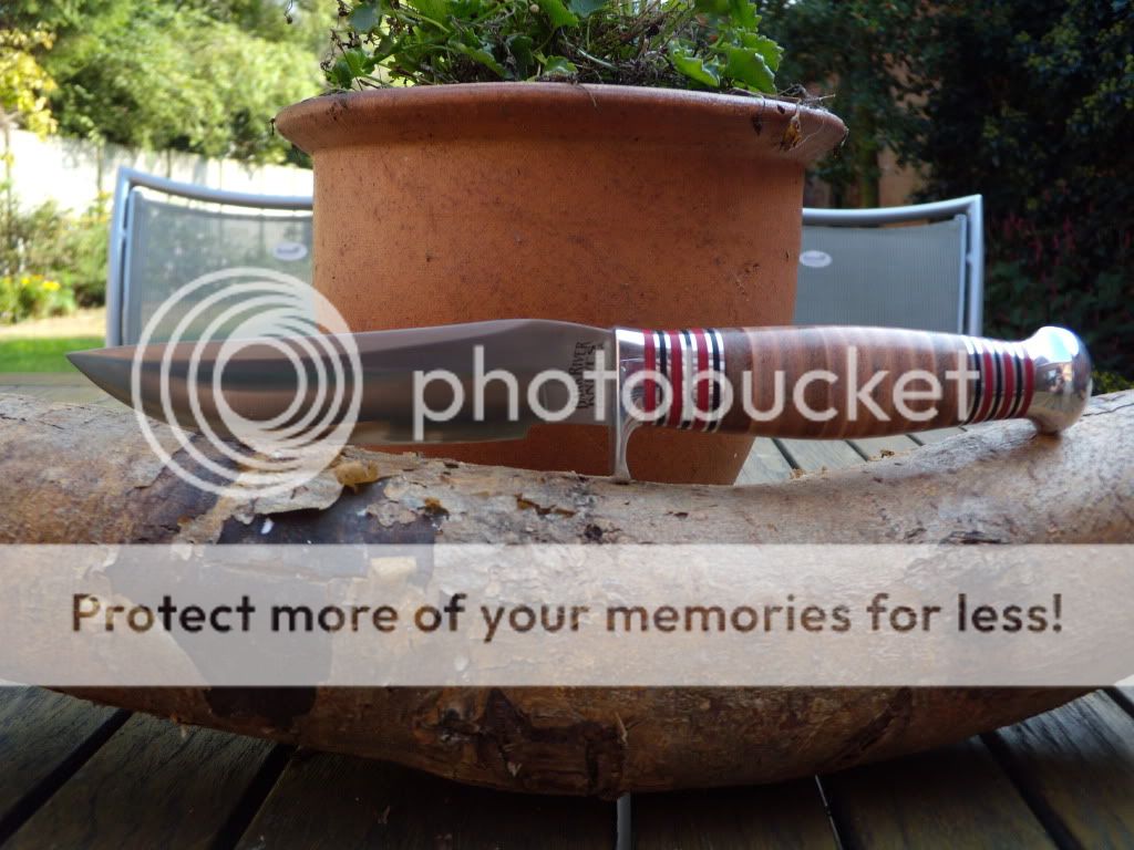

This fall, I need to try out my new Randall Model 8 Trout and Bird:
I think most of the knives advertised as "hunting" knives are too large for deer hunting use. My rough test for blade length and handle design is to hold the knife and then place my index finger along the top of the blade. I prefer a handle and blade that allows the tip of my index finger to just cover the point. (Even the Randall "Trout and Bird" knife is longer than I'd prefer for deer!) Instead of using a gut hook to open the abdominal cavity I like to use the knife, inverted, with my index finger along the the back and protecting the point from piercing the internal organs while slicing open the skin.
