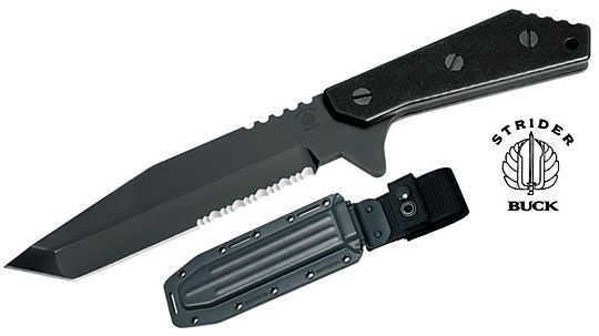

Here's where our story gets interesting. One of the laser-cut blank
blades passed around (the only things we were ever allowed to touch)
was "the thickest steel we've ever used." This was a full-tang
Tanto-style blank with a blade of about 7.5 or 8 inches. Overall length
was probably a foot. This thing must have been a quarter of an inch
thick (ok, maybe 3/8 of an inch) and makes the BuckMaster look like a
110 Hunter. This thing is huge. After we got to the heat-treat
department, I saw a whole bunch more of these, and asked "Is this a
current product?" because I for sure had never seen it in the catalog
or web site. "No, that's for a new knife," was the answer. I'll say,
and one that is no doubt a Strider collaboration. I checked one closely
and saw no model number stamped, just BUCK USA. These ones by the
heat-treat section were further along in the finishing process, with
the blade edges more or less fully ground, but what was interesting is
that the top side of the blade had a groove cut-out of about 2.5 inches
long (maybe 3 inches from the tip) that looked like a blood groove, but
ran right off the top edge of the blade. I'm not sure what this was, so
I guessed it is some sort of blood groove or they would be adding
serrations later on in this area of the blade, and these just had not
been ground in yet. Either way, my comment is that this if this new
knife is not public knowledge, it is now, and Buck should either drape
stuff when conducting tours, or require people to sign non-disclosure
agreements. The concept of secret R&D is not limited to just the
technology industry.

Weird thing about the store: I wanted to buy an 882 Police Knife (which
they had, but not in the display case and I didn't catch the price
either) but they said they can only sell them to law enforcement. But,
sitting right there in the case, with a pretty good price (IIRC, $180
or so) was an 888 Strider Solution, which is quite a bit bigger and
nastier-looking. Why is that knife OK for the public to buy, but not
the 882? Seems like a silly distinction to me. The lady behind the
