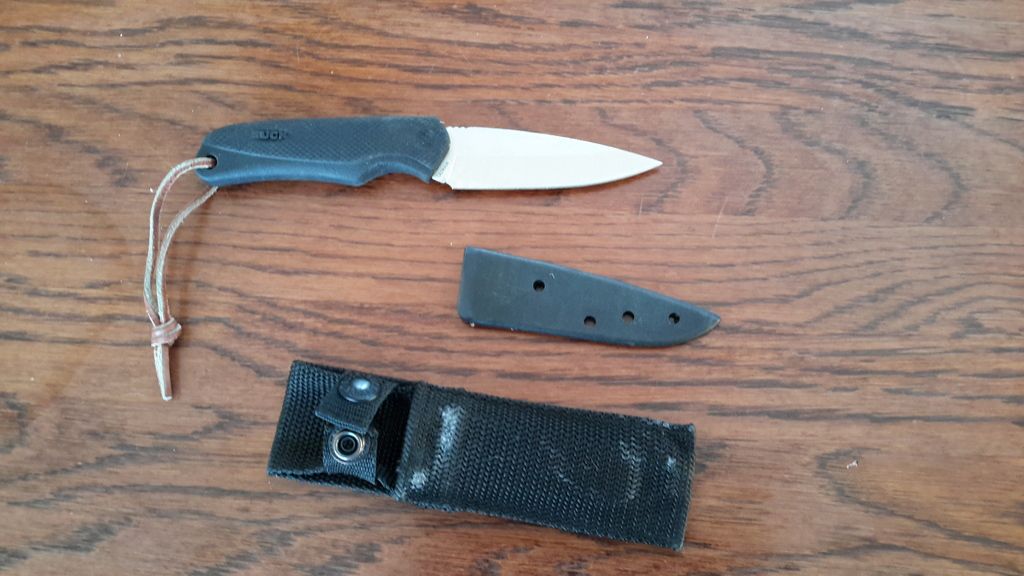

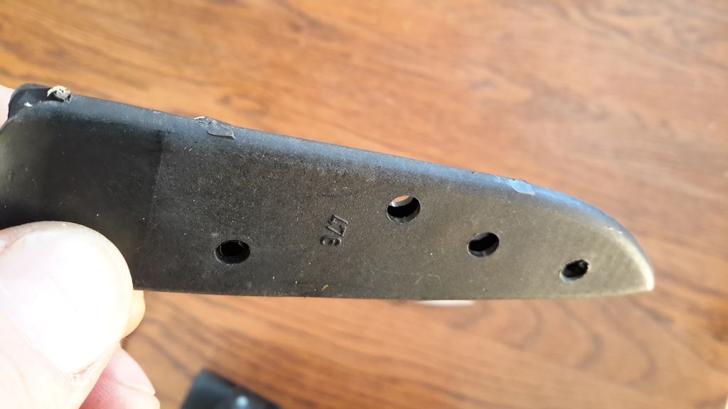

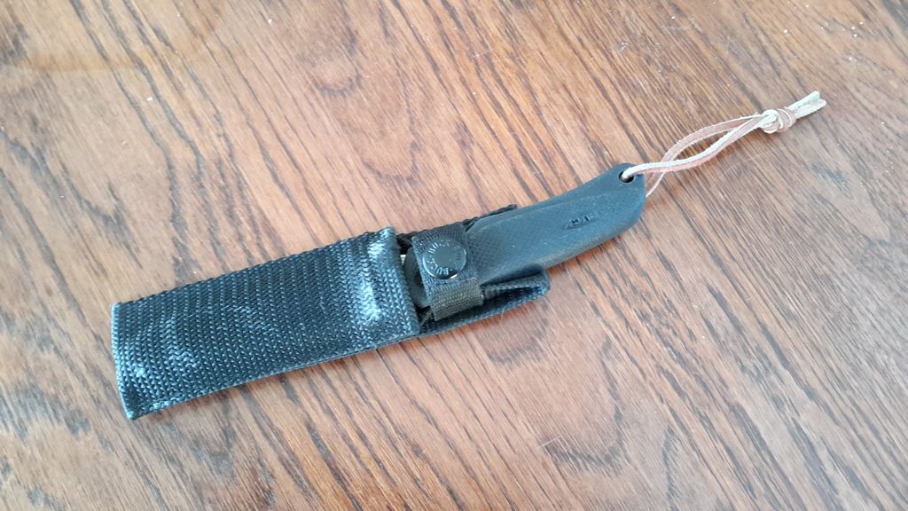

My Diamondback 476 sheath came unravelled, so I took it apart and found the plastic insert to have four spurs, barbs really, that pointed upwards, making it difficult for the insert to slide out. In manufacture they probably stitched the nylon closed and then jammed the plastic insert in. I took the insert, removed the snap loop, and threw the rest away. Then I trimmed the barbs off the insert and slid it into a Maglite holster and sewed the snap loop on. Now I have a working sheath for a knife that cost me $5.00 at a garage sale. It's been in my get-home bag for years but I recently starting using it.
Zieg
And here you can see where I cut the barbs off. At first I was sorry I cut them off, thinking I needed to keep the insert secure in the holster-cum-sheath. But after using the thing in the barn and filling it with dirt, hay, apple debris, and other junk that had stuck to the blade over a day's work, I realized I needed to be able to clean the thing.
Zieg
All this is to show that you would have a hard time doing anything to the plastic insert that would form it tighter to the blade; short of shimming it as suggested earlier. And anything you put in there runs the risk of staining the blade. I've just gotten used to the rattle of knives in sheaths like this. I make enough noise on my own that any rattle is unnoticeable to me now. And puukot in wood or antler sheaths, quite traditional, rattle, too.
