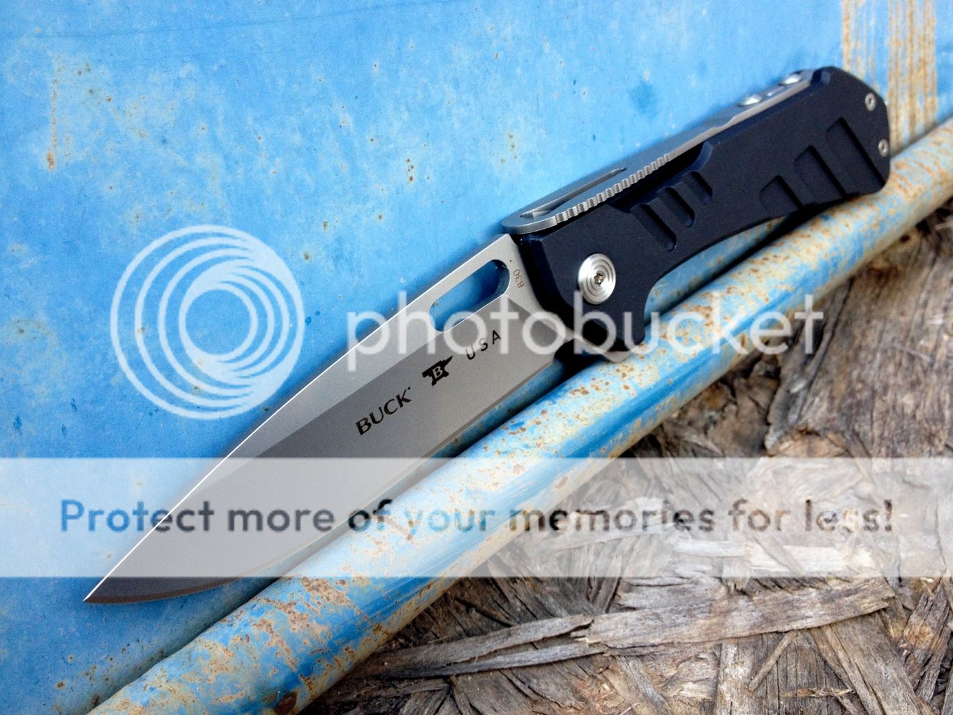

The Marksman is an eye catching knife, and possibly the biggest leap for Buck in quite awhile. I'm glad they took the leap. This knife is one of a kind, and other than a few very small mishaps, the knife would be in a league of it's own at this price point. It features Buck's new Strong Lock System, which is a strap lock with a few modifications, and a nice 154CM 3.5'' blade. According to Buck, the Strong Lock System can with stand 600 pounds of force, and is the strongest lock they've tested. The Marksman is a collaboration between Buck and Grant & Gavin Hawk. Another plus, the Marksman is 100% Made in the USA. Also, Buck's Forever Warranty and great customer service really sweetens the deal. I picked up the Marksman for $82.99 from an online retailing giant.

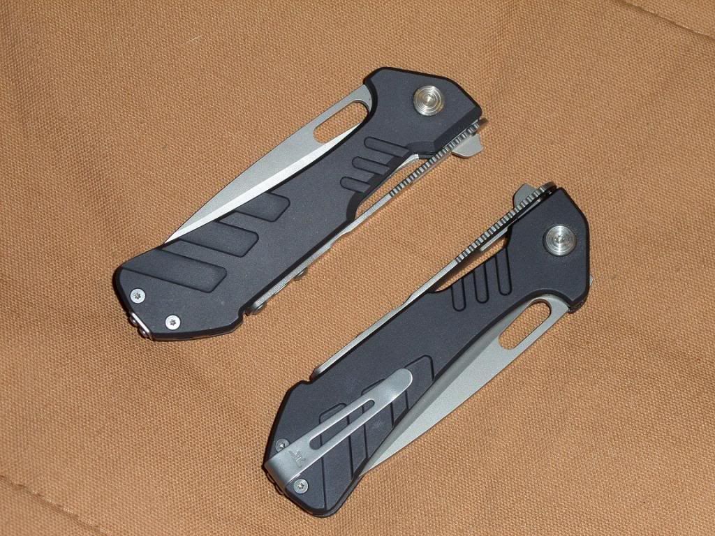

Aesthetics: The Marksman is stunning, no question about it. It has a look of none other, and the blade shape in my opinion is PERFECT. The Black Aluminum handles really offset the bead blasted blade finish.
Materials: The Marksman is put together very well, with the exception of a few pieces of soft (pot metal) hardware, which I will get to later. The knife is also extremely light when accounted for the quality of materials it is made up of, the Marksman clocks in at 4 oz. The knife is shockingly light.
The handles are milled Aluminum, and feel very high quality. The Blade is 3.5'' 154CM with BOS Heat Treat in a bead blasted finish.

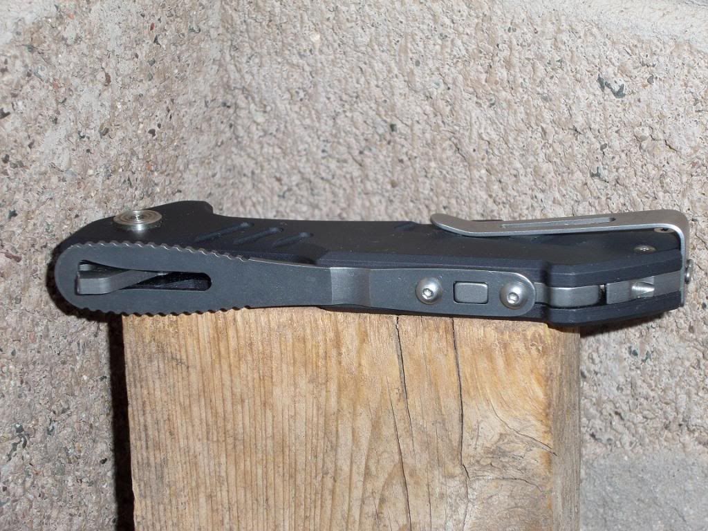

The negative on this front are what I consider to be cheap pot metal screws that hold the strap lock in place. These are located on the top of the strap lock. When adjusting the strap lock one must be very careful not to over tighten these screws, they will distort and strip if not careful. I have replacement screws being sent from Buck free of charge. The strap lock screws need to be hardened, plain and simple. Another negative, is that the blade stop pin is metal inserted into an Aluminum handle. Metal beats steel, and thus after hard use the stop pin will wiggle slightly. This can be compensated by loosening the top two strap lock screws, and slightly tightening the strap lock adjustment screw, followed by tightening back up the strap lock screws.

Over time parts will wear, settle in to place, and leave a bit of play in the lockup. No fear, there is an adjustment screw in Marksman that will pull the strap lock towards the rear of the knife, thus making lockup feel like a bank vault.
