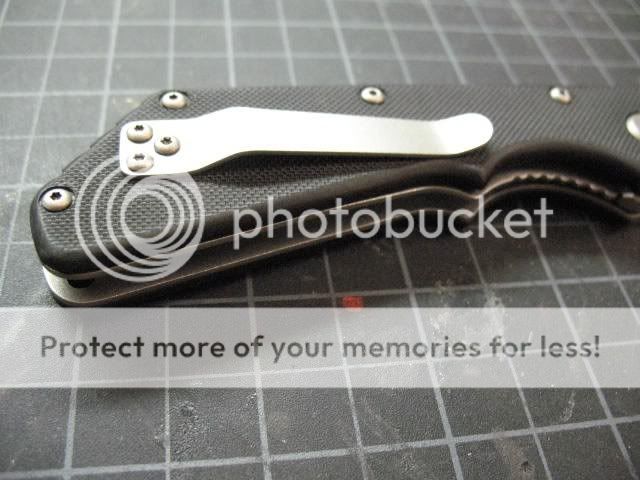

You guys might like this, all bead blasted hardware and blade. with a slight radius over the entire perimeter of the G-10.

that looks good to me.I bet it feals good in the hand.
Thanks for shairing.When can we get one at WalMart/LOL

DUH!!!!!
Awesome.
I would go black blade. You know what they say..."once ya go black blade, ya never go back".
Like showing me a nekid pic of Christina Aguilera...something I want but will never have :(
Thanks for sharing Hang Em.

Actually, if you have some hand skills like heng em, you can do this mod pretty easily. The whole knife can be taken down to bits with a T-10 and T-6 torx wrench. Remember to look and see which side of the blade each washer goes on before diasassembly (they are two different sizes and thicknesses). Then radius the edges on a belt sander (or with sandpaper) and re-assemble. Lickety split.
