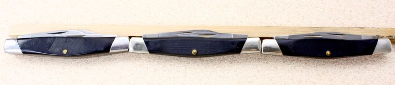

But for better or worse on my part here goes...... the spey blade is the least used blade in a stockman. Generally in the past era the spay was kept as a fine and thin edge used for delicate cutting...hence the reference to "spay". The sheepsfoot was second in use (clip being first) and was a heavier made blade which lent itself to hard cutting, scraping, carving, chipping,etc. Placement on the opposite end, using Bucks three spring construction, gives that blade (and pin) support of the other spring ends which makes that end of the knife "stronger". It also centers the blade in the axis of the knife and arranges the nail nics to better fit with the Buck Stockmans scale profile to improve access by fingernail. You will notice with the change in from two springs to three the blade locations are better suited for the spey to be with clip and on the outside of the reverse, as it goes deeper into the blade well and the sheepsfoot is taller in the blade well and makes nic access better for a center blade. Note the scale profile changed from Camillus made two springs to three spring made Bucks. Which came first the chicken or the egg. Or in this case Camillus or Buck.... The clip blade itself was reduced in width from the Camillus made knife to the Buck made knife. The older knife the sheepsfoot was as high as the ciip, in the first three spring knife the clip is almost overshadowed by the sheepsfoot height (width). More than you wanted to know.........
300Bucks
Represented here by 303 for smaller photo.
Camillus 2 spring, spey opposite clip: Buck made 2 spring, notice scale change: Buck made 3 spring 1991, spey with clip/ sheep opposite
