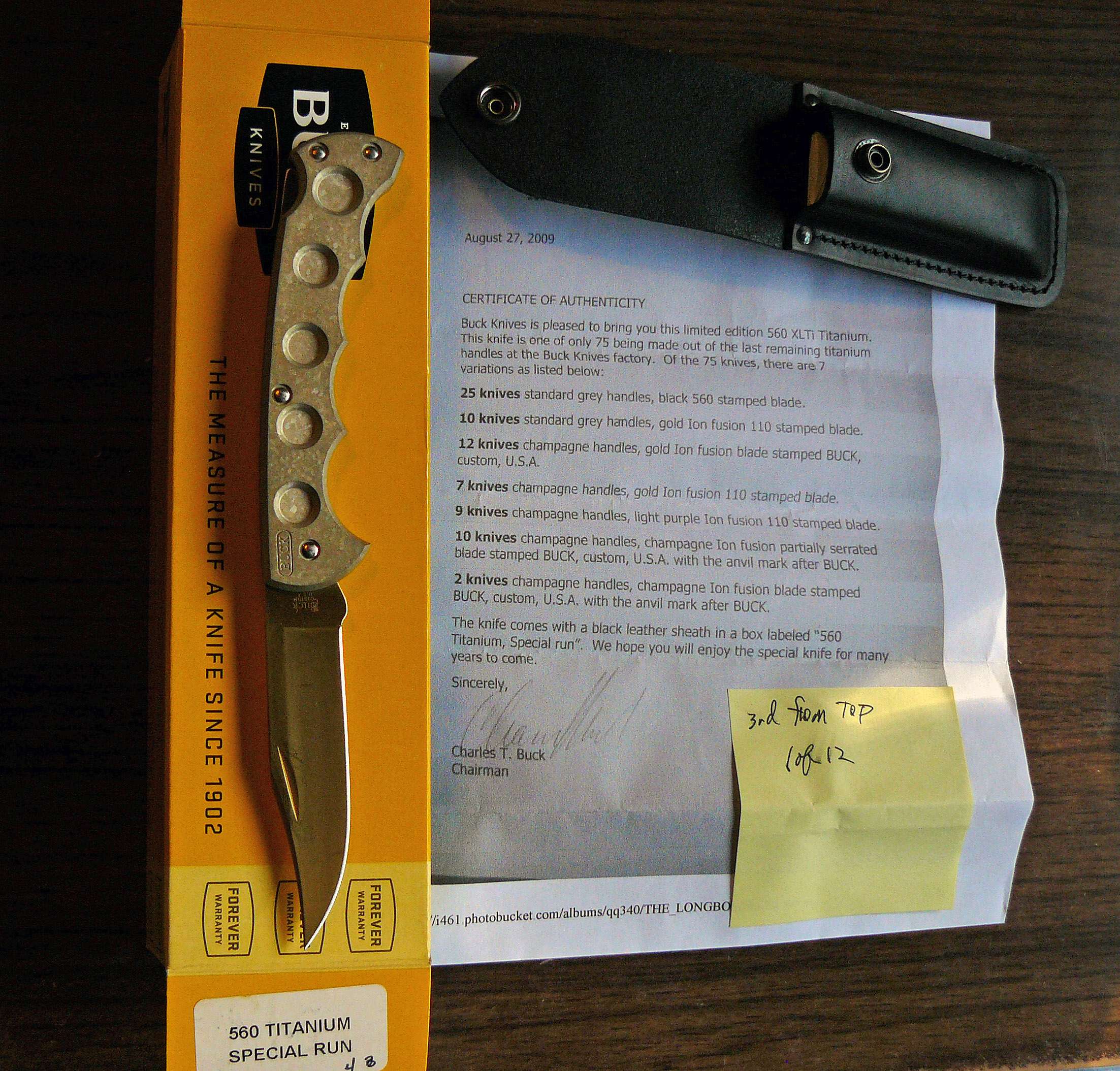

Here is a 560 I bot from the hands of Chuck Buck a few years ago @ OKCA, champagne handles with gold Ion fusion blade, 1 of 12:

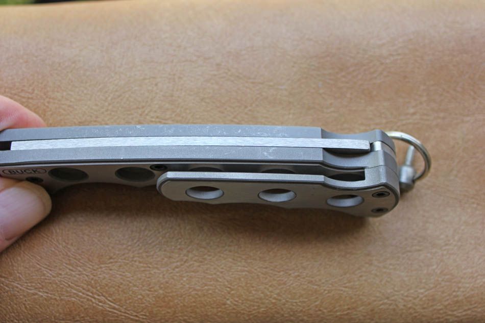

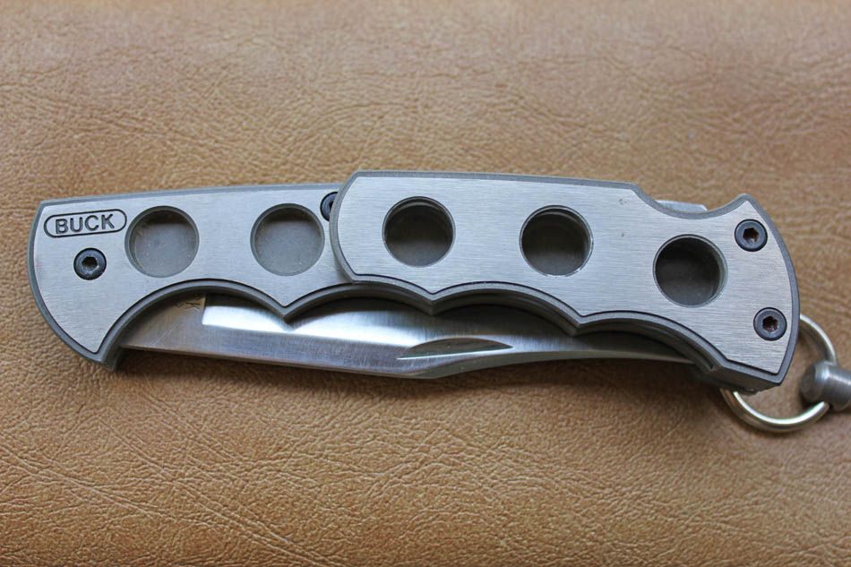

Thank you for the welcome and info. I'm not sure what I will do to mine. I have seen pictures of what appears to be a doubled up back scale?
If I'm saying that wrong what it looks like is the back end of the knife has twice the thickness as the handle closer to the blade.
Does anyone know what this is for?
Thanks
Is this what you are referring to? If so, the knife in my pictures is a model 186, not a 560. It came out prior to the 560 and was discontinued. The addition on the back is a belt clip and is removable.
Yep that's it and boy is that sweet :cool:
Is that pocket clip also titanium? I wonder if it would be less expensive to mod mine (if possible) or just watch for the model shown in this picture on ebay or at a estate sale?

Yes, the "clip" is titanium but it is more like a hanger than a clip. There's no spring to it, so it would be held on your belt by gravity only. I just tried to "hang" it on my belt and it won't fit, the belt is too thick (about 3/16" basketweave). The "clip" opening is only 1/8".
The plastic "scale" is actually a plastic sleeve to be put on the blade when assembling or disassembling it.
The metal split ring is attached to a stud screwed into the side opposite the "clip" and holds a hex driver used to remove the screws/bolts holding the knife together.
