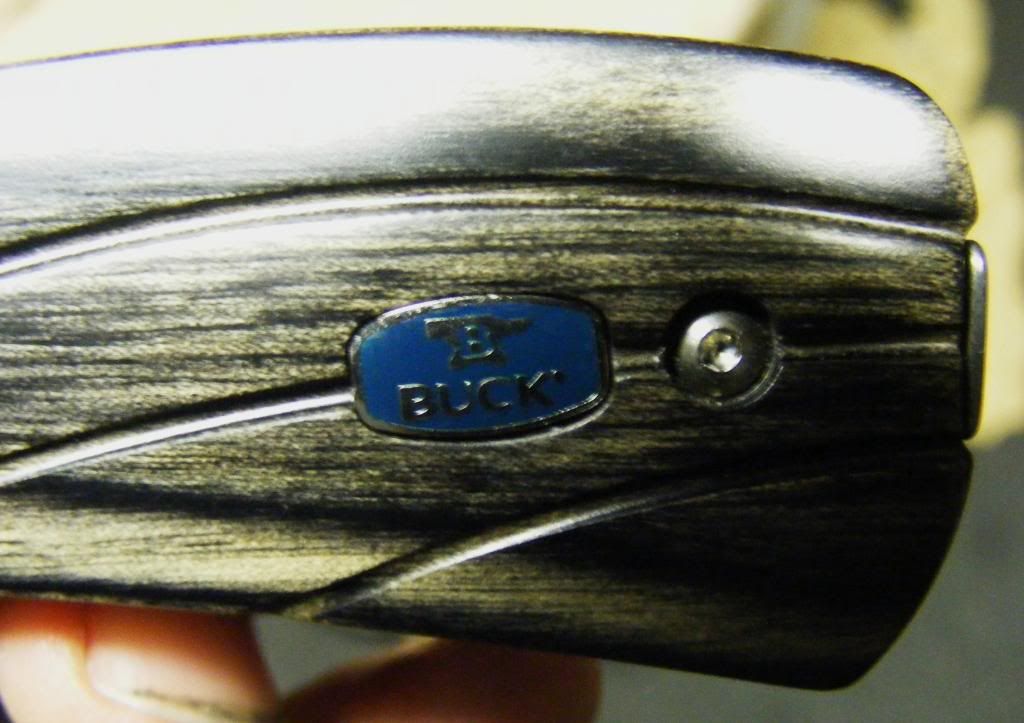

The Handle: The closed Vantage Avid is 4-1/2" long and 7/16" thick. It's a thin knife; a tiny bit thicker than the $20 Dozier knives from Kabar. The liners are stainless steel, and they're solid (not drilled out). The handles are Dymondwood with a smooth texture and no real pattern; just some random wavy lines. The Dymondwood that I've seen on-line for this knife looked very dark to me, almost black. In real life, the handle scales are pretty nice to look at.
The Buck Knives logo is inlaid into the left handle slab.
The slabs are held in place with two T-6 screws on each side, and the blade pivot pin is adjustable (also a T-6). The knife is an open-build design; there's the blade, a pillar, and a stainless spacer in the butt, and the rest is open. I like this. There is no blade stop pin; instead the liner lock itself stops the blade from overtraveling.
