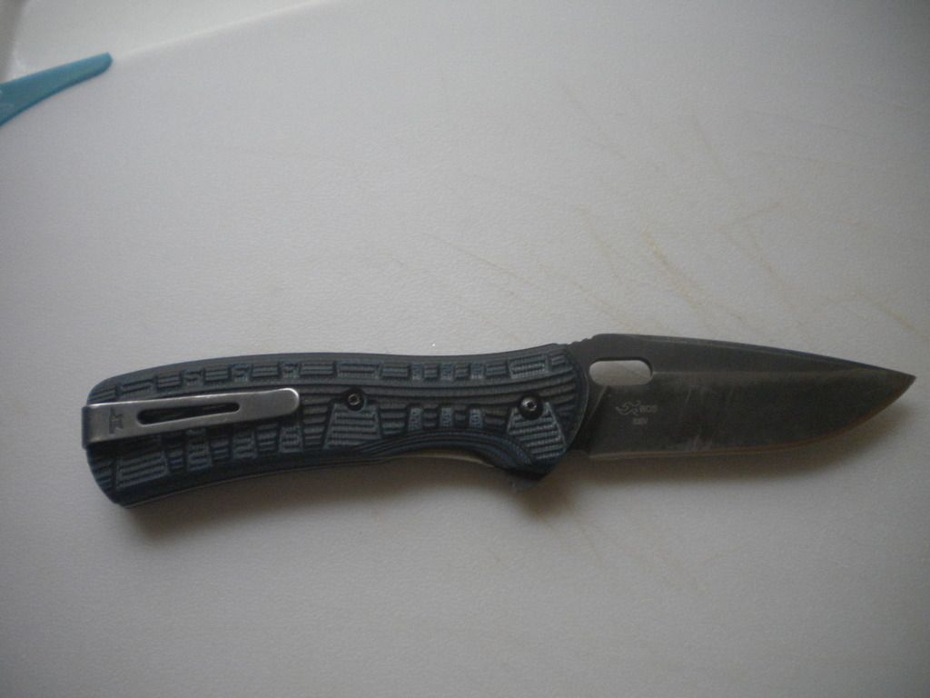

Here is one after a year of EDC by a guy I used to work with. A kid really. I sold him his first two knives. The second he picked out online around last X mas.
His father is a police officer so he chose the blue and black.

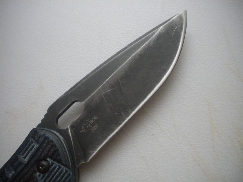

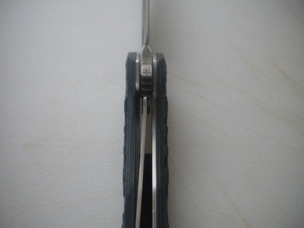

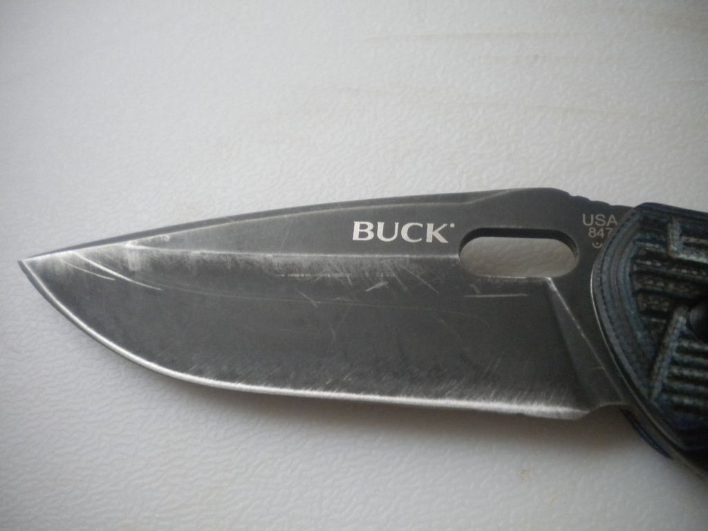

He used it hard for a year. It had a loose lock. The bar trveled all the way over and the blade would shake. I used epoxy and steel to fill in the corner cavity where the inner stop pin hits. Did the trick. Slammed it open hard a dozen times and it is like new. He also used the heck out of this blade. Which is razor sharp once again with a nice 800 grit biting edge.
Though I would share photos for you Buck guys.
