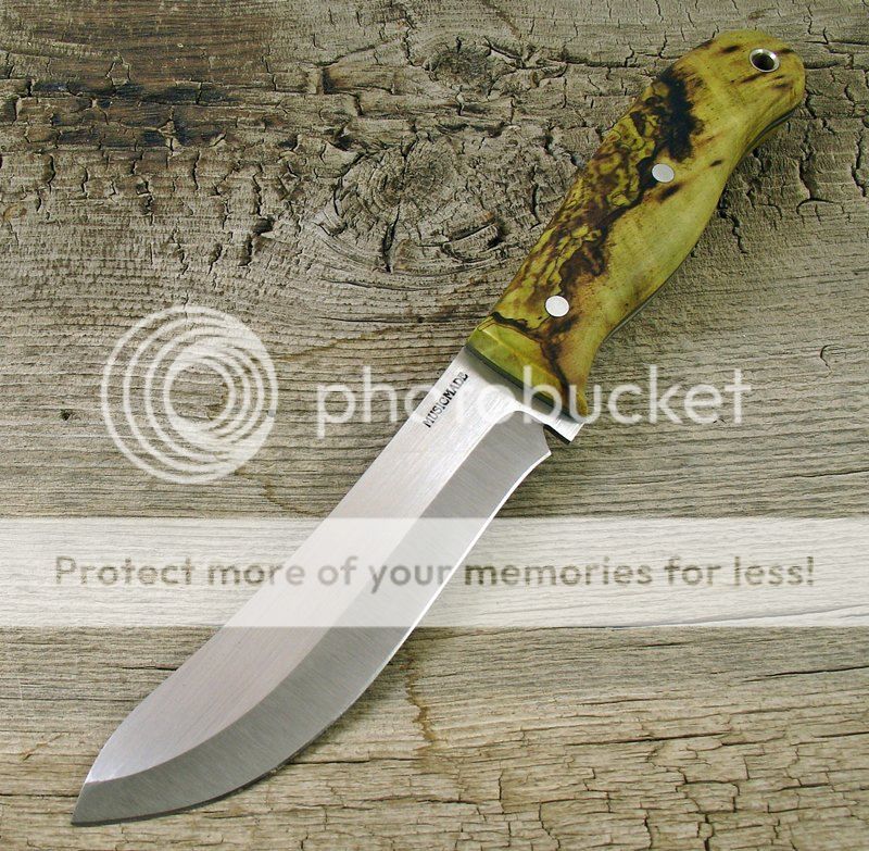

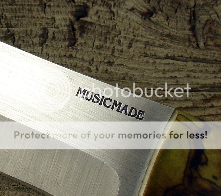

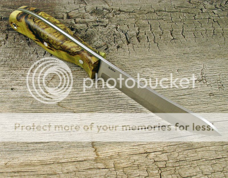

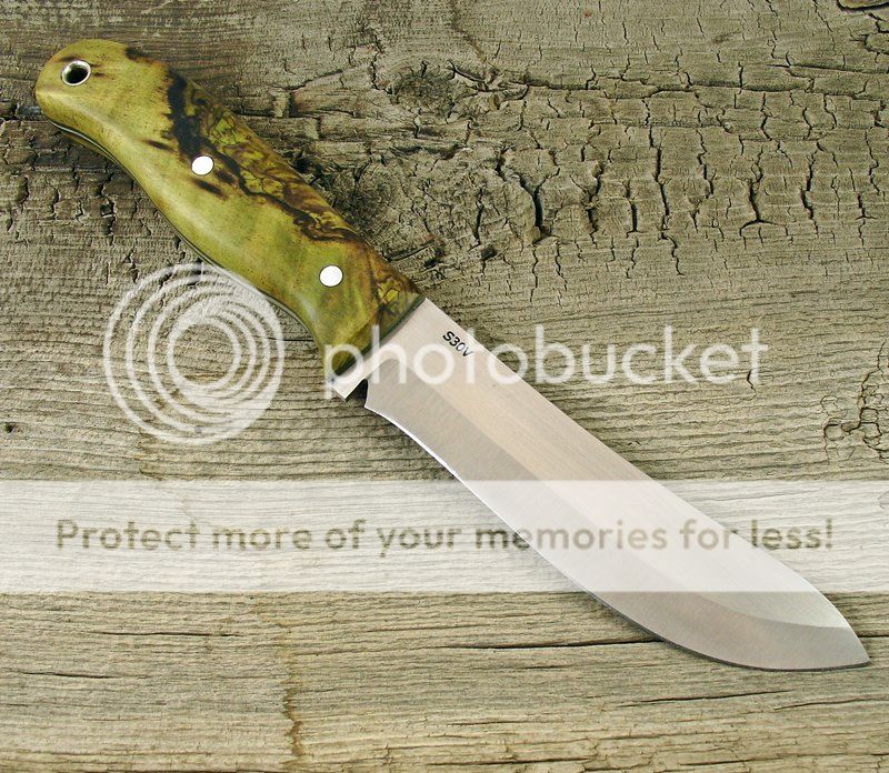

Here's my latest one. It's 9" overall the blade is 4 1/2". S30V stainless steel, stabilized Buckeye burl, linseed oil finish, tapered tang, G-10 liners, Corby bolts and NS lanyard tube. Kind of a Sandi grind with a square spine. Love this S30V......
It tested at 61rc.
