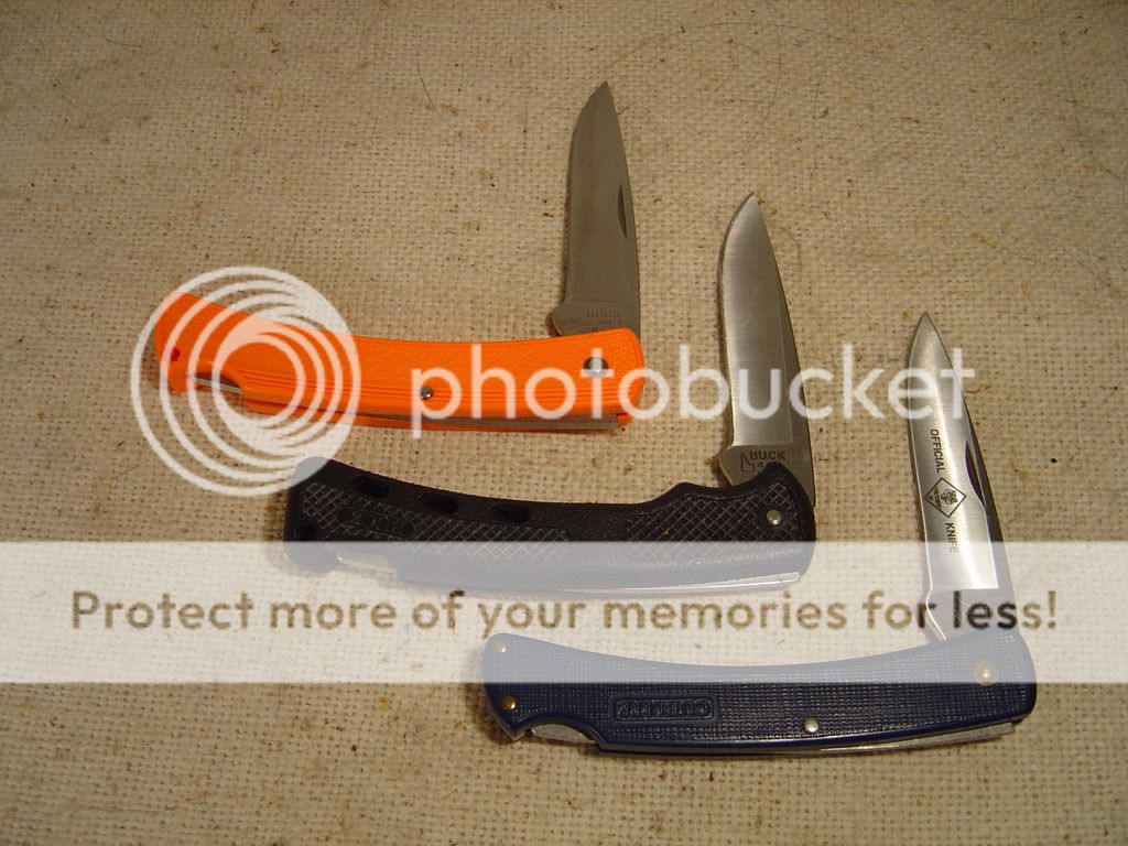

Top to bottom:
Buck 501 (Bucklite)
Buck 444
Buck 414 (Cublite}

Blades on top one and bottom one are identical - save for the markings.
