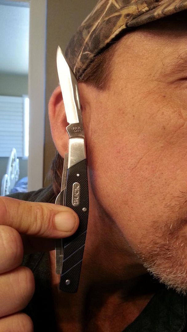

So, I'm considering picking up the new 371 stockman with g-10 handle scales. However I'm not sure about the steel. How does it compare to the 420HC used in the domestic blades (edge retention)? Is there any discernable difference? I will say that it is a sharp looking knife and I really want it but I don't want too spend money on something I won't use

Y'all, are right. I couldn't stand it, I stopped by Wally World before work and picked up the last one. I'm going to use it today at work and I'll report back on how she performs. It is a cool looking knife. A quick stropping brought all the blades to hair whittling sharp. :)
Well, I must say, I'm pleased with my new knife. I used the main clip point blade most of the day and she held up fairly well. I touched it up on the sharpmaker at lunch and brought it back to stupid sharp. I usually have to touch up any knife by the so I would say it's an acceptable steel. All the blades have a good strong spring snap too. And I'm digging the g10 scales. It's grippy! I haven't shaved with it yet though :)
Chris, your leather skin is amazing. If I dry shaved like that it would be a really bad day for me
