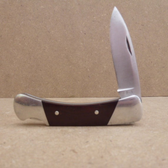

This question comes from a fellow used to flat grinds. What are the benefits of the hollow grinds on Buck's pocket knives (300 series for example). Is there a particular reason why they moved away from their previously flat grind to this hollow grind?
note: this is not my image but it makes the point.
Just to be clear, the top knife is a contract knife and not actually mfg by Buck.
I much prefer the flat grinds and long pulls on the older ones.
Wish it was still this way!
Okay.. well then my question would be why change the grind? and once they did.. do you support their change or wish they would have kept the flat grinds they had before? are there any pros or cons to the new hollow grinds on the 300 series?
Yes, about 86-94.
In my experience, the hollow grinds go through cardboard like butter. Way better than any of my other knives.
Here you go. Think of the contract knives, Buck had to use the basic design of the company they contracted with, to make the knife affordable. Flat grinds were found in both Schrade and Camillus contract 300s because that is what Schrade and Camillus were doing. This dated from 1966 to 1985. Buck took charge of four models in 1986 production, 301,303,309 and 305. Off the top of my head I will say, the Hollow grinding started, on those four models, in 1990 about the same time the design went to all stainless spring models and each blade had its own spring. Some may have dragged in later in 1991. The models (like307, 311, 313, 321, etc) that continued to be made by Camillus were still made using the contractors designs. So, say in 1996 you might have bought a new in the box 307 still with flat grinding, because it was actually being made by Camillus. In my photo pile I have a picture of the changes in the 303 as stuff changed, I will go look for it. But, remember, Buck "itself" only used flat grinding on its late 80's 300s that used 425m steel and had the BUCK shield in place of the knife,bolt and hammer, had two springs and brass liners after that all actual Buck made 300s had hollow grind....The time frame varies a little with the four models, but the changes occurred in the 90's.
300
Flat grind - Contract knife or Buck (301,303,309 or 305) 86 thru 89ish + a couple depending on model.
Hollow grind - Buck made models after early 1990s.

I think hollow grinds do better in materials that self separate as you cut, like rope, meat and CARTA testing gel.
I find hollow grinds tend to bind up in materials that don't self-separate like pumpkin, squash, potatoes and wood (deep cuts). The issue is that the shoulder where the "hollow" meets the flat part of the blade causes friction.
Some of the early Buck hollow grinds like the script 500s have a very rounded shoulder. This isn't my knife but mines looks very much like this.
Note the very soft transition from the hollow to the flat.
I've taken hollow ground blades to the stones to thin and soften the grind transition. Here's another 500 that I used to own (lost) that had a very sharp transition originally. You'll note that the grind transition is no longer straight. What it harder to see is that the top of blade is more angled like a full flat grind.
Buck 500 by Pinnah, on Flickr
I found that thinning a hollow grind like this improves the slicing ability but it's still not as versatile as a flat or convexed blade IMO.
In the traditional forum, people seem pretty split on their preferences between flat and hollow grinds for slip joints.
Given that Buck is first and foremost a hunting knife company and given that they use a hollow grind on almost every knife they make, I think that it's unlikely they would go back to a flat grind on their slip joints.

Yes, there is a particular reason.
Buck changed to their super hollow grind with about a 12° per side edge bevel in about 2000. In the late 1990s Buck did a large project using a CATRA test machine to determine what blade profile would give the best performance. They found that the current blade profile gave superior results. They rolled it out with the name "Edge 2000".
The CATRA machine is a cutlery industry standard machine for comparing cutting performance. You can read about it here:
http://www.catra.org/pages/products/kniveslevel1/slt.htm
Here's the thread from 2001 in which CJ Buck talks about the work that Buck did:
http://www.bladeforums.com/forums/showthread.php/127499-CATRA-Edge-Testing-Results
Unfortunately, the graphs no longer show. But, the upshot was that a BG-42 blade of the previous blade profile was outperformed by a 420HC blade of the new profile.
Personally, I find that a flat grind is better for peeling apples. But the new profile performs better for most other tasks.

Frank, I too find that different grinds do different things better (like peeling apples) but reach a different conclusion.
I think by "cutting performance" you mean the ability to continue making straight cuts and the apex degrades, which is what the CARTA machine tests for. While this is an important aspect of overall blade performance for a particular cutting task, it is only one aspect.
Occasionally (less currently than I like), I find myself sitting and making shavings and the result is a wind spiral. It keeps my hands busy and my busy mind calm when just sitting on the porch or a beach. I find that it gives me a good way to get to know a knife in a way that corresponds to my actual use, since outside of food prep, cutting wood is my #1 cutting task. I find that knives that do well making wind spirals do well working around my property and other wood cutting.
This also gives me a way to try different knives side by each. I'll often work on a spiral with 2 or 3 different knives to see if I can detect a noticeable difference in how they work the wood. I don't have a huge collection of knives, so this is not a huge list, but here are some of the knives that I've used in these side by side tests.

I don't have any pictures of any of my hollow ground knives making wind spirals because I never have been able to finish the job with them. Each and every time the flatter and more convexed blades do a better job and not by just a bit.
In reflecting on why this is the case, I find that the hollow ground knives seem to have a single "bite angle" when they start to bite into the wood and they feel like they continue to dive into the wood at that angle despite my effort to control the depth of the shaving. I had the same problem with factory zero grind Scandi on the Mora when new. This went way for me when I rounded off the shoulder of the Mora.
I *think* the rounded shoulder on the convexed Mora and H-15 and the lack of distinct shoulder on the Opinel allows me to use the shoulder of the blade as an easy to control fulcrum, which makes it easier to control the bite angle. I wonder if a similar thing is happening when you peel apples with a hollow ground blade?

Tme and time again, I can notice a real difference in what sorts of food the different knives seem to be best at. The Buck 110 (and other hollow ground knives) do great with meat but they bind up noticeably when cutting things like onions, potatoes or squash. The flat Schrade and the thin convex Opinel slice much better. A really noticeable difference. Going beyond this, while the superiority of the flatter blades for slicing is huge, the superiority of the hollow grind for cutting meat isn't as noticeable.
I'm not suggesting that the CARTA test is meaningless. Only that edge retention is only a single aspect of overall blade performance. How the blade performs and handles when cutting matters too and what we cut may differ. For food and wood, I find the flatter or more convexed blades to be more versatile but again, this is YMMV territory.
