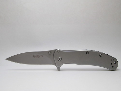

I have a Kershaw Zing that I use as my "gentleman's" knife (always in my pocket at the office, minor cutting tasks, including cutting up some food at lunch if needed).
It's a utility flat grind, and it does the job just fine.
Clip can be adjusted for 3 positions of carry, can be easily disassembled and cleaned, adjusted, etc., has Speedsafe, and the thumbstuds are easily removed.
And the price is right at street price under $20.
It's not a CRK, but if you're expecting THAT for your budget, you may be in for a very long search :-)
