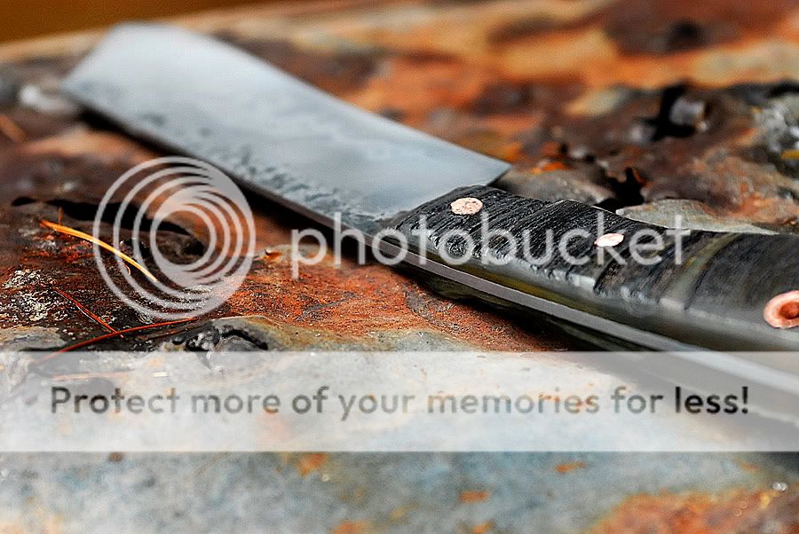

I've been seeing a lot of this style of chopper lately and wanted to try the profile out with a stock removal blade of 1/8" Admiral 1075/1080 to see if I wanted to forge one from my other stock for a heavier blade. I ended up forging this one a bit anyway.. to get some recurve in the blade and curvature in the handle... and the forge marks! But it is basically 1/8" for most of it's length. 9" blade, 2" wide at the waist of the recurve..... a bit wider towards the tip.

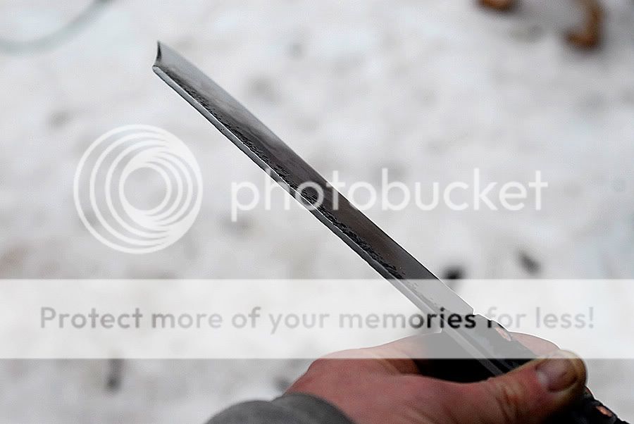

I had the knife 99% done before heat treat and clayed the blade with satanite. This was my first time using a thermocouple in my blown vertical forge and was able to nail the target 1500 ... which I'm thinking offered me up this complex hamon. It would have been nicer towards the ricasso but it looks like some heat got sucked out there. But I'm very pleased with this and am looking forward to doing more of this.... I like the idea of thin, light weight.. but wide choppers with cool hamons.
The handle material is domestic water buffalo from Thailand. I friend of mine sent me a whole box of it. I haven't seen many knives that utilize the outer bark of it... but it sure does provide nice hand-feel and grip.

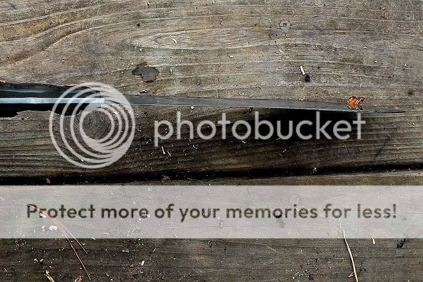

The blade isn't sharpened yet... so you can see how I'm leaving the edge a little thicker in the section of the blade that will receive the most attention when chopping.
Nice. Many choppers have the same thickness for the entire length of the edge. Your approach makes sense. Adds some weight towards the sweet spot as well.
So, that's the natural texture of the water buffalo horn? It looks like intentional grooves or file lines.
Thanks... No that is completely natural. I just sanded a bit with 1000, filed the edges down and buffed after some oil.
