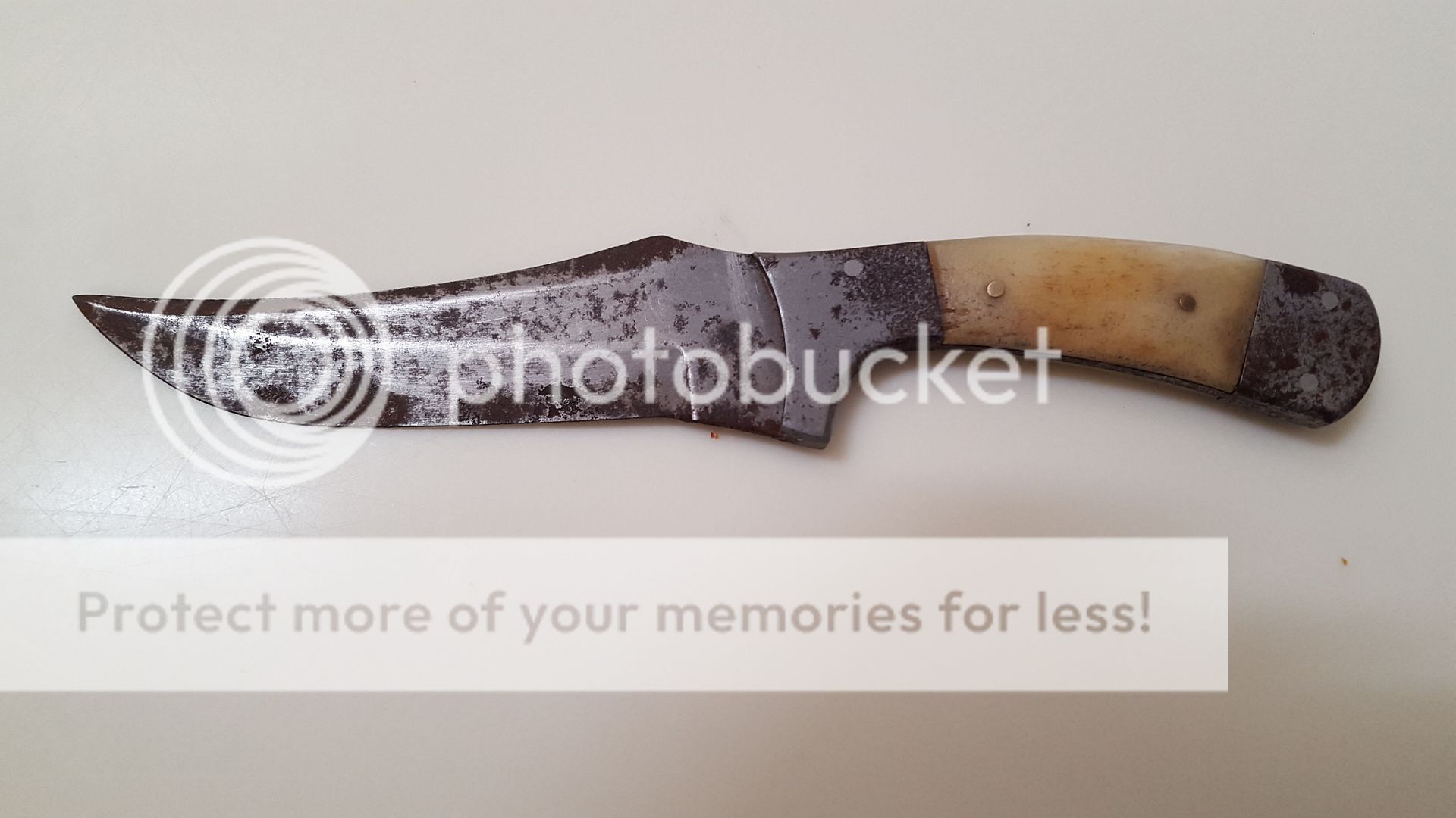

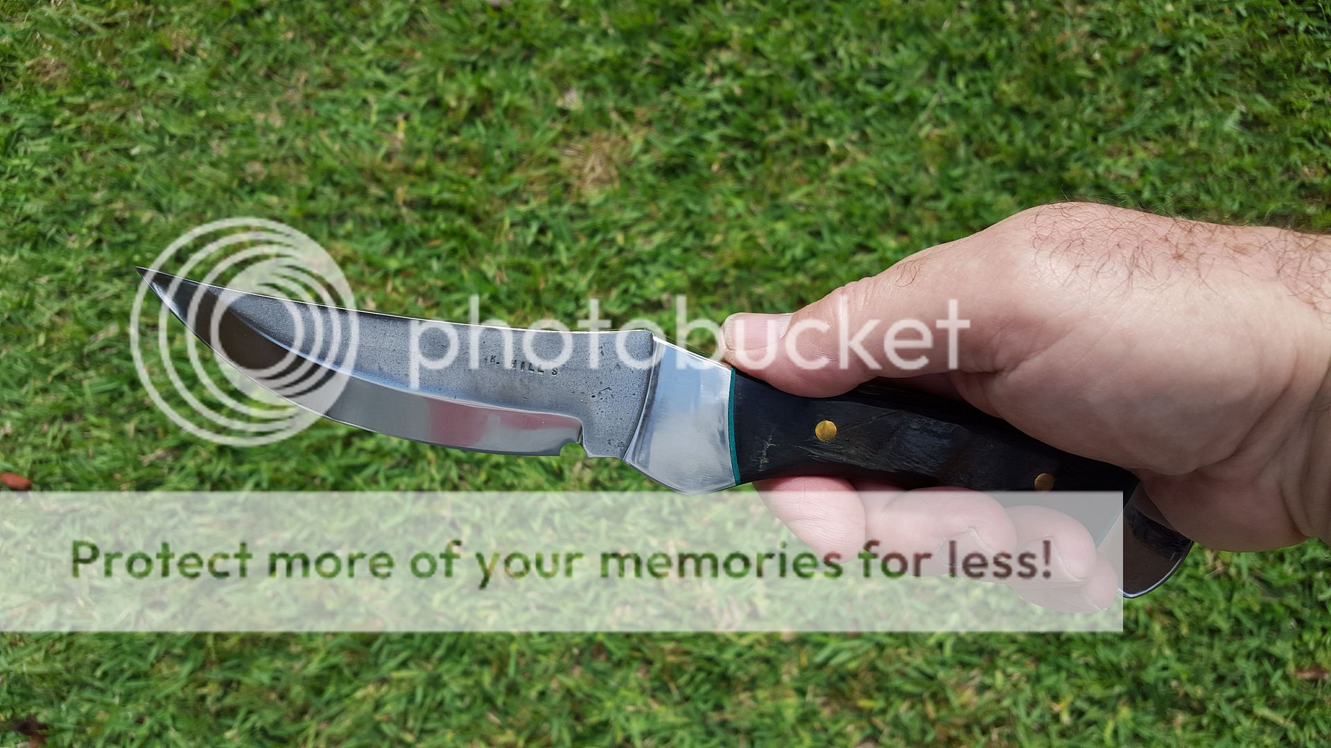

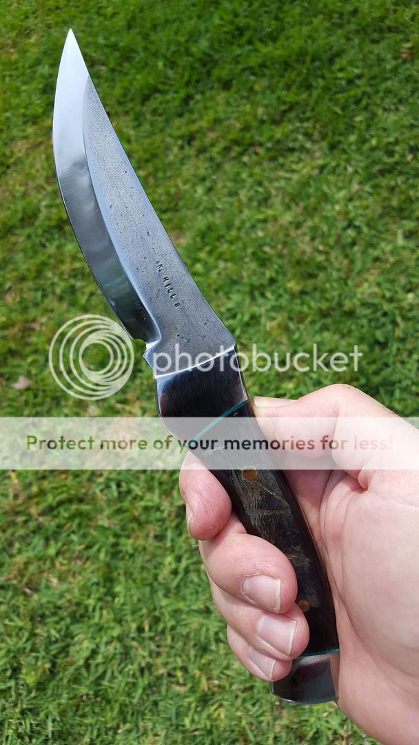

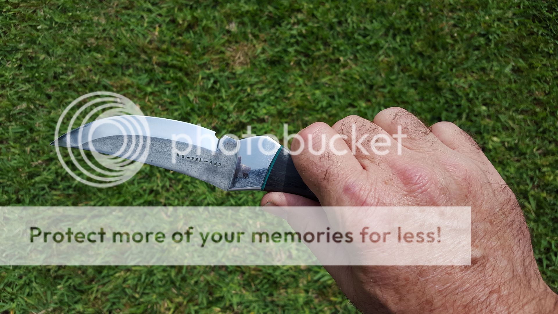

Hi All,

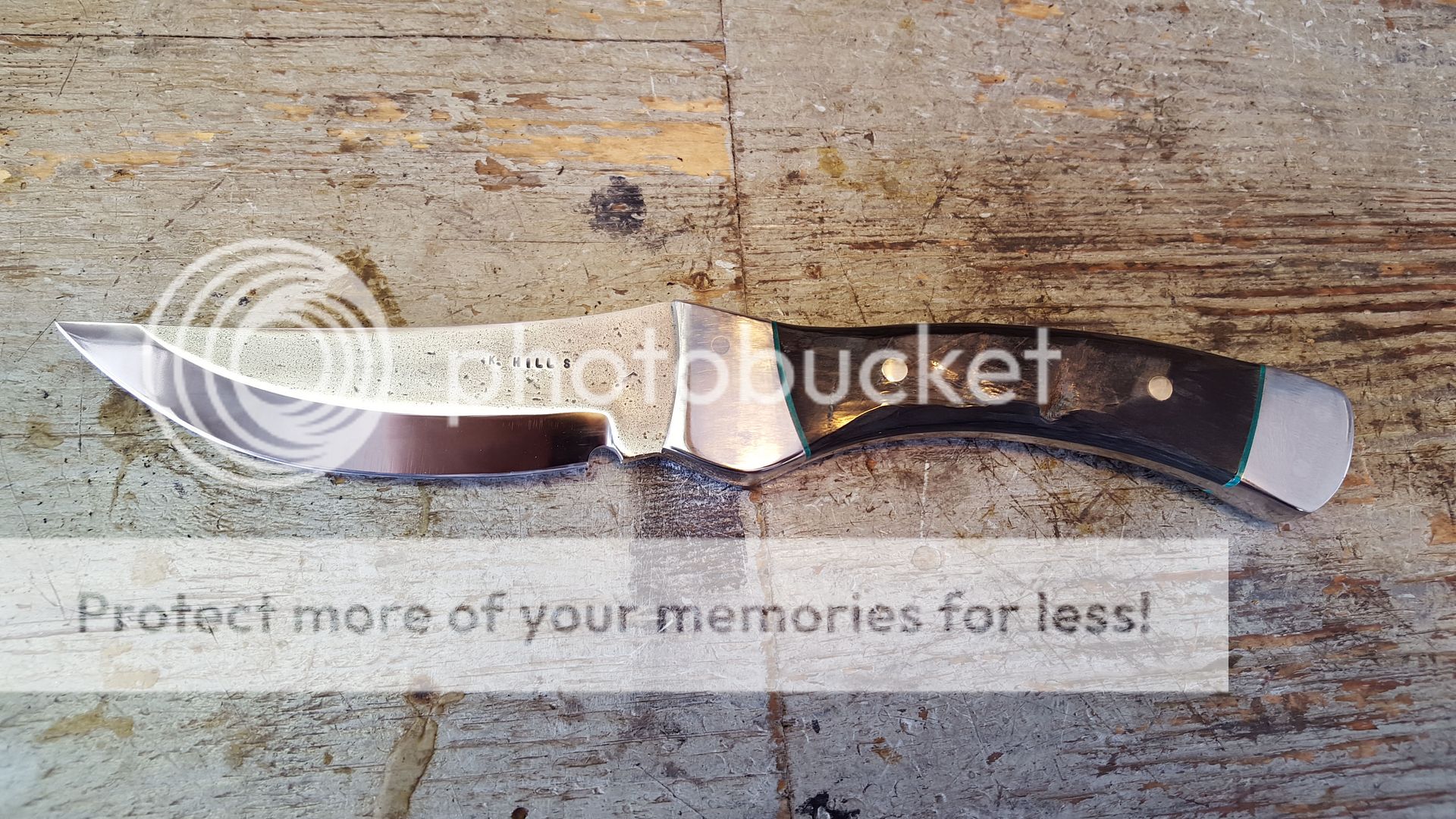

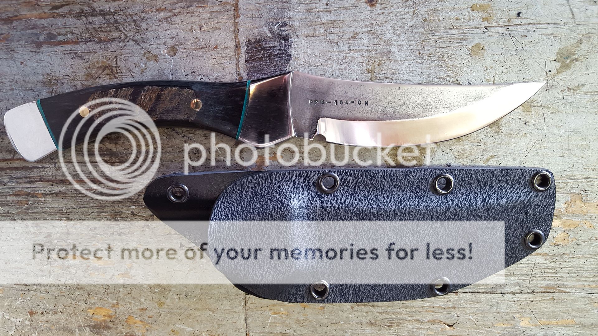

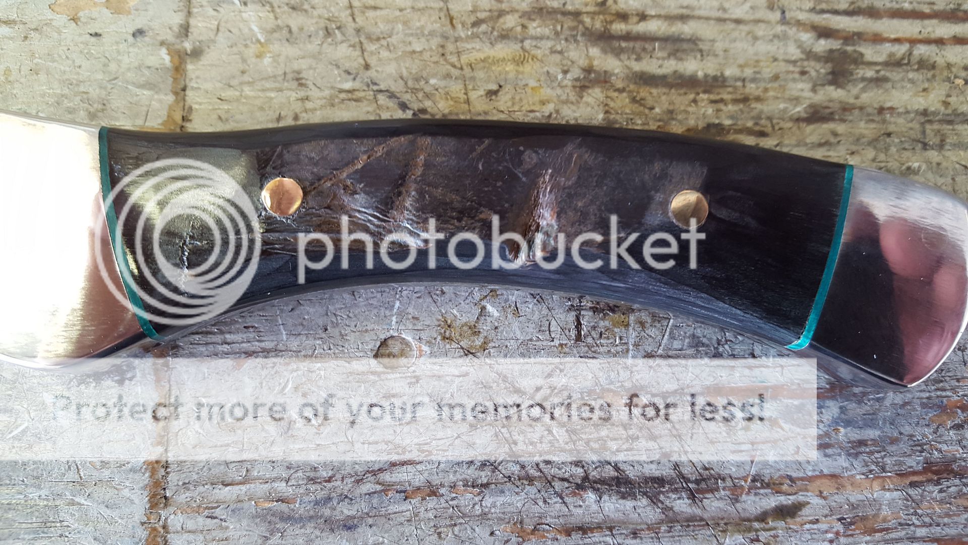

Here is my latest a Buffalo Hunter/Skinner. The knife is modeled after a knife that I own that was made back in the 1850 and used for skinning buffalo. When used as a Skinner it is held edge up thumb on the "bottom" of the front bolster as seen in one of the images. Today it makes a hell of a hunting or camp knife. as well as a skinner. Extremely sturdy knife, good looking too.
Knife Specifics:

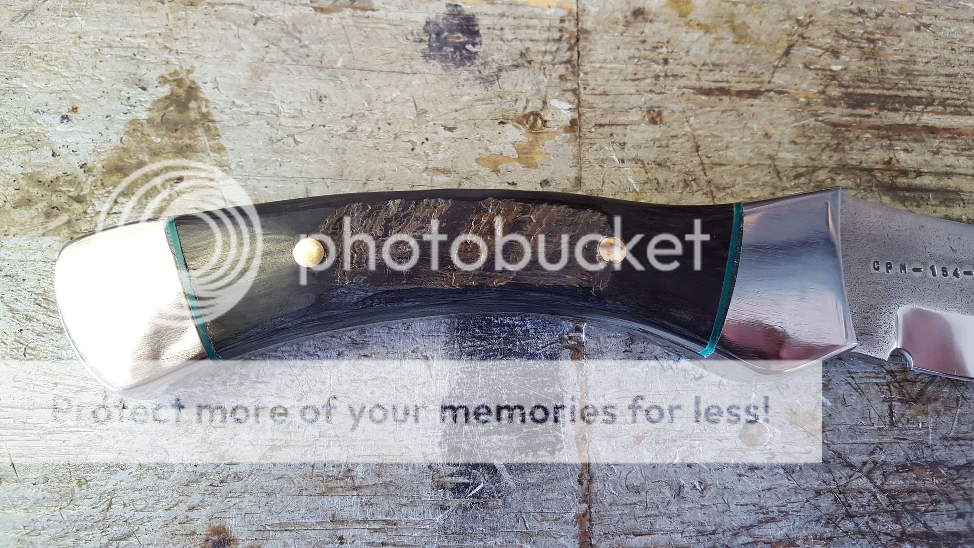

Material: Blade made from 3/16ths CPM-154-CM taken to a Rockwell hardness of 60, Bolsters from 440C, Pins 416 and Brass on the horn. Blade taken to 1500 grit then to a mirror finish flats to 650 then polished makes for a nice contrast.
Scales: Rams Horn with green fiber spacers.
Length: 10.25 inches
Blade length: from the bolster forward 4.75 inches
Width: Across the middle of the handle .75 inches
Weight: 12.3 oz

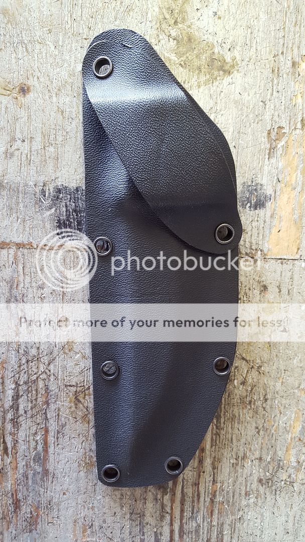

Sheath: Custom made by me from.080 Kydex spacers were used to keep the potential scratching to a minimum.
Thanks for looking and comments are always welcome. Ken
