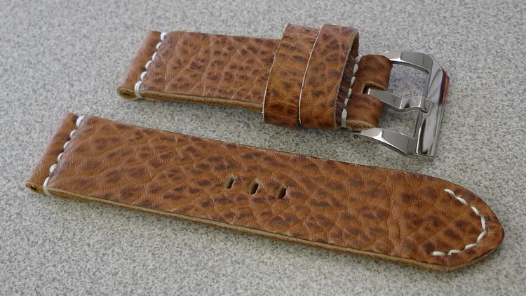

I used some buffalo for straps. Material I have is 2 mm. Not stiff. I need to use a backing leather thats a little denser for added stiffness
Don't touch elephant. Did sell some rhino leather straps back in 05. Also a touch soft
Here's a strap I did to test out. Simple stitching to check overall wear strength. Working on another with full stitching
