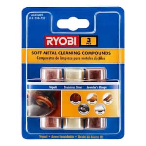

David, I bought a Ryobi pack yesterday, that had three sticks in it. Red, yellow, Red. I was Tripoli, the yellow is "For stainless/hard metals, and jewlers rouge. Have you seen these? Any info? Thanks, Josh
Haven't seen or tried those yet. Are there really two reds in that package?
Edit: Is this the package you bought? I guess the 1st one (Tripoli) might be seen as red/brown; it's often described as 'brown tripoli'. The other 'red' one (rouge) is likely iron oxide, and may not be too useful for knife blades. I'm guessing the yellow might be a blend, maybe aluminum oxide and something else; might be OK for knives. Based on the quoted description from Home Depot (below), the Tripoli might be too soft for steel as well.
Tripoli compound helps clean soft metals and plastics
Stainless-steel compound helps clean and shine hard and plated metals
Jeweler's rouge helps to clean and shine solid and plated silver and gold
David
Jeweler's rouge is good for shining up bolsters :thumbup:
(a little messy, though.)
David, that is exactly what I bought. So I guess the only one worth a nickel is the yellow. It seems to work nicely.
May not hurt to try the others as well, maybe with some basic steels like 1095 or Case CV. They might have a tougher time with higher alloy stainless though. I don't have a lot of confidence in the red rouge (never been able to get any good out of it, on knife blades), but having not tried the Tripoli, I don't know how it compares.

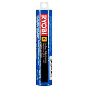

HH, just wondering which Ryobi 'black' you're referring to? The black 'emery' I'm using from them (referenced in my earlier post) is labelled (on the tube) as 1-3 microns in size, as opposed to the 30 microns you've mentioned. Seems to polish very easily, so I'd assume the particle size isn't too large.
This is what I've got:
David
David, I don't know if its the same - here's the pack mine came with
If its 1-3 micron, it clumps to make considerably larger, durable pieces. The average size was much larger than the particles in their yellow, and the stuff in their white was half that again. Their black emery, broken down, was comparable to Sears and Dico, neither make any claims re particle size. The chunks were much larger than the depth of field of the microscope, approx 2-3 micron at that magnification, and larger than the toner particles from the print engines, 5-6 micron. If I can find my chunk at home, I'll redo this and see if I can get a more accurate number.
Thanks HH. :thumbsup:
Wouldn't be surprised if it's clumping, if mine is the same as what you looked at. That's my biggest gripe with it, as it's pretty stubborn stuff to use 'dry' as a crayon, except if applied at very light pressure. Leaves some big chunks if scrubbed too hard on the stropping surface.
David
