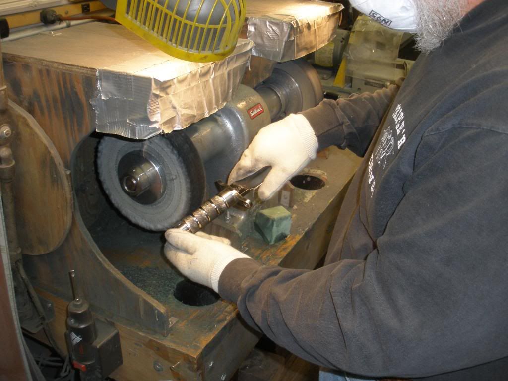

Do you need more pictures....

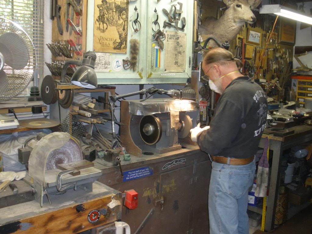

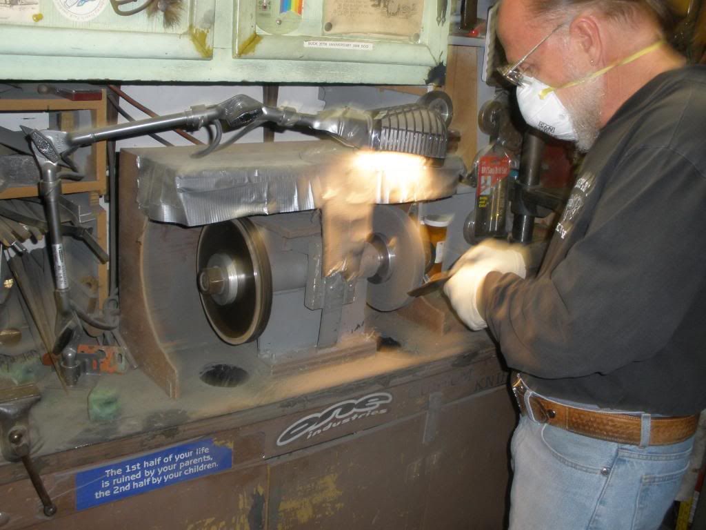

I thought that said Edelbrock on the grinder....LOL yeah "supercharged" its an eastwood ..... Is there a vacum under those wood hole cut outs? or does it just drop into a pan? cool pixs.
I have been experitmenting with all theses different grade's/grits scotch brite type pads....so far I like them for some applications on metal....
My interest in the vacum was when I first got my buffer I tried to use it in my art studio/gallery "I'm fine art painter" an that I soon found out working the buffing wheels with the compounds that I was getting bits of cloth an a definite compound residue all over my curtains an floor an woodwork, LOL now its going out into the garage or on my deck on nice days....LOL
Yes, thats why he has boxes over it with a vacuum. As this eliminates much of this debris. DM
thanks for answering VAC question, and about the boxes....DM
I need to build 3 boxes for my buffers a grinders....to keep the debris localized or my wife will kill me... LOL :)
