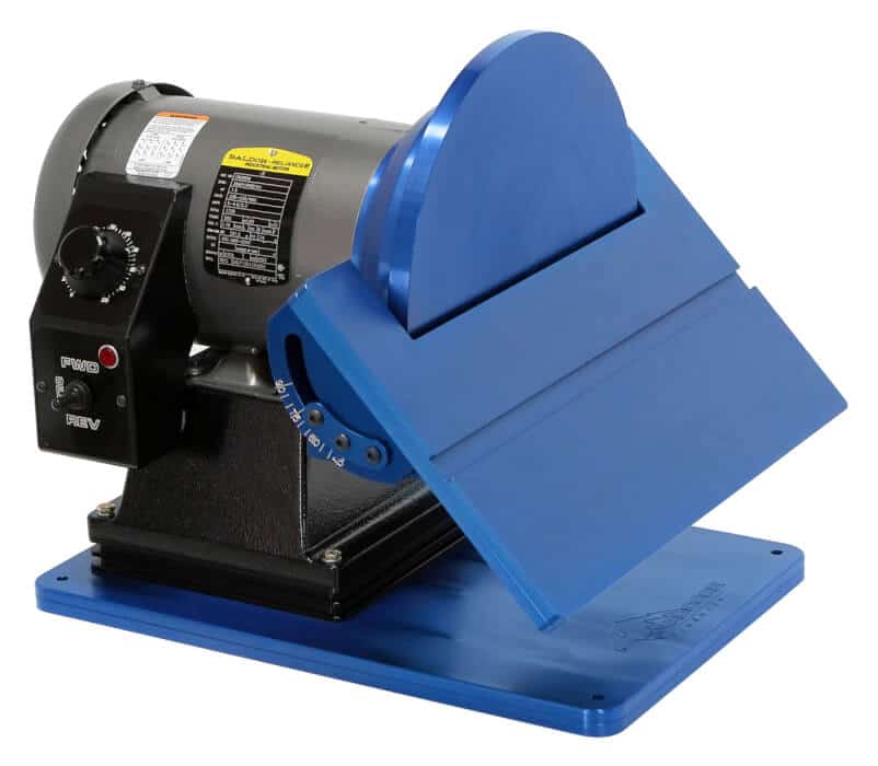

Make or buy a standard tool arm grinder. Make a separate disc grinder. Look at the True Grit and Beaumont disc grinders for ideas. You want VFD on both machines. One VFD can run both. A 1.5HP to 2HP 3Ph motor on the belt grinder and 3/4HP 3Ph on the disc is a good size.

One reason is that teh disc grinder will be situated at a position you can't alter. A dedicated grinder can be placed on the edge or end of the bench. Also, combo units just don't work as well as dedicated units.
For a hobbyist, a combo machine may work OK. If you want to get into knifemaking more seriously, you will need a better setup with separate belt and disc grinders.
My advice is always to buy or build the best machine you can. It will last longer and probably do a better job than something with compromises. (It will also be much easier to sell if you get out of the hobby or buy/build bigger equipment later on)
You can buy the disc grinder table assembly as a kit from Beaumont or True-grit and add your own motor/VFD. Same for a good grinder. The Reeder basic kit is really a bargain for a top-notch machine. For around $2K you could put together a great belt grinder and a great disc grinder running off one VFD.

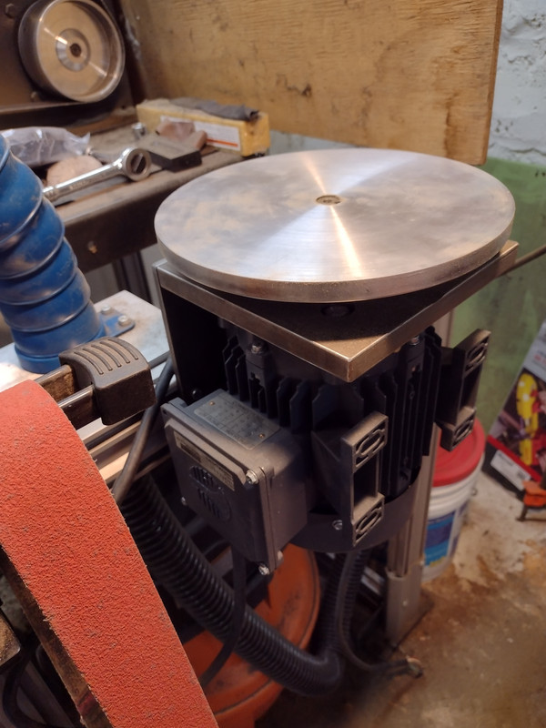

Something to think about having separate machines......
I have a Pheer 2x72. Love it and I recommend it.
I also am building a disk grinder.
I hand grind/sharpen my knives on bench stones.
I'm going to mount my disk grinder horizontally, so my body dynamics stay the same. Idk if that could be done on a combo?
I can't find the pic now but I've seen a disc sander attachment for a 2x72 grinder.
It was as if you were using the side of a contact wheel as the disc sander.
The big plus is that you can use the VSD of your grinder.
