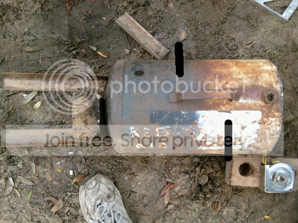

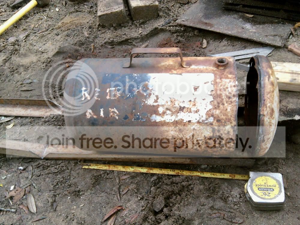

I'm getting prepared to build a small forge. This is an old spare air can. It is about 17" long from opening to end of the tube and about 10" across. Under it are a couple of pieces of old bed frame angle iron. I want to weld or braze them there in place. Then bend the back sides up 90 deg to make a frame for holding brick.
I have one burner made and working, I think it's a 1/2" burner. I made it a few years ago. I have another burner still under construction, think it's a 3/4". I was thinking about rigging the forge to accept the two burners so I can use just the one or both if need be. I have seen pictures of forges with two or three burners off on the same side, but never one on each side.

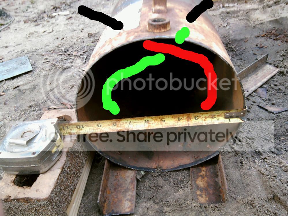

3)Burners-- In the pics I did a little drawing on them, the top view pic, I was thinking about putting the burners in like this. One on each side spread
apart about 4 or 5 inches. In the front view pic, I was thinking that if at the correct angle, one flame would swirl clockwise while the other would go counter clockwise. Think this would work ok or should they both be on one side?

5) Should I weld on a hinge and keep the front part I cut off as a door? Cut a slot in it and put refractory in the cavity? If you think I should connect the top back on, I was thinking about having the hinge on the side. See any problems with that?

top view, pipe placement
front view
side view w/ lid
On the rails, you can just clamp them in a vise and bend them.Since you have oxy-acet just weld them on with it.Get a can of flux and steel welding rod and weld them up.I've even used coat hanger for rod.
You can put the front back on or just stack fire brick in front of it.The hinge on the side is not a problem.

I don't see much benefit of having the burners run opposite. It will be more tidy to have them both come in from the left.
As for the frame rails- yep, bend 'em cold, and as Stan says just weld them with the torch. You do not need flux to gas weld with- coat hanger would be fine here, and the flame by nature keeps oxygen off of the weld pool.
I've built them with hinged doors front and back, and with just firebrick stacked. While insulated steel doors work well, right now I have brick doors. They are easy to rearrange as necessary so that I have a big enough door to work through, but not too big of a door, which will be inefficient.

Place a fan on the table and let it blow a ribbon. Now place two fans on the table, side by side, and let them both blow a ribbon....Good,more air. Now, place one on the table and place the other facing it....Bad,the ribbon won't blow very well. This is called turbulance, and you don't want it in your forge.
Have both burner flames going the same way.

Burners should be 10 to 15 degrees off of top dead center 4 inches apart. a 1/2 burner will work well for 60 cubic inches, a 3/4 burner will work well for 300 cubic inces. Your tube if lined with 2 iinches of Kaowool back and sides might be around 360 ci...If two burners were used put them 4" apart. Another good forge resource is Ron Reils sit or Larry Zoller( just googl them)
