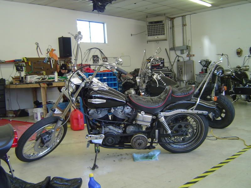

Picked the bike up several months ago. Rebuilt motor and some other bits made for an ok running bike but rather ugly in my opinion. Didn't sit right, miss-matched parts, Linkert carb, new model shocks, belt drive open primary- it was a parts pile. It's an FLH (numbers match) that the PO converted to an FX style bike in the late 70's.
How I got it:
Starting the tune up/going over while I start deciding on how I wanted the bike to look:
Decided I wanted to go back to an FLH so I started looking for parts. I considered stripping the bike down and doing a in depth restoration but decided against it. A dirty, bar hopping bike was what I was after. As it was already dirty and surface rusty with the paint being not so great.....I was already on the way to what I wanted. Guess the bike came around from being lazy more than anything else.:o

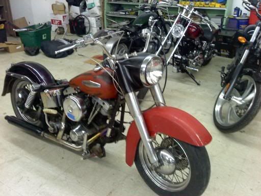

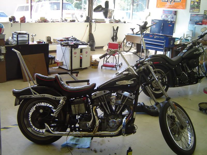

Found a complete front end:

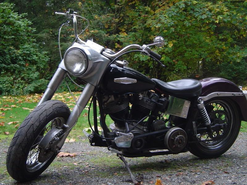

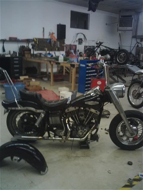

Next was rear fender, seat and exhaust. I cut the stock tail light bracket out of the hinged fender and added a tombstone tail light. I didn't like how the fishtail looked or sounded so I added a Screaming Eagle muffler. It has since been changed again but more on that later. I also added a Paughco horseshoe tank to replace the stock tank and battery box.

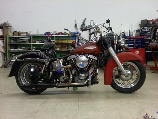

This is how the bike sat as I decided on what I wanted to do next. Not a bad looking bike (to me) but it wasn't quite "done" for me.

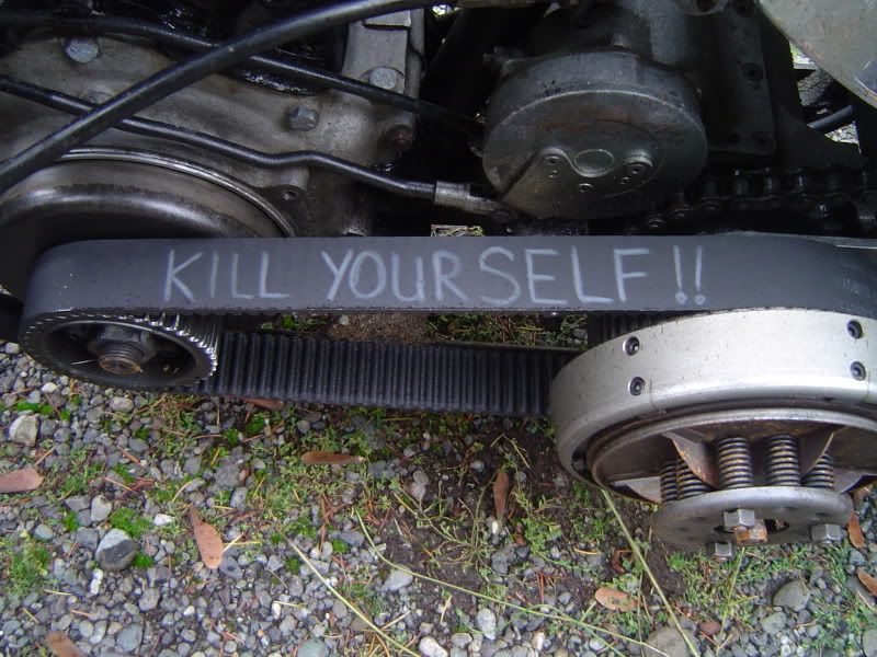

Added a grease pencil motto to the belt:

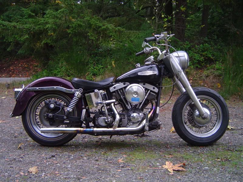

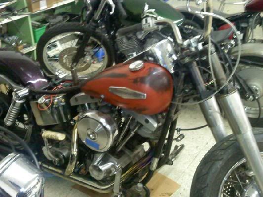

Maybe I should have left well enough alone but the paint was bugging me so out came the sand paper. My original plan was to scuff the tins and shoot in satin black for a greasy look. As I was sanding I got down to the primer in a few spots and an idea hit me. So off to the parts store for some red primer. A light coat of primer and various grits of paper to knock it down produced this look. Is it an original "barn find" set of tanks? No but I'm pretty happy with the outcome. Tanks are OEM 3.5 gallon tanks (have straight down cross over tubes)
Here they are mounted on the bike

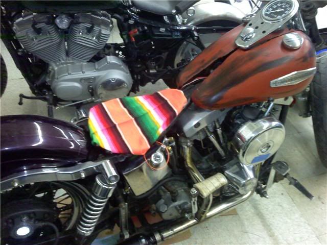

Next was the seat. I have a factory two up, the corbin solo saddle and I just picked up a pogo assembly from a buddy to eventualy run a solo tractor seat. Can't have enough seats I guess. And this leads me to the latest project.......another seat. I have had an idea to make my own seat for a while. I haven't ever done this before but I'm a pretty handy guy so..........
I searched high and low all over Tacoma looking for a sarape (mexican blanket) After much searching I found what I wanted. Made some measurments and matched the seat tin up to the frame.
Rough mock up fitted to the frame.
Got some more done today. I still need to pull the rear fender for paint and button up a few more small things. There's a ton of small things I've done to the bike that I haven't mentioned here but there's a LOT of subtle things/improvments I've done. I also added a beautiful early 50's Harley "Mellow Tone" muffler as well.
In a World of "McChoppers" and show queens, I wanted something different. I hate cookie cutter bikes. This is my idea of a Rat Rod on two wheels. Might not be everyones cup of tea but........I did it my way.
