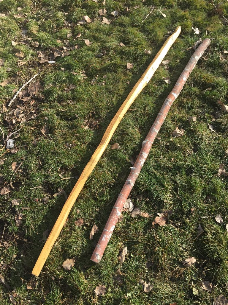

Ok, here we go! I've to Osage on the left, and Vine Maple on the right. I cut the vine maple from the Hood River area about 5 months ago, and the Osage is the same stave from my last bow making thread. I've taken a bit off of it, but haven't done much to it really. Just have to decide which one to start first!
Ok, here we go!

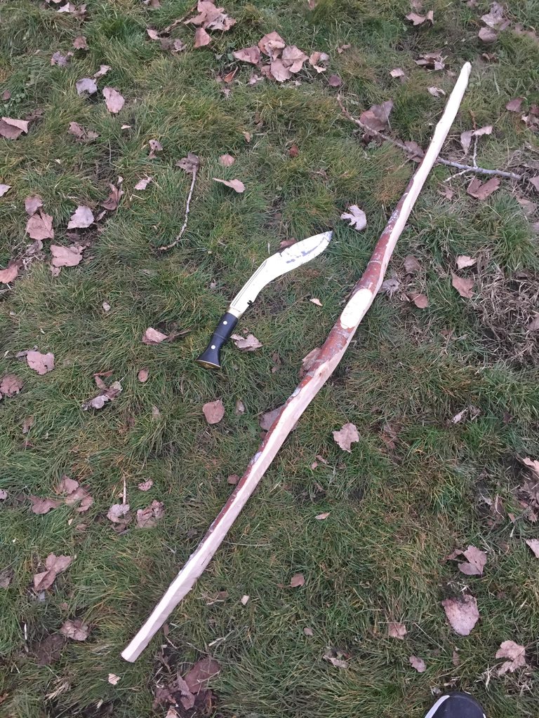

I've marked out the center of the bow. Once I've done that, I grip the stave about an inch below center, and mark roughly where I want the handle and fades to be.

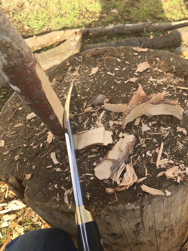

Now, I start removing wood from the belly side from the tips, working towards the handle.
I'm working up towards the handle section.
That's about what I've got for today. It's a good stave, so at this point I think any failure will be my fault.

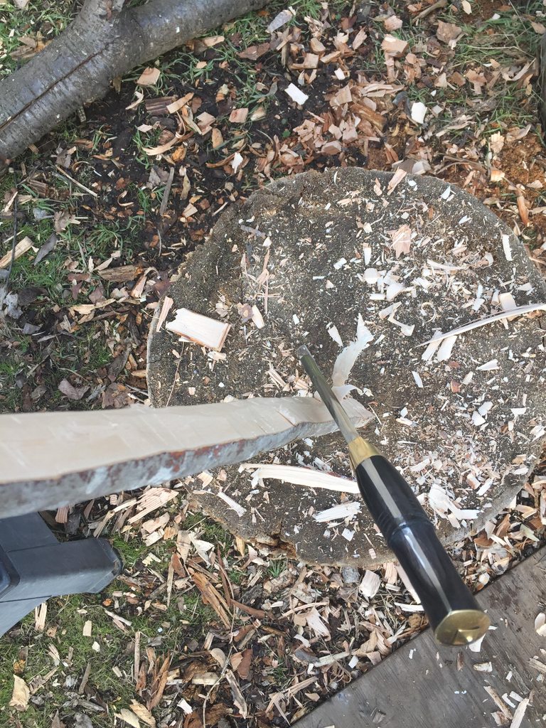

Luckily it seems like there are a lot of good directions for turning this stick into a bow-like-object. I'm going to taper down to 1/2 inch at the tips... This is very exciting, nice straight grain and thick rings.
Something like a 'triangle bow'? or is it pyramid bow I forget.
This is a good reference for me so far:
http://poorfolkbows.com/oak.htm
This is exciting, seems a lot better than my last attempt already.

You found a great reference there! Follow the instructions verbatim. I wouldn't call that a pyramid bow, rather, a traditional
American Flatbow. It even shows you how to back it with fiberglass tape and Titebond II!
