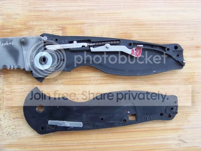

Here is the inside of a SOG Flash. It has a coil spring behind the blade that you can't see in the picture. One end of the coil spring inserts into a hole in the blade, the other end into the handle scale. The entire coil spring sits in a recess in one scale. If you take one of this type apart, do so with the blade open. When closed the lockbar and spring are in compression, if you pull the knife apart both pieces will fly across the room to never be seen again. Also be careful pulling the blade from that scale as the coil spring has a tendency to shoot out as well.
The scale with no blade holds the slide bar that is used to unlock the open lock. The detent ball is to hold the closed lock in the locked or unlocked position.
