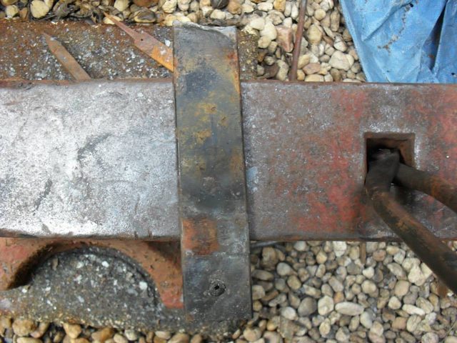

This is the initial piece of metal I started with. 3/16th" 5160.

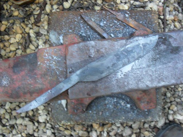

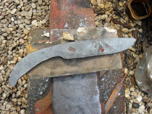

Initial blade shape formed out.

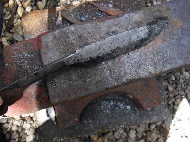

Tang drawn out.

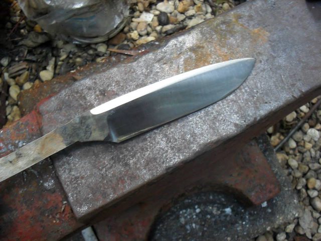

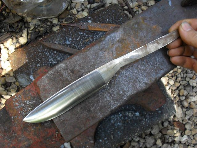

Started my initial cuts with a Flat grind on edge and spine.

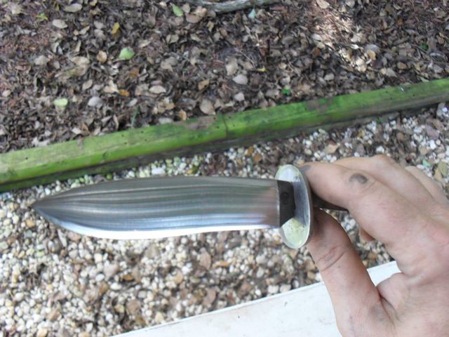

Went from the Flat grind into a convex.

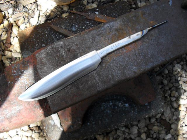

Cleaned up my tang and cut my shoulders.

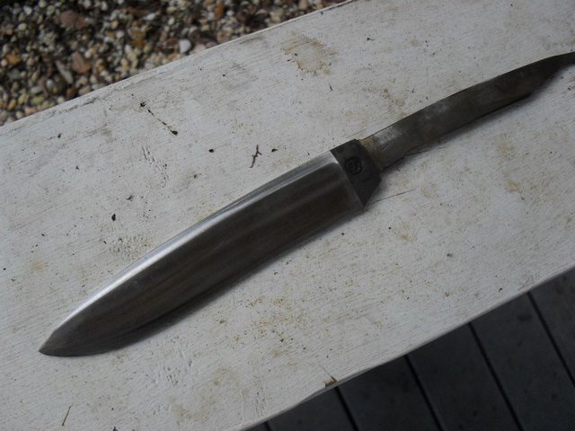

Fresh out of the quench.
Cleaned up, ready for the guard and handle.

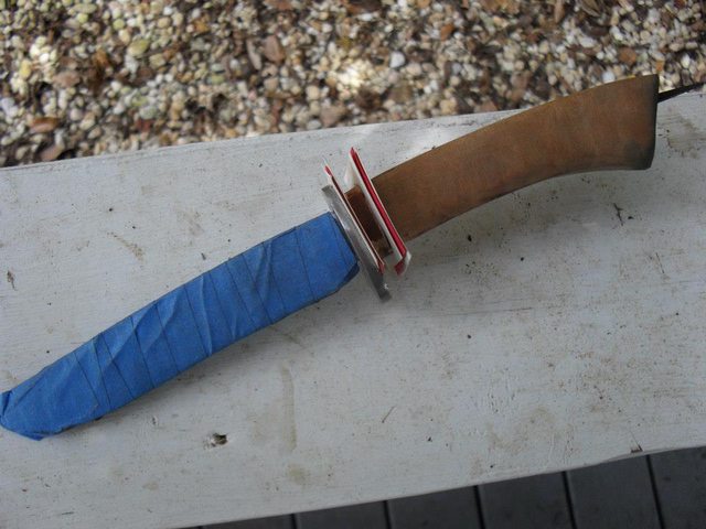

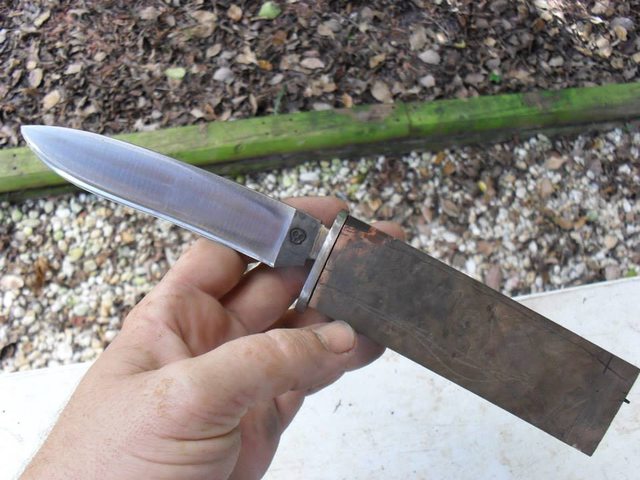

Handle of Madrone burl was burn fitted during heat treat for a no wiggle fit.
The initial fit up before peening the handle in place.

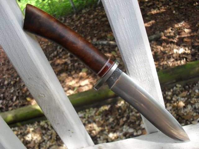

Finished up Classic Hunter.

It is, I got a chance to play around with it while skinning out a hog last week. Most knives have a secondary grind, but this blade was convexed into a single grind, which made it feel like I was cutting butter, while processing that pig.
