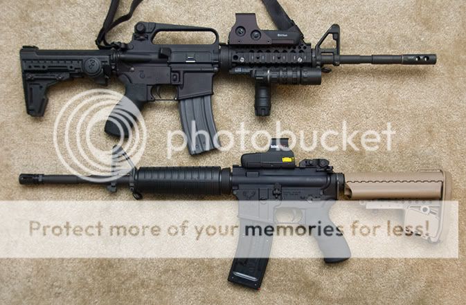

Even though I'm not the original poster, I'll jump in since I just built a lower the other night:
The rifle on top is a Bushy I bought complete and have added crap onto over time (it was a pretty bare-bones neutered rifle purchased during the ban). It's nothing special, but it runs great, even on crap ammo. The EOTech on it will be moved to a third rifle I am building: a Mid-Length flat-top (just waiting for the upper to be sent to me)
The rifle below it is on the lower I just built. It is a Stag lower with DPMS parts kit. Hanguards and an ERGO grip in brown/tan/earth (whatever you want to call the color) are in the mail to me so it can be fashionable and match the stock :p
The lovely black ERGO grip will be moved to the upcoming Mid-Length build (don't you just love swapping parts around?)
The upper is a dedicated .22lr upper from Tactical Solutions, hence the Black Dog mag.

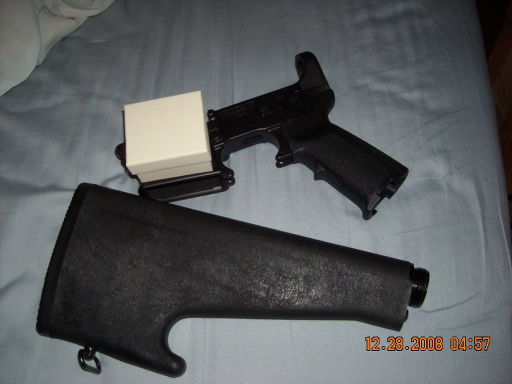

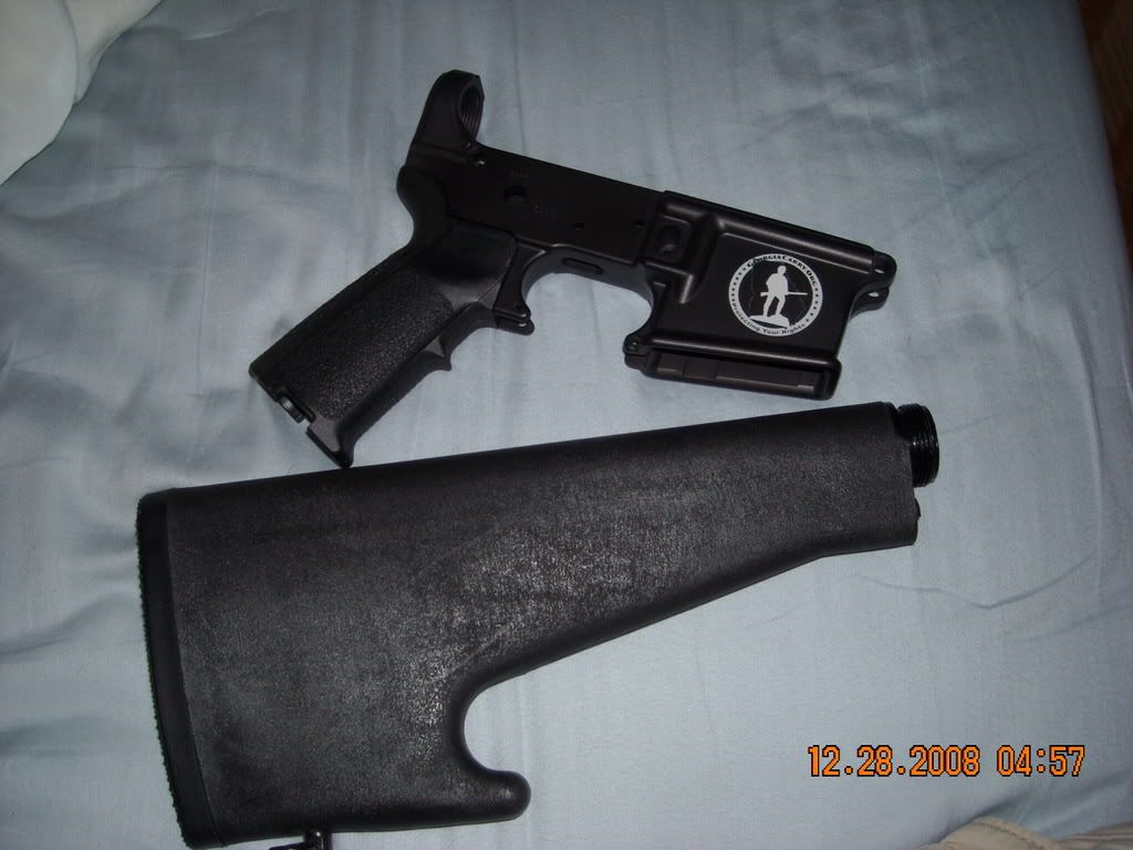

Damn that was easy! its like 95% done, all thats left it to put on the stock but i think i need another part. i will post pixs later.
