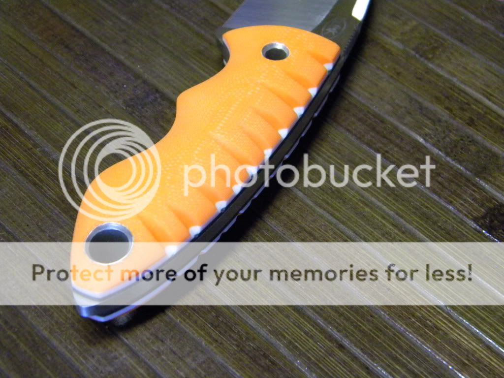

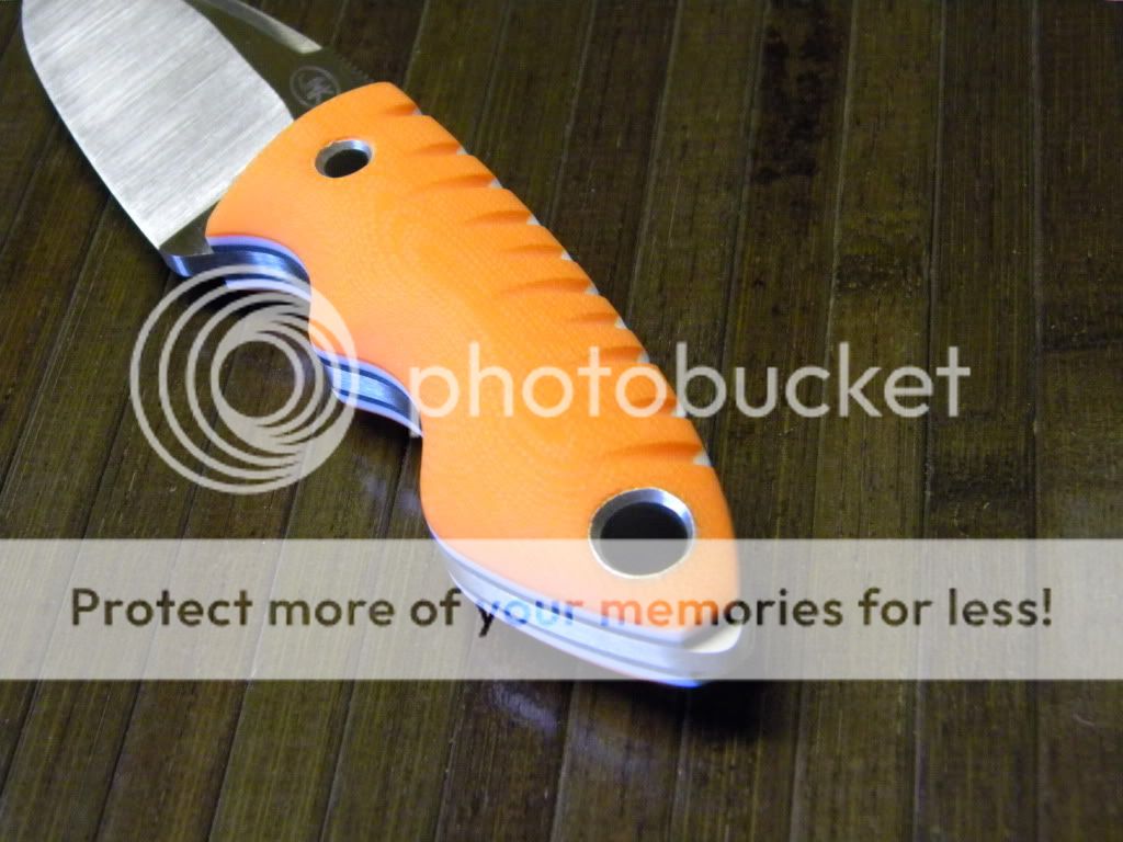

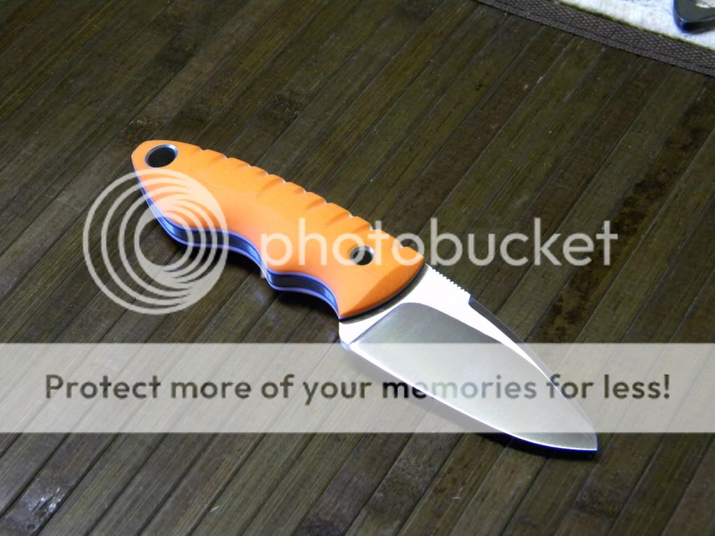

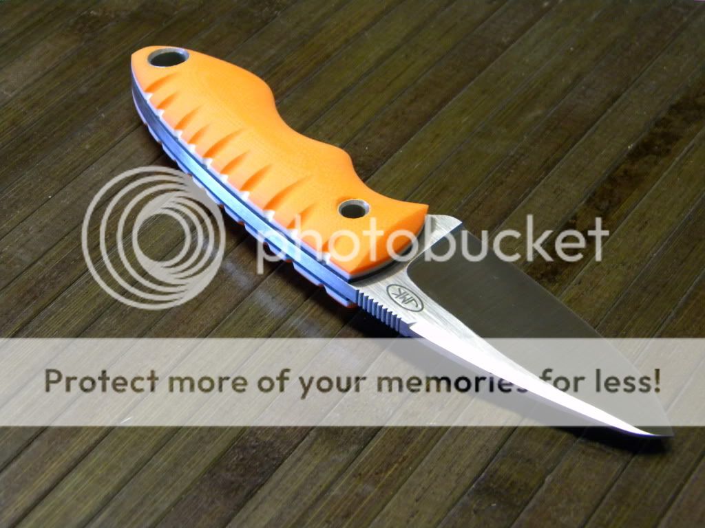

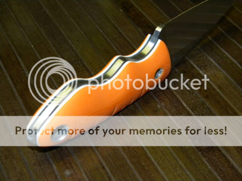

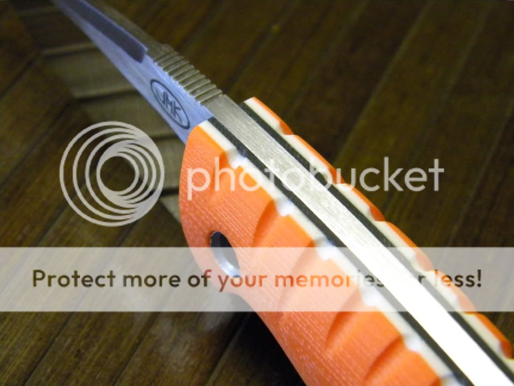

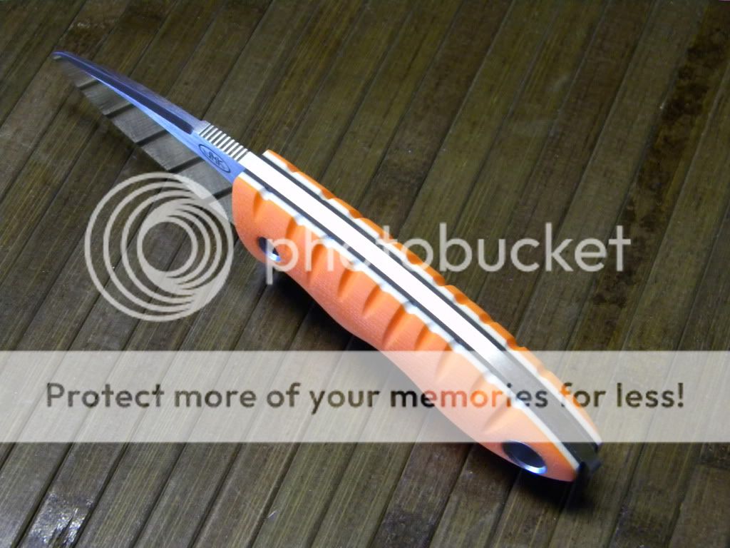

Had a forum member here request a Mini Drop Point, but with a bull nose tip and a small amount of exposed tang. He also wanted a handle inspired by Koi fish made from orange, white, and black. This is what I came up with, made from 154CM flat ground with a swedge, heat treated to 59-60 rc by Peters, with a bead blast finish on the scales.
Thanks for looking!
As allways from you, nice clean work. A beautiful little knife.
Gody
I get the Koi but looks more like a really cool creamsicle theme to me. Great looking work as usual Jonny!
Eric
Thanks guys! This one was a challenge at times, but they're all fun to do. Glad you guys like it!
