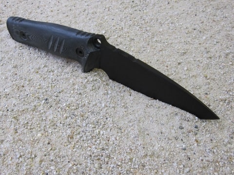

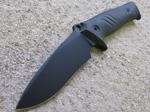

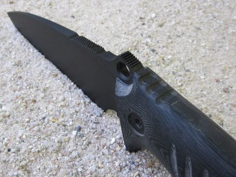

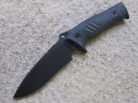

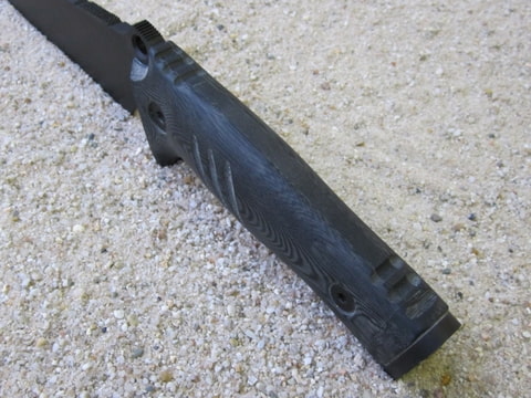

Ready to receive a sheath, a Bull Shark M, fully dressed in black.
Steel: O1 (selectively hardened)
Coating: Gunkote black
Grip: Black linnen micarta with rubber liners
Pommel: 5mm O1 hardened and coated
Bolts: M5 en M6 hex
Will come with a Martin Sheath kydex housing.
I have handeled this one this weekend and I can assure you it's as nice and well built as it gets!

you already know what I think but I'll say it again, it's a terrific knife!
engineered and built for the hard work, loves
Congratulations my friend for this job

Thanks guys, really appreciate it.
I'm pretty happy with the design so far. Always looking for ways to improve, but overall I think it is where I want it to be.

Very fine knife,looks very solid and made to be used(and abused?you know who I'm talking off)
I would'nt like to meet a bull shark when I'm diving,but I'm looking forward to see this one at the DKE knifeshow.

The lanyard hole, is the hole in the middle of the blade ;). That spot is used by blade sport knives. Its works really nice, because if the blade slips out of your hand you still have control over it. So i cant dangle on your wrist and end up in your leg :D.
