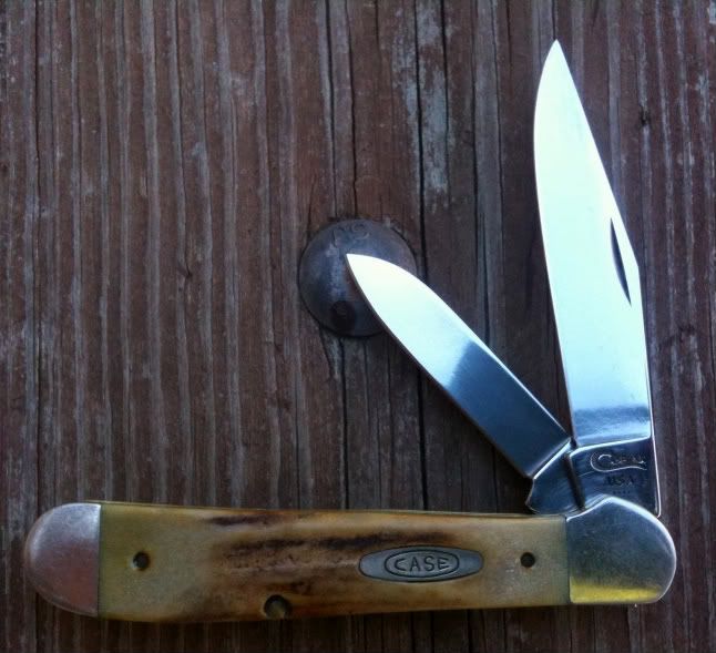

I prefer the Case Lg Copperhead, myself. I like the combination of a large clip and big pen blade. The pattern is currently "in the vault," but they are still available if you look around.
That Bulldog is nice, though.
I like the large blade/pen blade combo on the Case as well. I just kinda favor the other handle shape just a touch. On the whole, I like them all. - Ed
