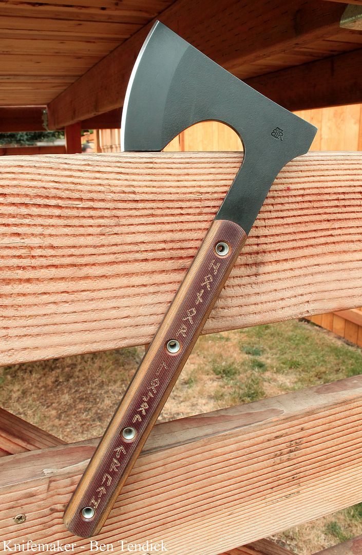

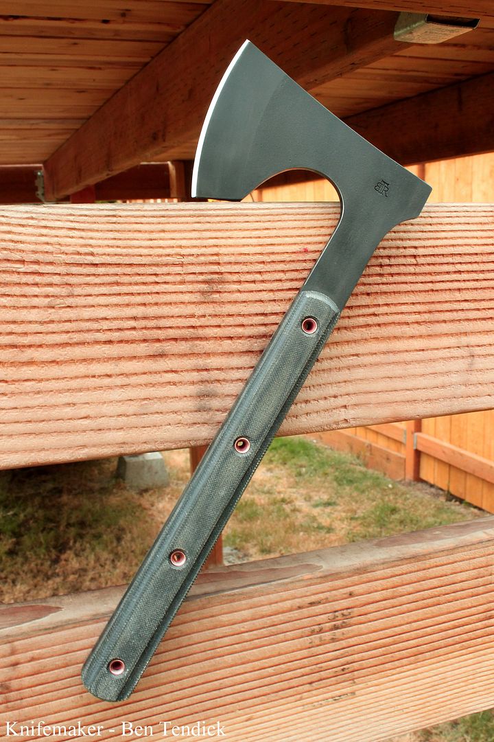

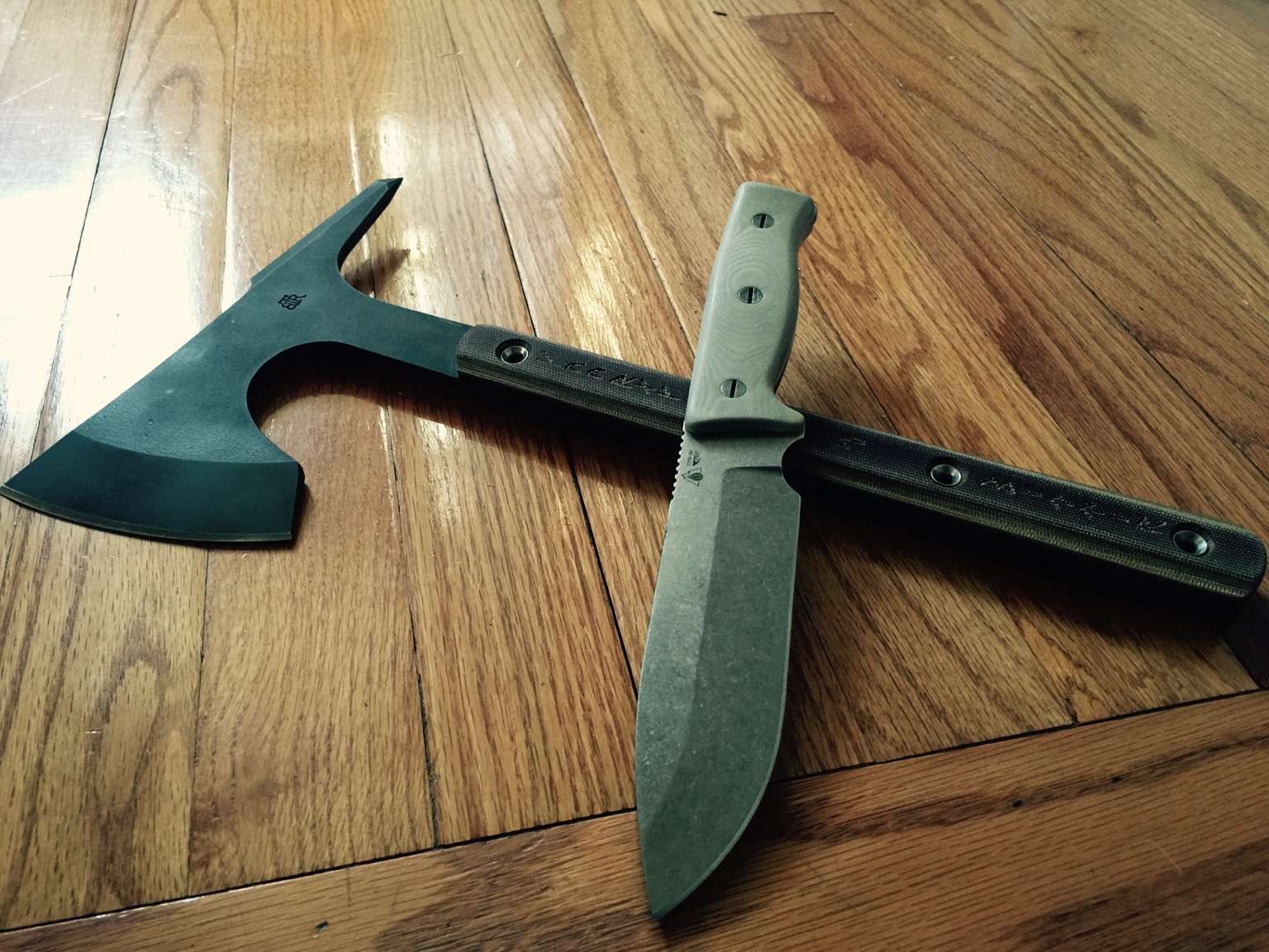

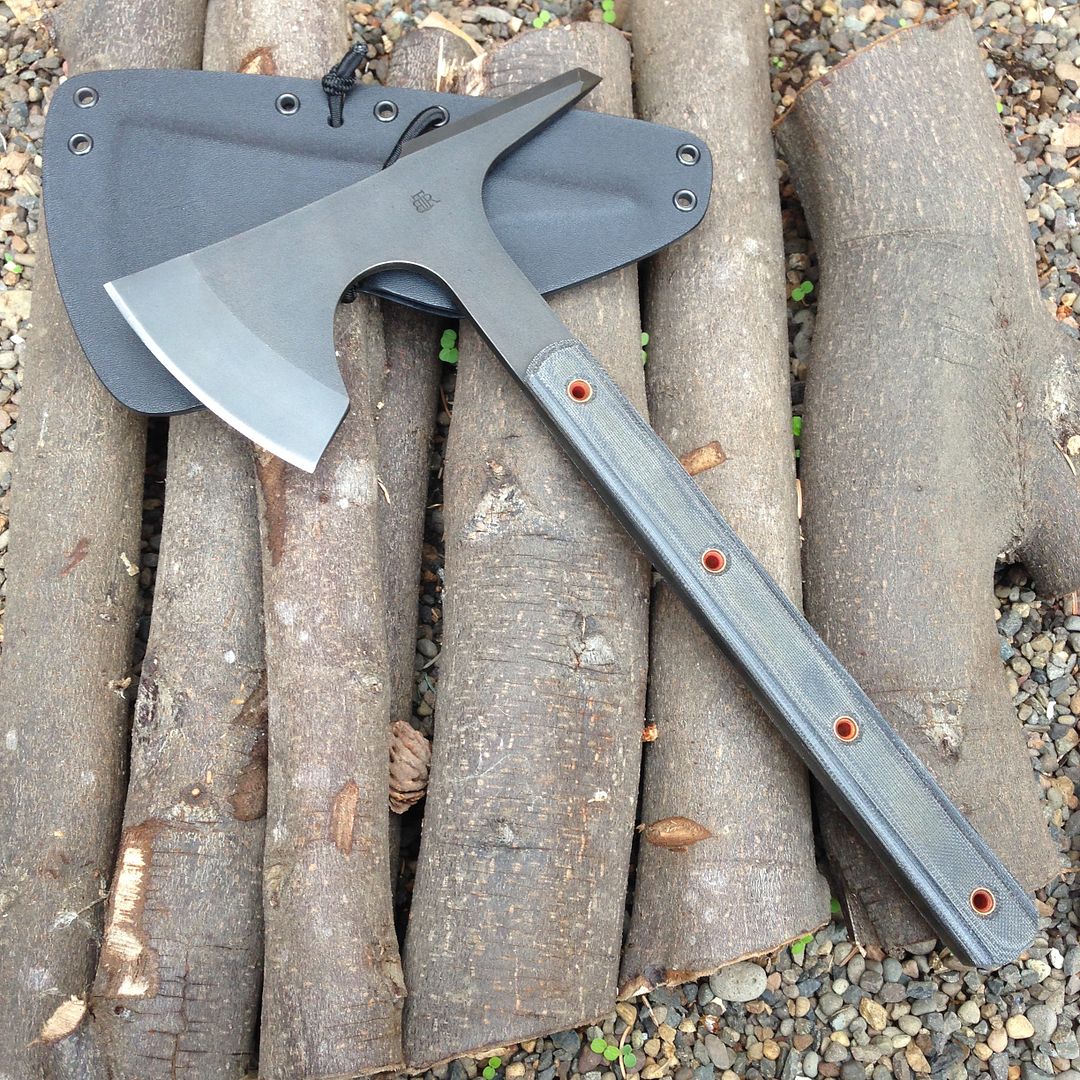

Hey guys thought I'd share some pics of hawks I have been working on recently.
Valkyrie hammer poles...

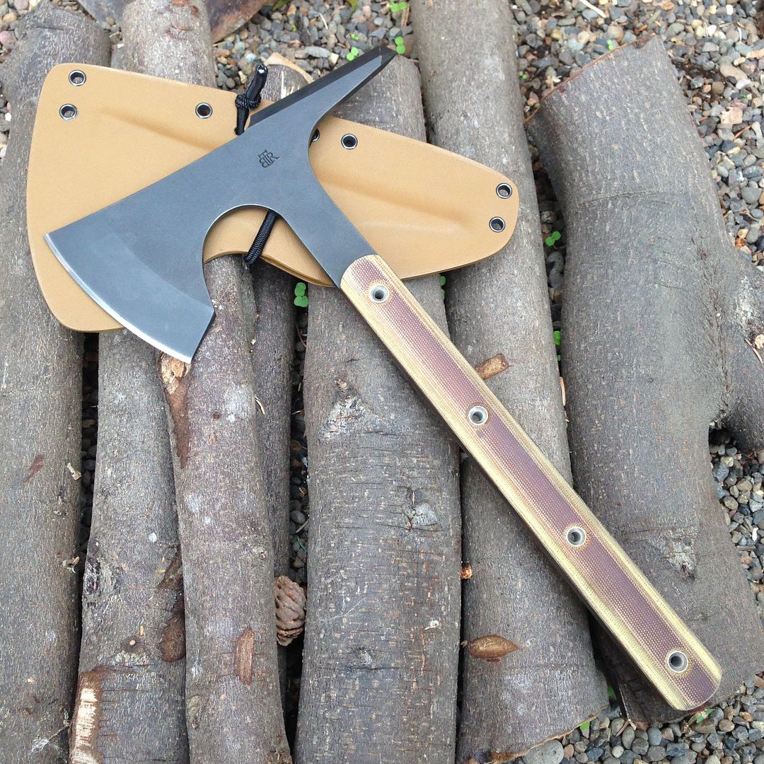

Huntsman...

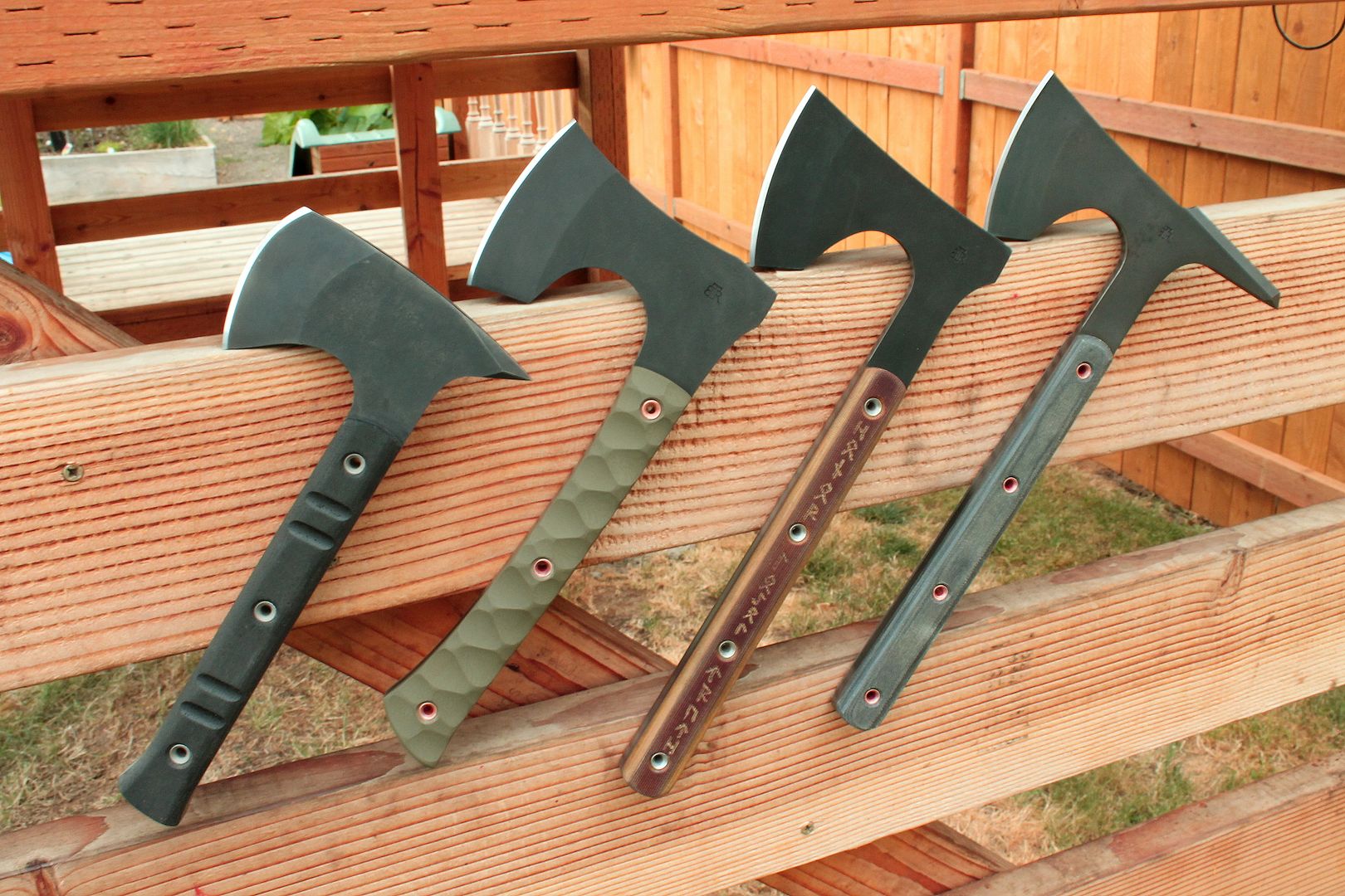

Rare group shot...Peregrine, Huntsman, Hammer pole and spike Valkyrie...

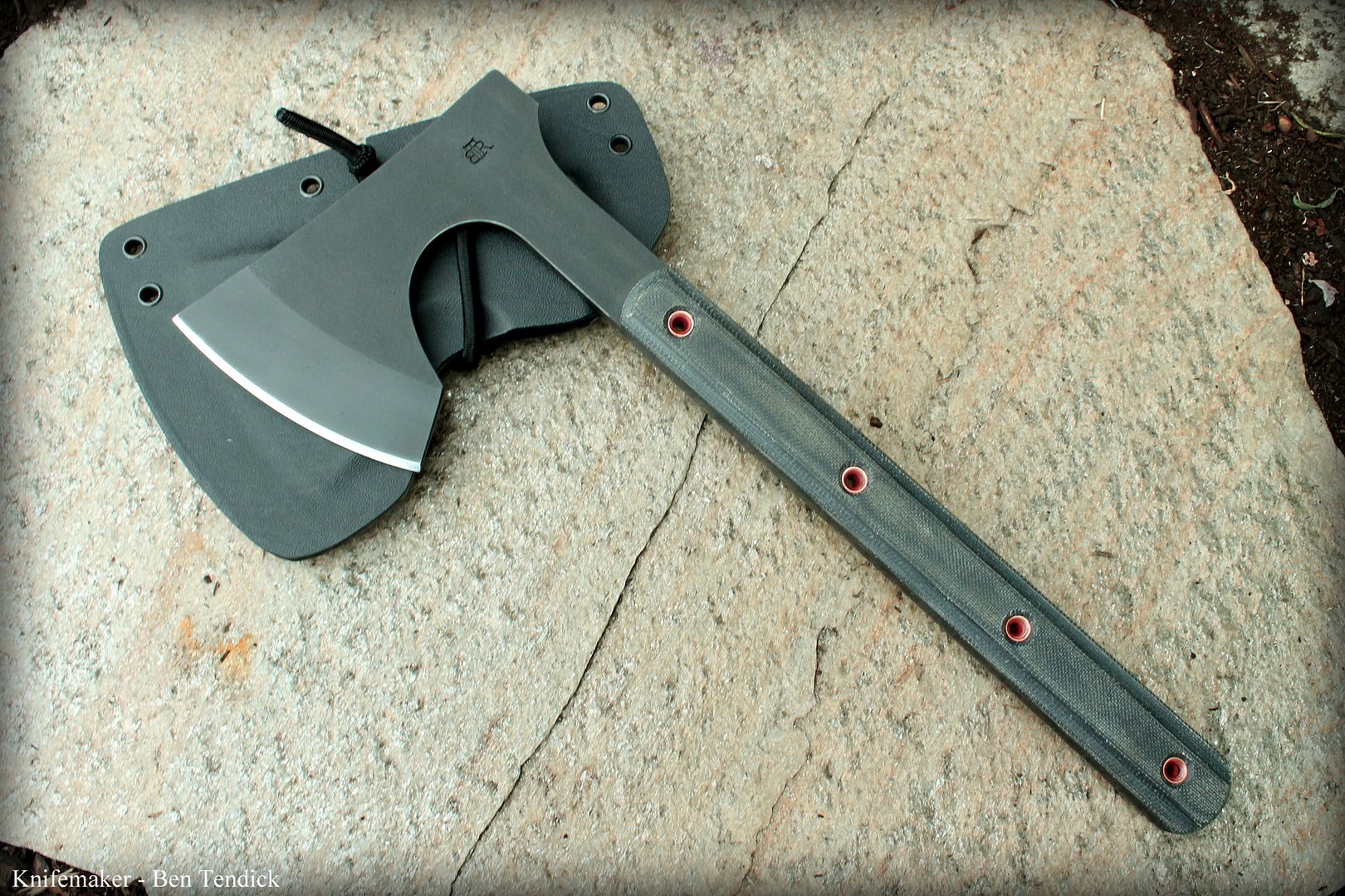

Just finished up a couple more of these and snapped some pics....

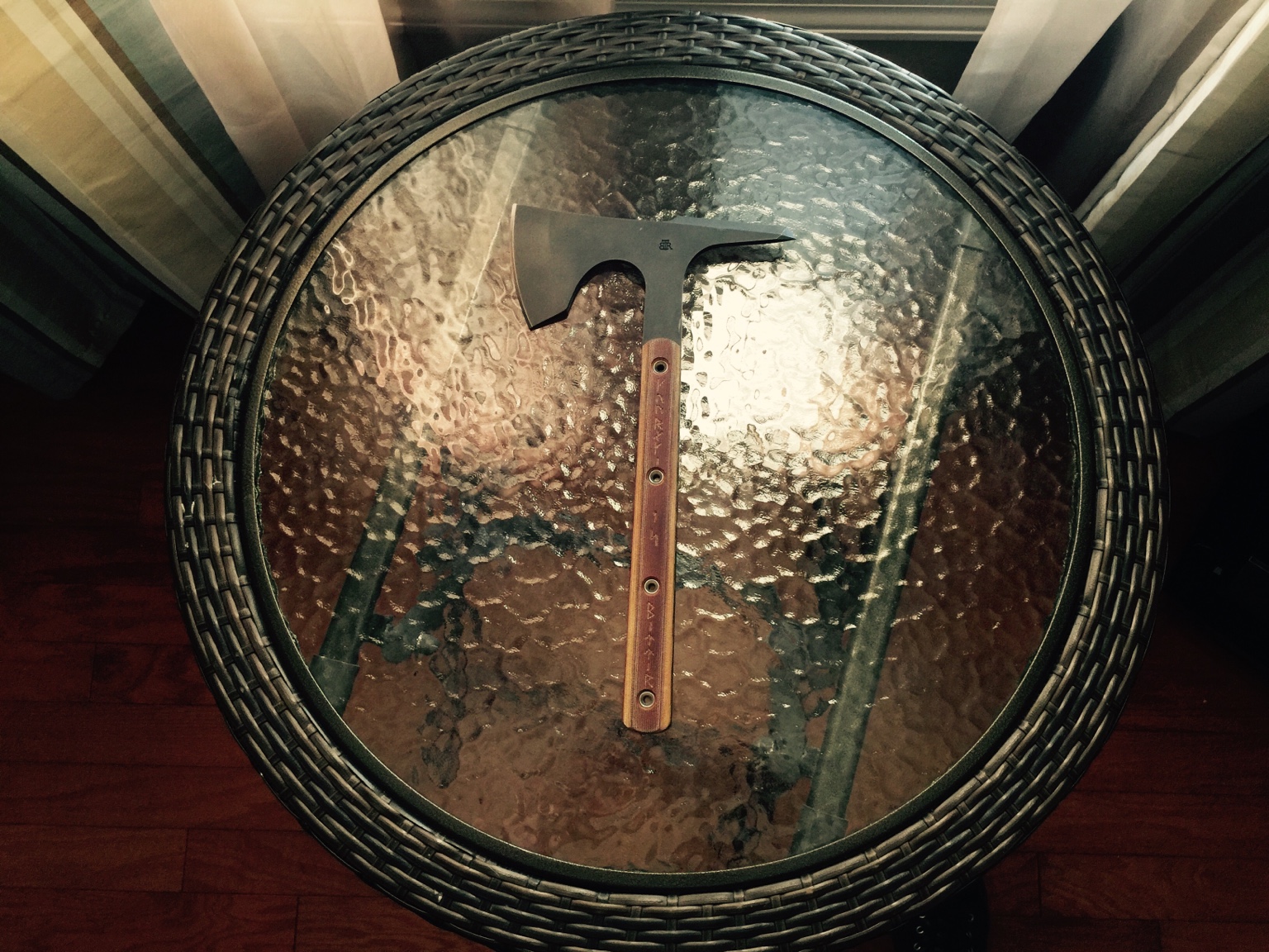

You know I am loving mine Ben! Still haven got her out in the wild though. Trying to figure a way to mout a shoulder sling so I can carry her that way!
In my opinion......a small extended prying application at the base of the handle would be absolutely perfect. Again......great design.
Thanks. I suppose I could leave a small potion of the tang exposed.
The spike works pretty well for prying I have found.

Ben I am loving the Hammer Pole. Very practical and well proportioned.:)
Can you tell me something about them........What steel you use, thickness, hardness, handle options etc......??
Thanks.
Steven
Hey Steven,
Steel is 1/4" 4140. They are 55rc at the edge and pole, I spring temper the tang into the head for extra toughness. Handle options are the gray tero tuf or Nat canvas micarta, with either SS or copper flared tubes. If you want to talk about prices, please feel free to email me.
