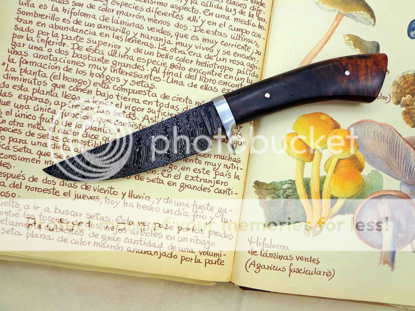

The infinite posibility of "drawing" with damascus never ceases to surprise me. I named this pattern Burning Bush.
Steels are 5160-15n20, phostatized.
420 ss guard, ironwood handle with german silver spacer and domed pins.
Although this piece of ironwood has some natural small cracks, it has a lot of activitly (poorly shown in the pictures) so I decided to use it anyway.
Hope you like it.

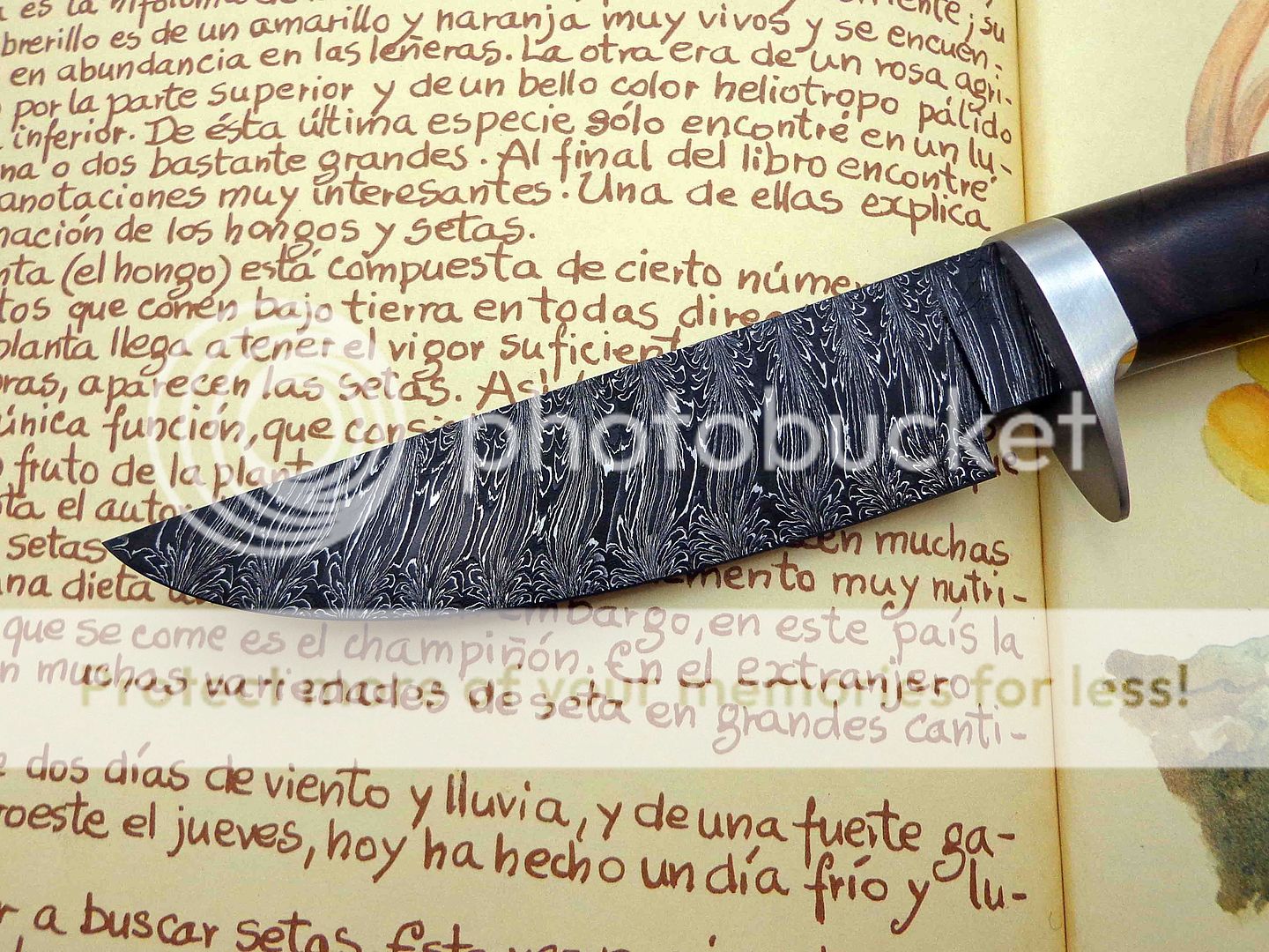

Can you reveal to us how you did the damascus pattern or is that a trade secret? I can usually figure it out, but this one has me stumped.
Thanks guys!
Travis, sure man: its a W that is cut lenghtwise and rewelded in the middle what use to be in the sides, thus making the points of the U face the outside instead of the inside. Got it?
After that is twisted quite tight, this one was a 1x1" bar when I twisted, flatened it very little and mill off most of it in each side.
