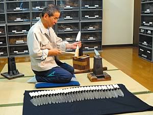

The Japanase have been doing handle burn-ins for ions and still practice this for their wa-handle installations.
The process is to first drill a hole slightly smaller than the tang and then to pre-burn in the slot to the desired tang's shape and size using a tang-like poker as seen in this picture...
Then the tang is positioned into a small furnace that heats it just enough to finish the burn in process. A couple of light taps on the base of the handle seats the tang tight and then the knife is put aside while the wood and tang cool.
After this they are very secure together and will need a fair bit of deliberate force to disengage from one another. Personally I'm not interested in this method of handle installation but it's proven very well suited for applications where a handle may eventually need replacement.
