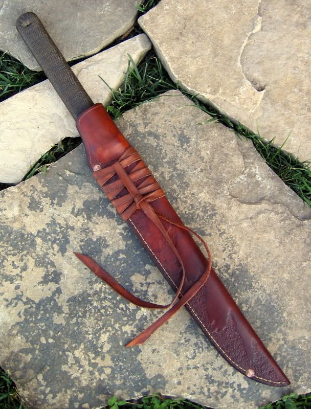

Hello,
Here is my Bush Waki. The balance point is directly infront of the handle. It is a very lively blade to whip around.... lots-o-fun!
1084 Material
21 3/4" OA
13 1/4" Blade
8 1/4" Handle
3/16" Spine
Handle is leather backed, hemp wrapped and epoxy soaked.
Sheath is 10oz hand stitched, riveted and wax dipped.
Thanks for looking.

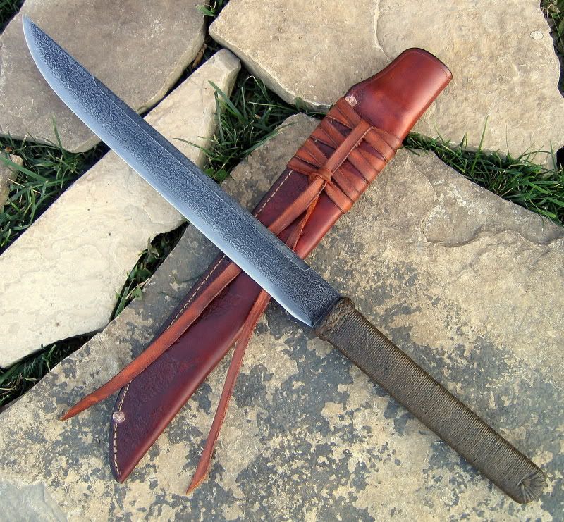

Someone in another thread asked about the back-cut on the spine....
The relief cut on the spine (or shinogi-ji, unless I'm using that term wrong) does not converge to a sharp edge. There is actually still 5/32" of spine flat. I use the relief to shift the ballance point of the blade to where I need it.... Right in front of the handle. It also looks really kewl.... Ha!

Very cool, as always. If I'm not mistaken, that geometry is called unokubi-zukuri — I'm not sure whether the false edge is called a shinogi-ji in that case (I think that term may only apply on shinogi-zukuri geometry, but I could be wrong).

Very sweet blade and sheath. That's also a very interesting finish on the blade, gives it a great look and feel.
Great knife!
