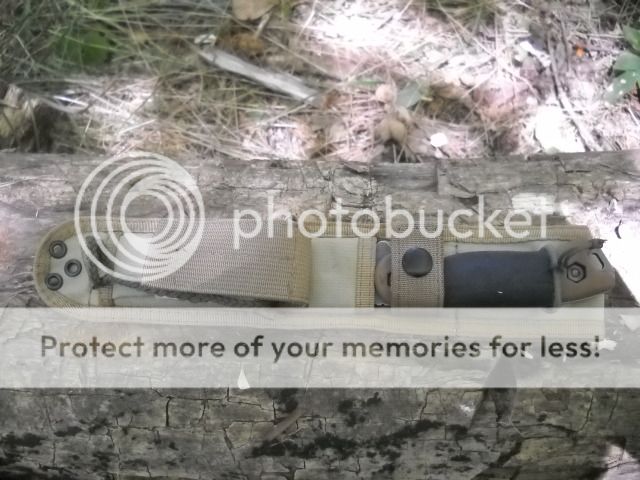

I decide to do a quick post on what I did to my BK-17 to make it more used friendly for me.
[video=youtube;NM8sNLcJPWc]http://www.youtube.com/watch?v=NM8sNLcJPWc[/video]

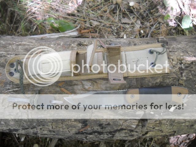

I removed one of the snaps and added a little bungee cord.
I like the pouch on the front. It is a great place to keep a firesteel. I added a piece of small diameter inner tube on the handle to make it a little gripier.

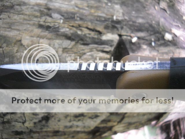

I filed the spine flat so it will strike a fire steel very aggressively.

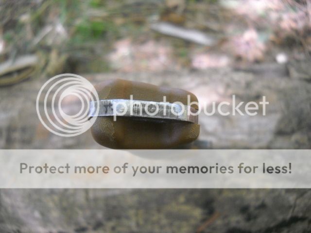

I also filed the pommel round. This lets me comfortably use my palm to hammer on the knife.

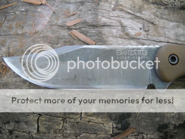

I removed the black coating with paint stripper. I also filed the factory secondary bevel back to the angle of the original grind.
So far I have only used it hard for a couple of days but it is holding up well.

I do have a question, however, regarding the sharpening of the spine...
Sharp spines for a firesteel strike me (har har) as being optimized for the less-frequent use. I tend to use my thumbs on the spine a lot, both knife and non-knife hand. Sharp spines are uncomfortable at best, and a cutting hazard at worst. Since you went to the trouble of paracording your firesteel into the pouch (GREAT idea), why not paracord a dedicated striker along with it? That way you either lose neither or both, and you can keep the spine of the knife finger-friendly. I realize spine sharpening is a common mod, but I bring it up here because you so neatly solved the firesteel retention problem at the same time.

Good question, here is my rational. I have never had an issue with my thumb being uncomfortable or had any injuries from putting a 90 degree angle on the spine of my knives. As far as carrying an extra striker, I have never had much love for the manufactured scrapers. I prefer being able to have a positive full grip when striking a fire steel.This is especially true when you are wet, tired, and your fingers are cold. For natural and marginal tinders I have found that it takes a large hot spark to get them to ignite. Just my opinion though.
