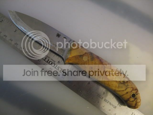

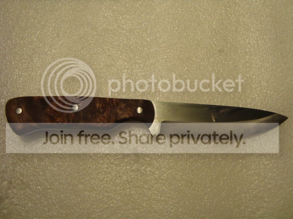

I have made 3 knives I would consider Bushcraft knives all roughly the same size, all 3/16" O-1. None of tem are big heavy duty knives but they aren't light weights either
A full flat grind, for the guy that needs to spread his PB
A convex that I made for myself

In general the knives tied to "bushcraft" tend to be about 4-5 inch long blades with a drop or spear point and not to much belly. The knives shown above are some good looking examples.
