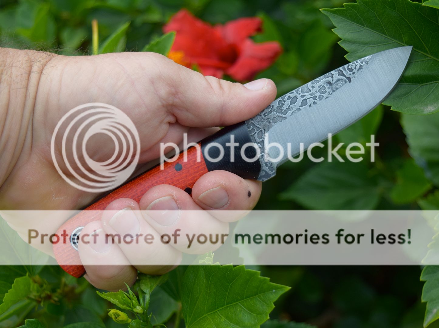

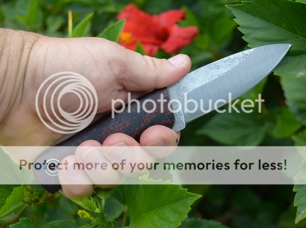

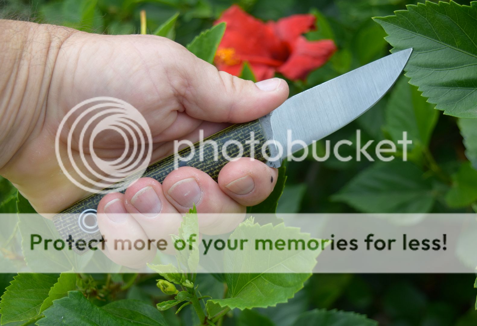

I tried to use the same grip for each of the following in hand photos. I have also included the Monarch for reference.
So if handle length does not explain the difference in feel, what does? I agree with Jim’s astute observation that, “the curve at the bottom of the BC Jr. cheats me out of about a half finger’s width.” Actually, it is probably more appropriate to say the “curves” on the bottom of the handle. The curves form an “m” shape contour that helps lock in your grip. This “m” shape on the BC Jr. is taller and more distinct feeling than it is on the Patch. Another key factor is how far back the center of the forward curve is located on the handle since that is where the index finger will naturally fit.

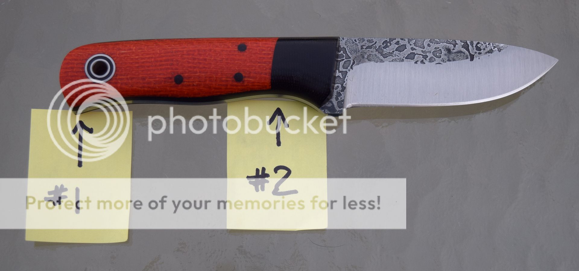

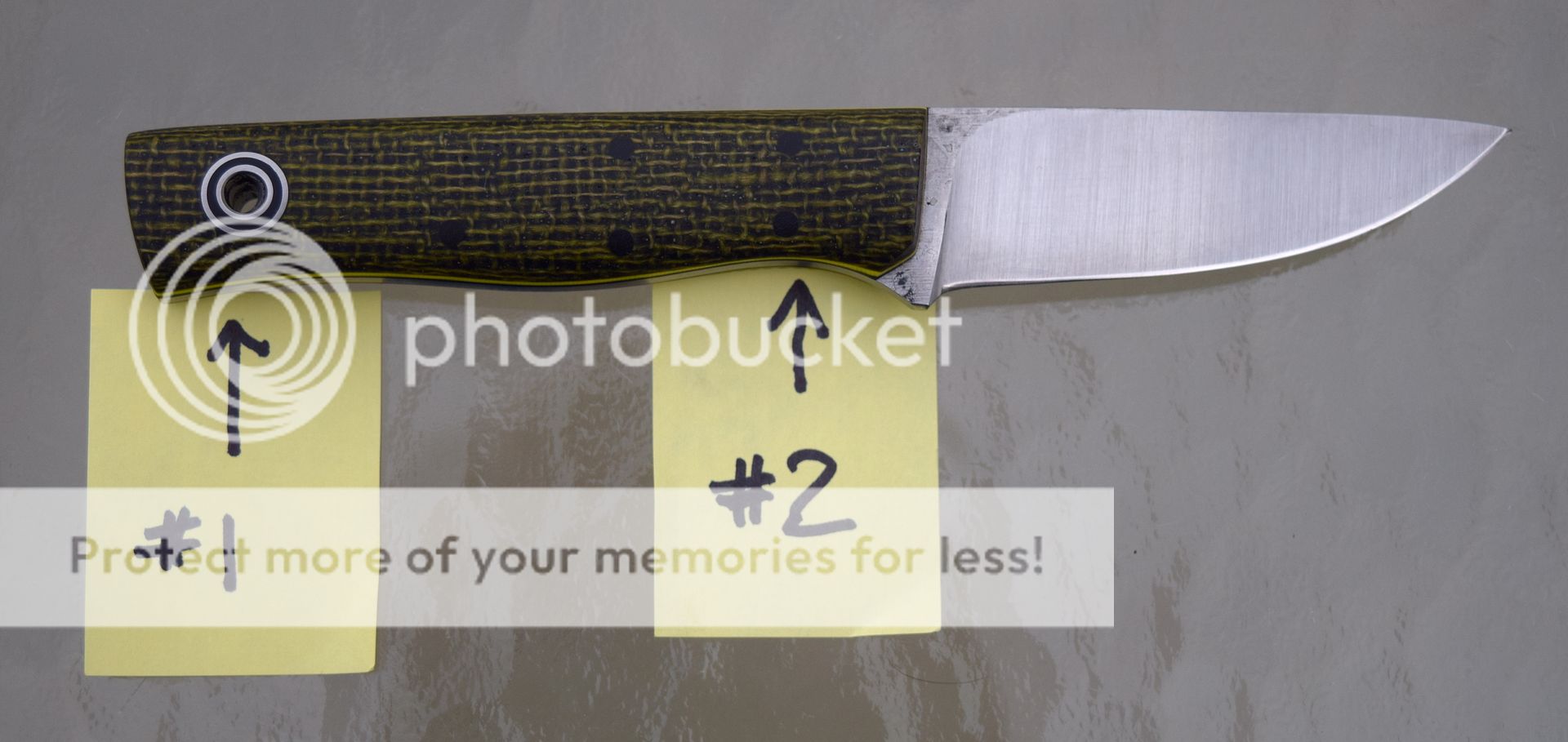

Look at the following photos to see what I am talking about. Arrow #1 is positioned at the back end of the “m” curves. Arrow #2 is positioned at the center of the forward curve. First up is the BC Jr.
Without moving the post-it notes, I placed the Patch in the same position with Arrow #2 centered on the forward curve. The result is that the back end of the “m” shape sits about .350” further back on the Patch. There is your half a finger’s width difference Jim.
I find the shallower and wider “m” shape curves on the Patch and Monarch to be more forgiving and comfortable for me in various grips that the taller and narrower ones on the BC Jr. I don’t have a Handyman yet, but that model looks very promising in this regard.

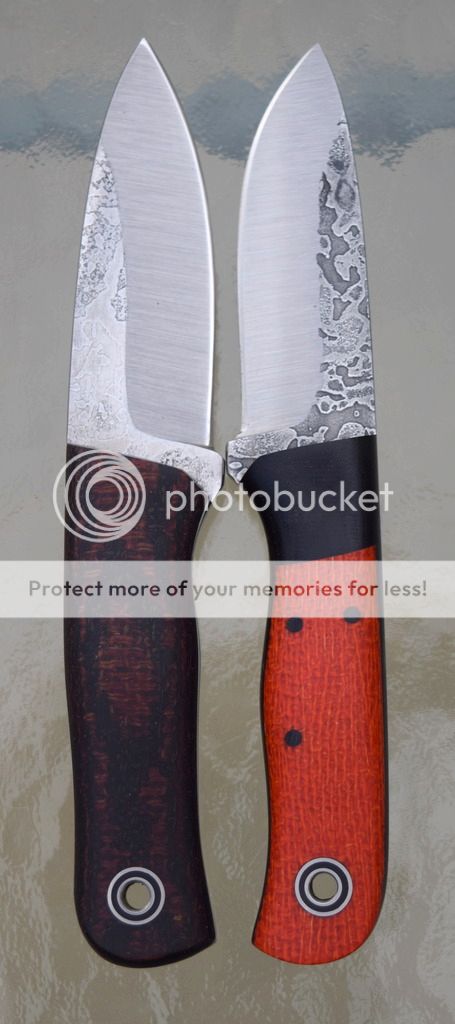

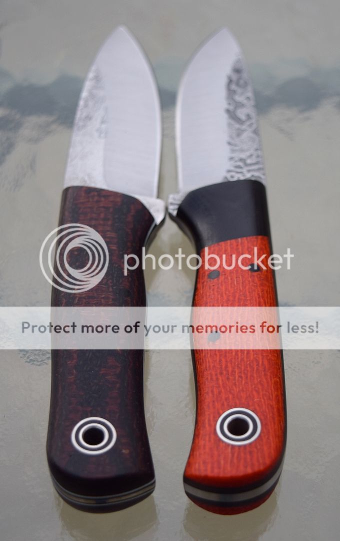

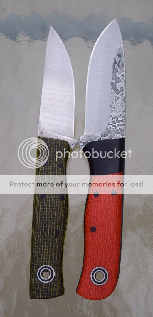

Here are some side by side photos to show the differences in the handle curves.
