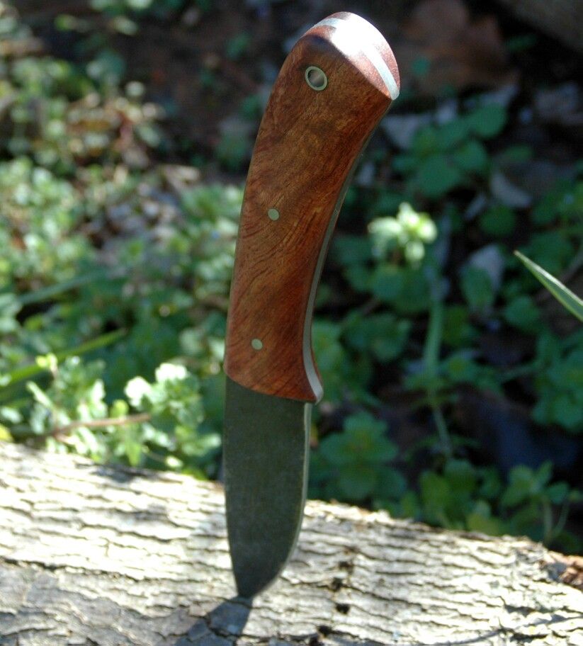

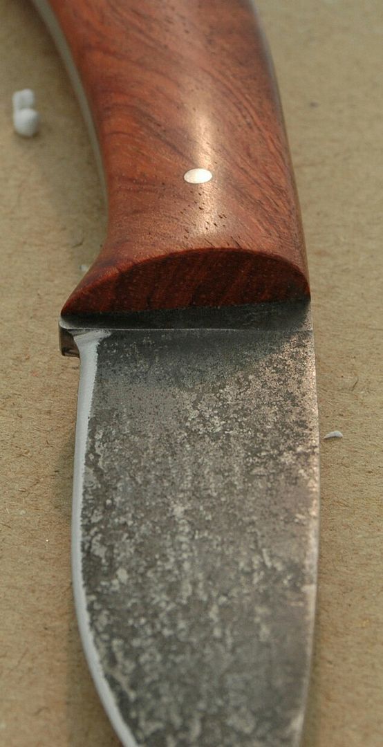

First up is a Bushpal
Aldos 1095 5/32" full convex grind
4 1/2 handle 3 1/2 blade
Bubinga Burl Scales contoured
Antique finish
Custom leather sheath
150.00 shipped

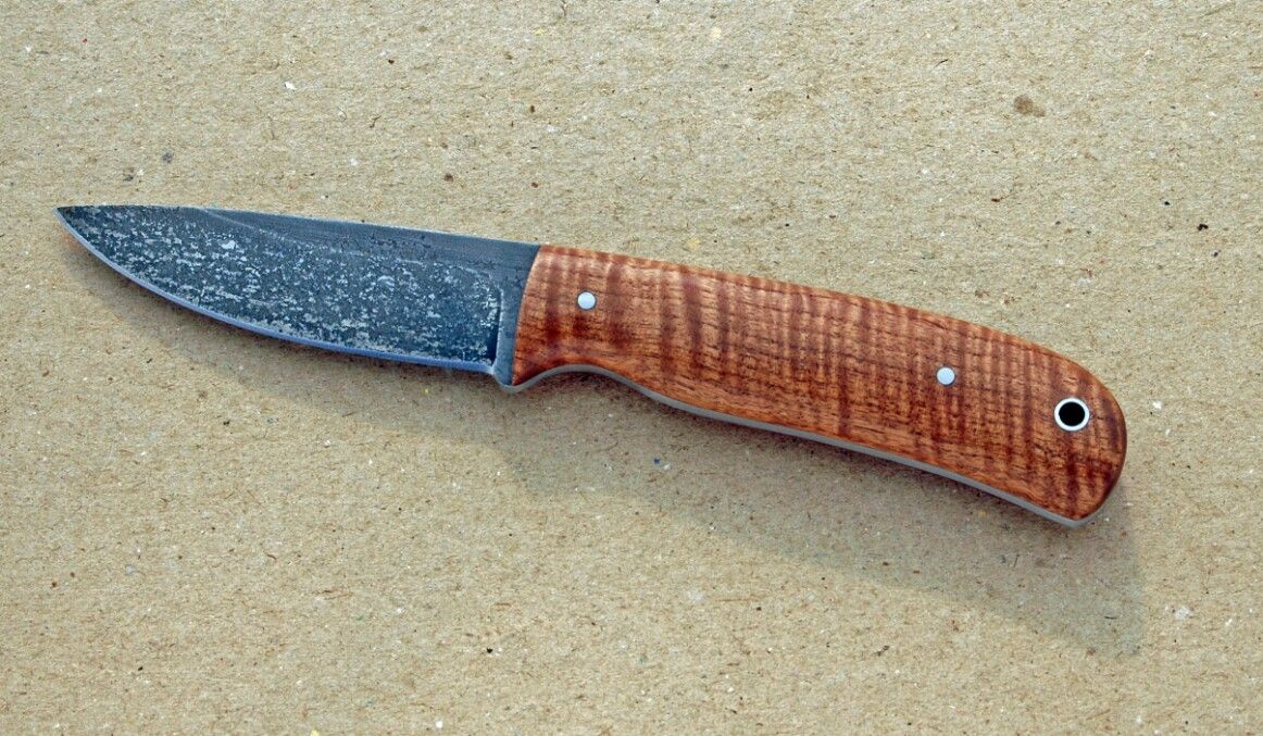

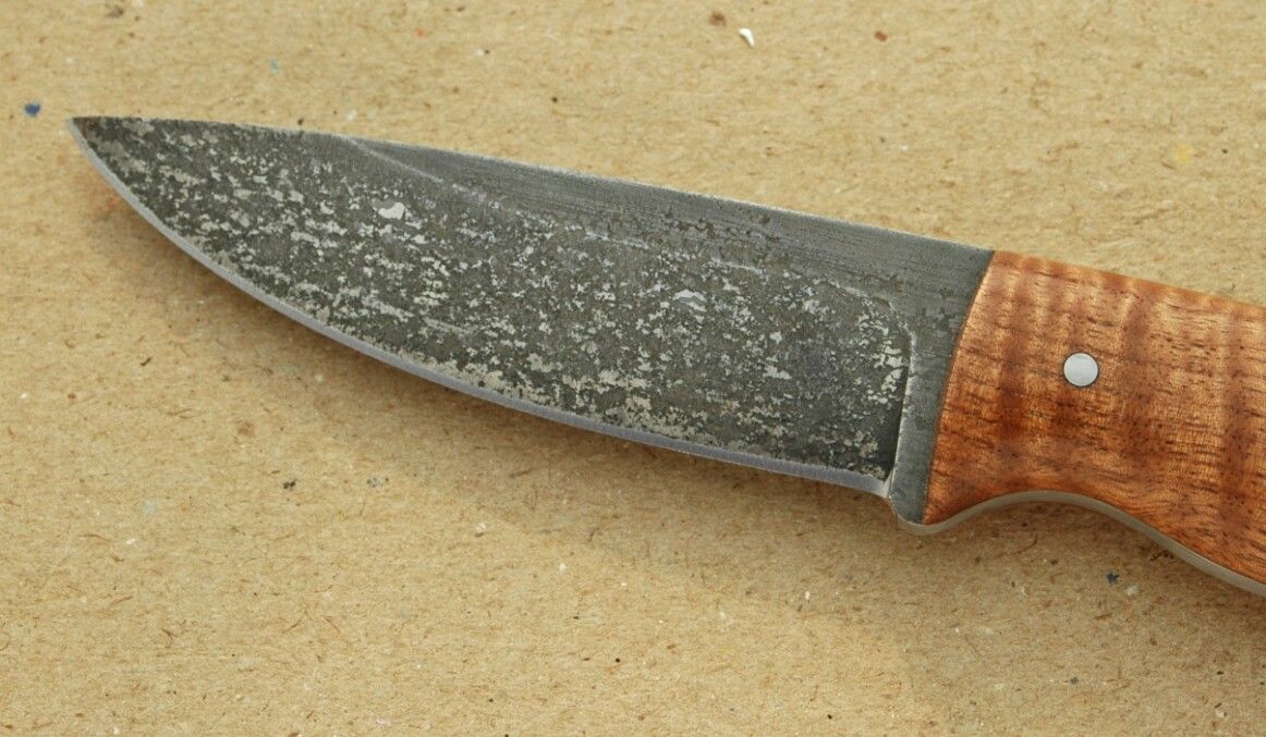

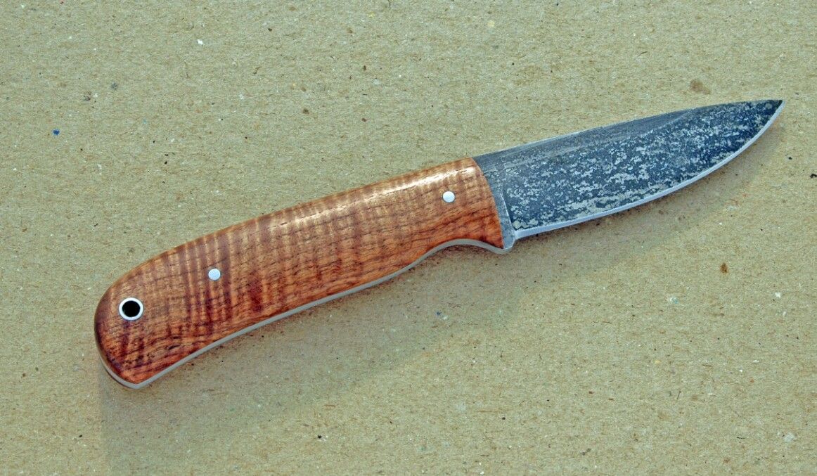

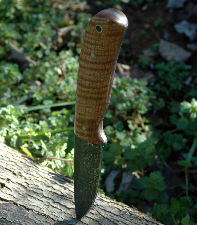

Next up is The Pointer
Aldos 1095 5/32" saber convex grind
Curly Satinwood scales contoured
Antique finish
150.00 shipped

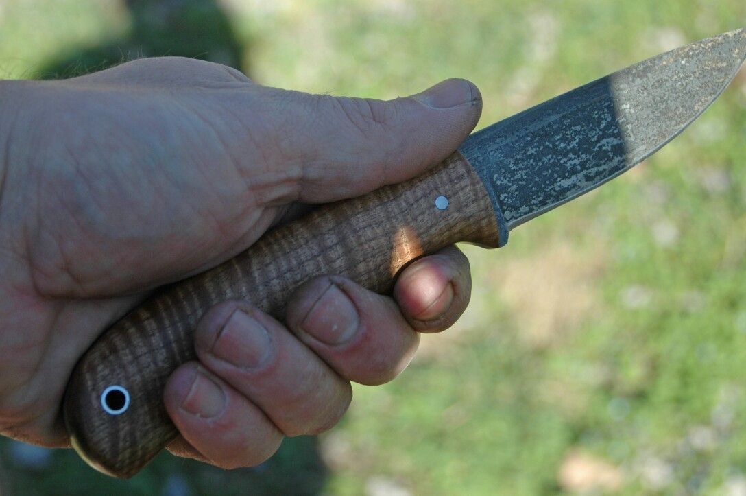

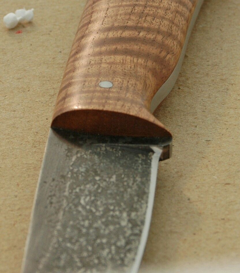

A couple of the contours. Thats just wax on the spine, it will come off

That Bushpal is really sweet, especially the contours in the handle. But I'm really digging the profile of that Pointer. With that first finger notch I think it would be a great fish and fowl knife for working under slippery conditions. Are these going to be regular patterns in your line? If so we are going to need to talk about one with a synthetic handle material later. My brother and nephew are both avid hunters and fishermen.

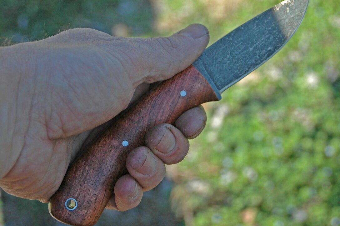

I got this Bushpal today. You were right, the photos do not do the bubinga scales any justice. They are beautiful! The knife was indeed shaving sharp with a nicely polished edge. It did not want to slice newsprint, but that is probably due to edge geometry as this was intended to be a hard use knife. Your work is really beautiful!

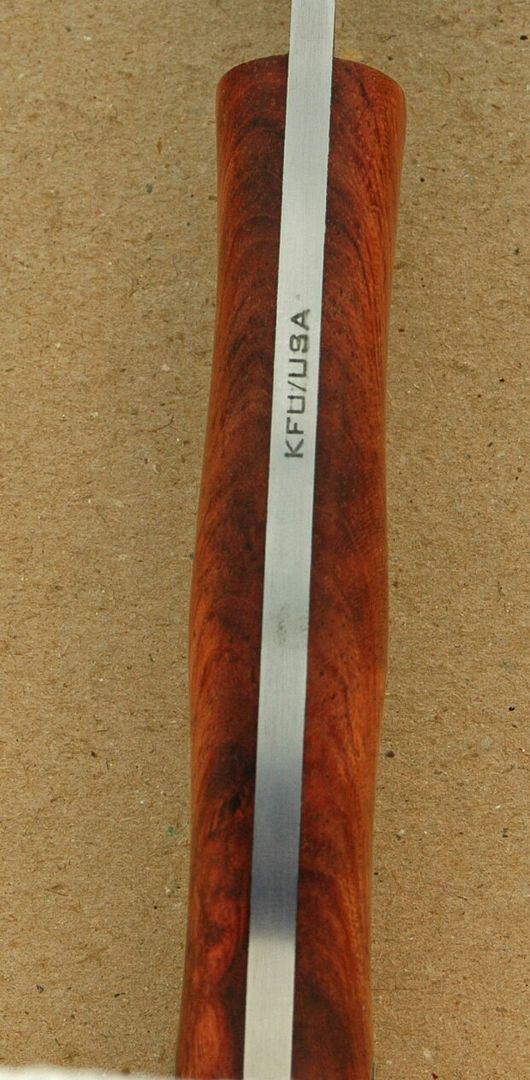

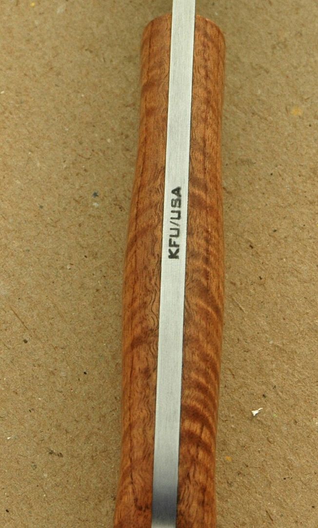

How did you add your mark on the tang? It seems completely smooth.
I have a couple more notes on this knife. The handle ergonomics are just about perfect. The contours are great, and it fits a large hand well. The balance is on the second finger, making the knife feel a little handle-heavy. You may want to consider drilling out some material in the handle to get the balance over the index finger and see how that compares. Personally, I would prefer the balance a little more forward.

I etch my makers mark on
