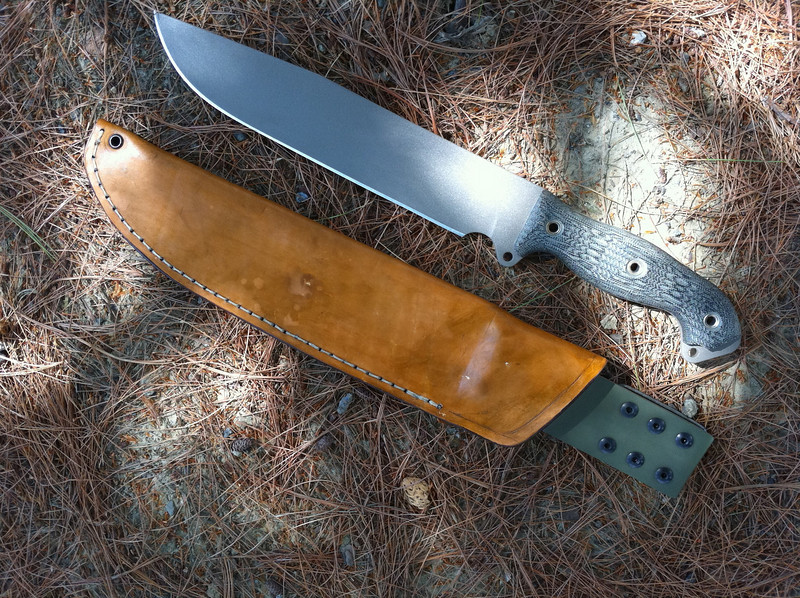

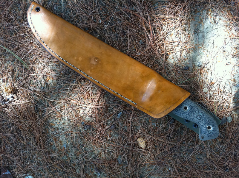

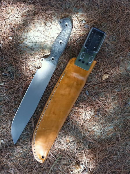

Full top grain cowhide leather body, Concealex tab holding a Bianchi clip for belt carry:
Looks great! I do somewhat the same thing, but I use holster clips. For mobility, I punch a hole and attach the clip with a Chicago screw. This way, the knife can swing out of the way much like a dangler-type sheath.;)
Thank you!
@Tom Kanik, I've been toying around with a dangler-type setup, but I'm still in the concept stage. :)
Even, straight stitching. Edges look good. Well done! I like it. :)
Thank you, leatherman! That means a lot to me. :)
You are very welcome. :) And to add, Saddle Tan dye is a rip roaring pain in the rear end to deal with eh? I cringe when I hear that color come up. You've got very little mottling for a large sheath, good work! What do you use to apply the dye and which type did you use?
Thank you! Tandy Leather Eco-Flo Hi-Lite Stain (Chestnut Tan). I used a wool dauber.
