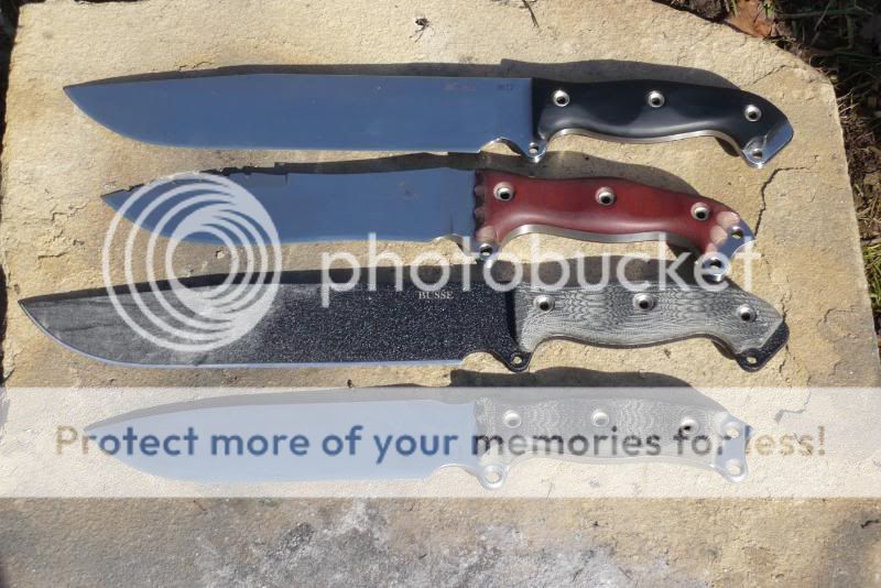

I thought I would compare the BWM LE and the BWM CG to my FSH Variant and my NMSFNO respectively .... as overall weight wise these knives are the same. Just to see what the differences were ....
Here are the knives ....
The BWM LE has had the grips smoothed and the edge convexed .... the FSH has a new convexed adge as well .... and the NMSFNO is fully convexed. For comparison I left the BWM CG in stock form just as received from the factory.

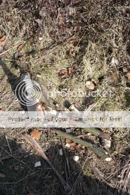

First task was doing some limb sectioning .... my overall test being a simple comparison of using the knives for fire preperation tasks.
I started off with the BWMCG as I was keen to see how this would do and wanted to use it as a bench mark in "factory spec" ....
It easily breezed through this .... the factory edge was nice and sharp and the only thing I noticed was that the grips did'nt feel as smooth as my grips normally do ... but they were'nt uncomfortable .... the grip design on this knife is infact one of the most comfortable I have used. I will lightly sand down the grips but that is just a personal preference for me .... I like them like that and over prolonged use it is a bonus.

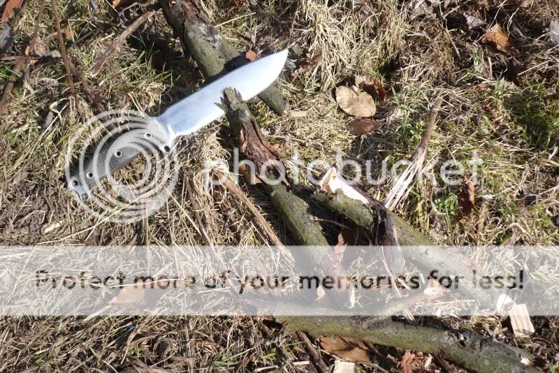

I followed this up with whittling the limbs to remove the dead wet bark ....
I used a choked grip and light easy pressure strokes .... the type of stroke where it requires no effort and you are just going for speed to get the job done .... as you would if you needed to get a fire ready asap .... the stock factory edge of the BWMCG was easily able to remove the bark but missed out on the level of sharpness where the knife can easily take off that top layer of wet wood and go down to the "white" .... the NMSFNO in fairness is a lot sharper ... like a razor really .... and it managed this no problem. I tried to keep the angles consistant and with a little more force the BWMCG would go down to the white but it was not quite as quick when done like that.
Just a small point and obviously easily remedied with a bit of sharpening .... but the factory edge was still working well .... the main difference I noticed on this task is what a joy the NM rounded spine and choil are on the NMSFNO for choked grip work. So comfortable ... and you get nice easy control on the NMSFNO despite the blade depth being quite deep. The same is true for me when using the NMFBM .... I like this depth on a knife .... they seem a lot more useful on delicate work than the depth of my FBM Satin Flat Grind .... but the BWM is also very similar on depth and it too has the same aspect of control. The thinner stock for the blade though does make for a sharper pressure edge on the finger choil and to a lesser extent is noticed on the spine. When I strip and convex the BWMCG I might take a bit of sand paper to the choil and round off the finger groove .... if I needed to carve a few tent pegs or do some fig4 sticks for snares .... this little aspect to the knife would make a lot of difference on comfort.

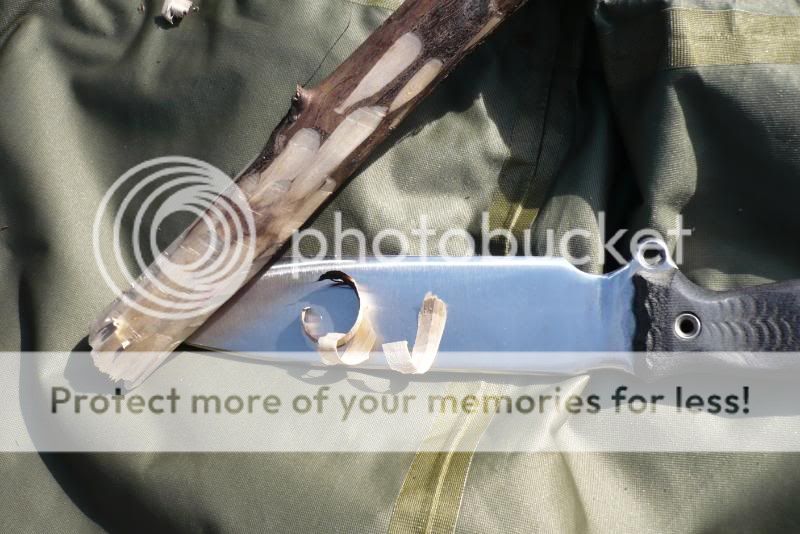

Next task was whittling away on the sticks to get some shavings for tinder ...
Again for a factory edge the BWMCG was able to give some nice tight curls ...
nothing wrong with the standard edge on this one :thumbup:
The NMSFNO was able to get longer and thinner shavings with the edge being sharper but both were well up to the task ...
The main thing as said above is the comfort of the NM treatment for work like this .... makes the job a pleasure .... and the smaller length of the knife gave more control.

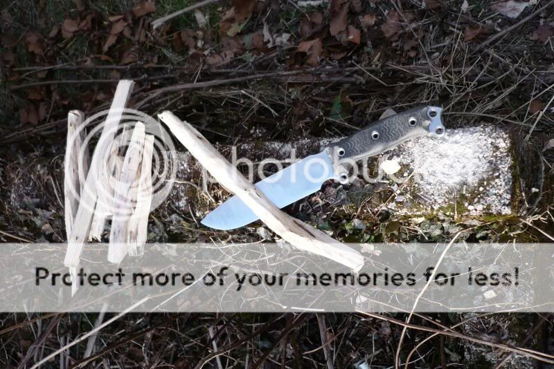

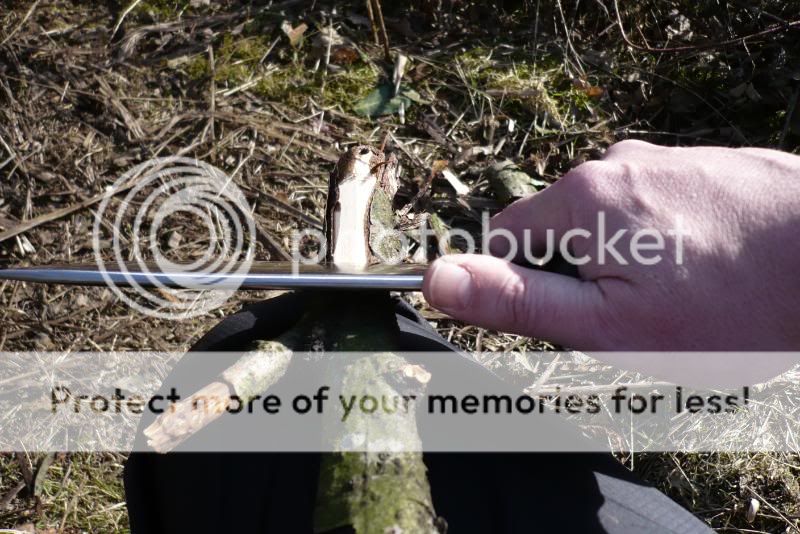

Next up was a bit of battoning .....
I tend not to use a baton so really I should call it "splitting" .... I just bang the sticks with the knife in place on a stone .... you can see the well worn stone breeze block in the pic ... the NMSFNO found this easy and was very able to give a controlled "split and twist" .... even on the finer quartering of sticks to make the most of the dry inner wood .... that is probably down to the sharper edge as it is easy to push cut into the sticks to get started...
The Bushwacker was also in it's element here ....
The thinner blade makes it ideal for the smaller delicate stuff and once stripped and a bit sharper I think this knife would easily find it's "forte" at this sort of task .... splitting sticks with this knife is something you could do on "piece work" ... it is very fast :thumbup:
