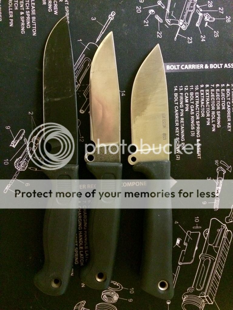

Love the Basic 5! Here's one next to a Basic 7.
The B5 is very comfortable and secure in the hand. It has a beefy blade at 1/4" thick. IMO, the perfect defense knife. :thumbup:
The Basic 5 & 7 are two of my all-time favorite Busse knives!
Bonus points to the person who names the knife in the middle between the B5 and B4. ;)
Had to dig a bit for that,,, called Euro 4 also I believe.
