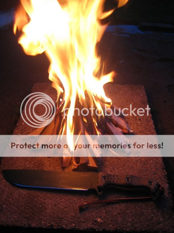

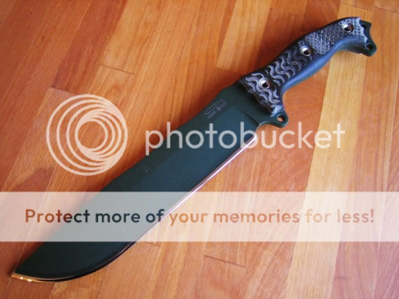

I bought this FFFBM from Justabuyer at the end of 2007 and it looked like this after I had reprofiled the edge.

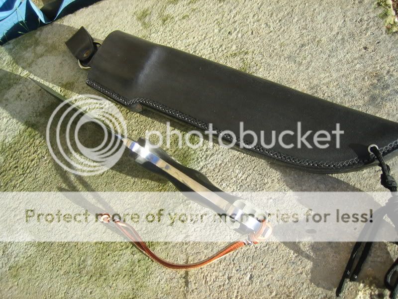

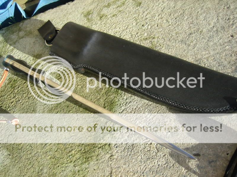

I did a bit more work on it... just polishing the spine and sanding the handle to get a perfect fit for my own hand.
I also took the edge a bit thinner... although it is still heavy duty.

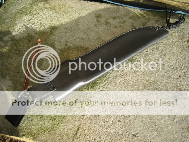

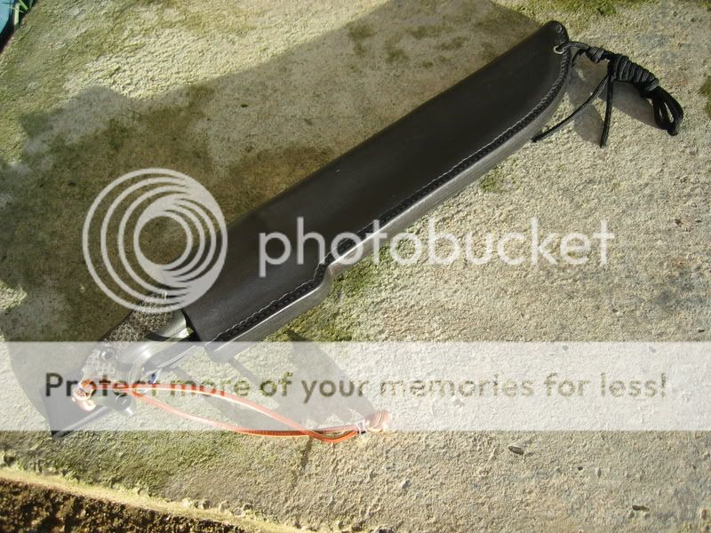

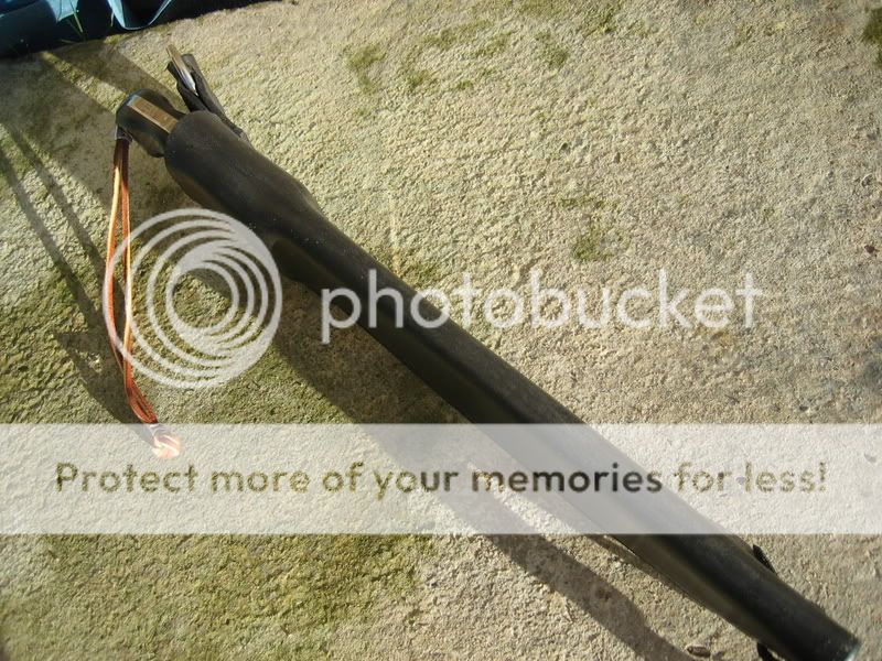

I also made a sheath for it.... I don't really enjoy making sheaths...but... I wanted this one to be lightweight and as thin as possible.
It works really well.

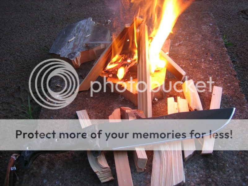

I checked it's chopping ability on some wet 1.5" X 6" pine planks.
It ate them with ease...so I checked it's splitting ability.
And it breezed through that too.

How do you polish the spine and leave the coating on the sides intact??
Thanks Crafft. :)
I cut the coating off with a dremel sanding drum... just the coating... just till I could see the steel... the green coating on this is very tough.
Then after that..I just use sandpaper and my thumb... I start at 180 and when I have an even finish with that I move on to 600 then finally 1000.
